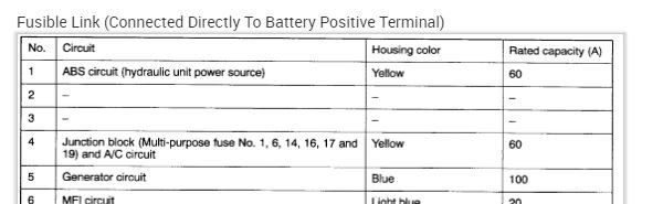

Next, on my schematics I see a 100 amp fusible link for the alternator. See picture 1 Is that what is being replaced? If it is, has anyone checked the alternator itself for a short?
If you lose power from the alternator once the vehicle is running (blown fusible link) there will be electrical issues until the battery is run dead.
