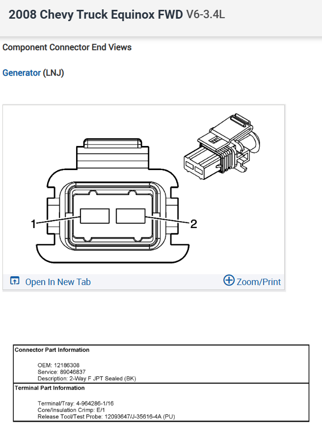

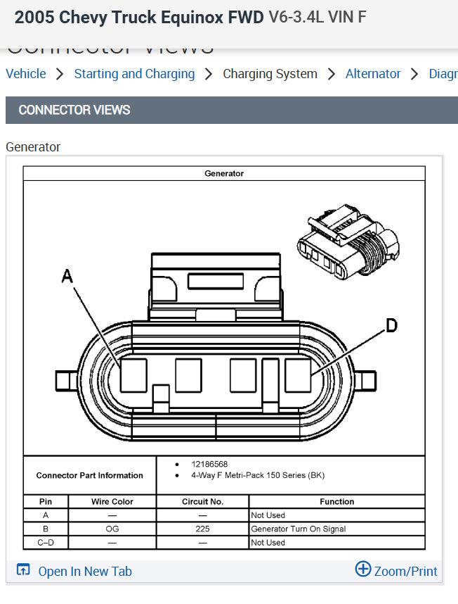

Hi Alex,
It looks like there are different plugs, you should be able to get a new plug and wire it in or get the correct alternator. Here are the alternator charge plug pinouts. Check out the images (below). Please let us know what happens.

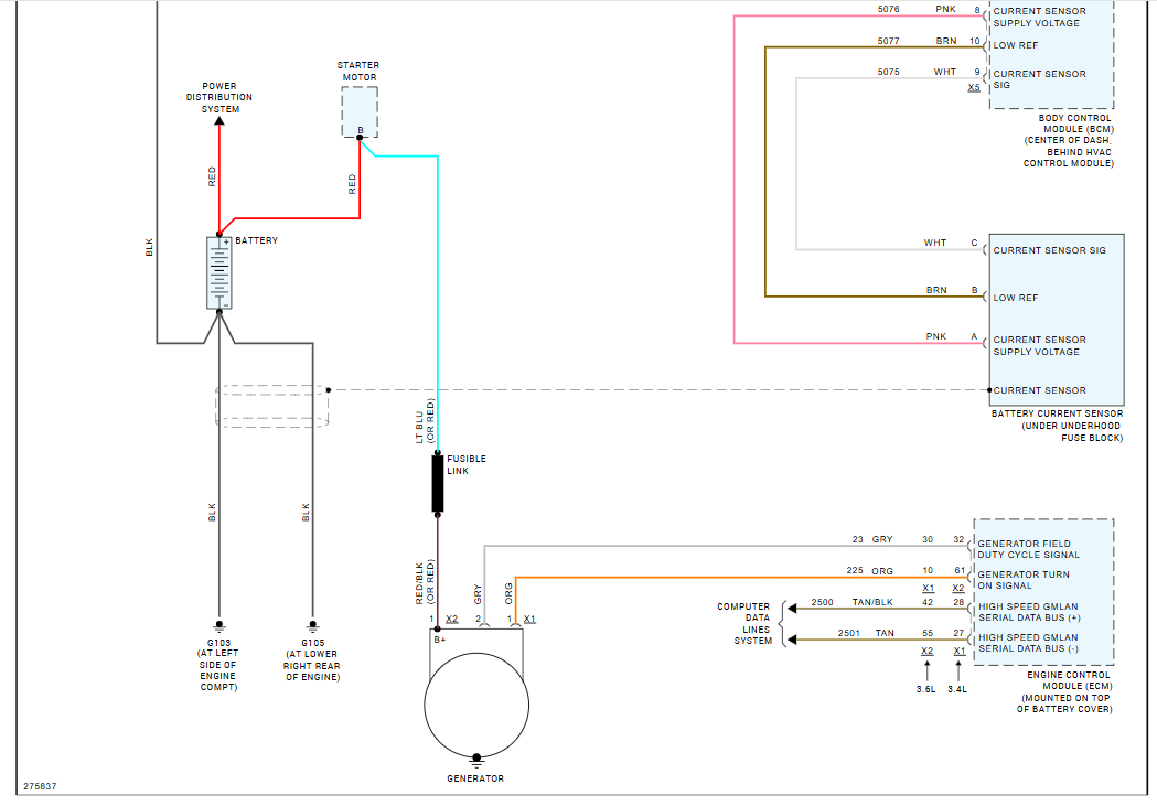

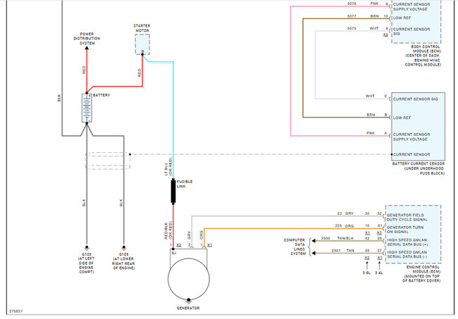

Okay, so would I put the one wire from the A,B,C,B connector Pinout into pin A or pin B in the other connector? The A,B,C,D single wire connector is on the vehicle and would be putting the wire into A/B connector which would plug into the alternator? Which pin is the generator turn on pin for 2008 alternator?
Jan 24, 2025 at 1:04 PM
Here are the alternator wiring diagrams so you can see how the wires go. Check out the images (below). Please let us know what happens.
