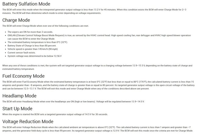

Hello, the charging system for more modern vehicles, even one that's already 10 years old, have a pretty accurate method for charging and also do have different modes of charging depending on ambient outside temperatures, how much current is actually being used at the time, and some other criteria the Body Control module looks at to determine the duty cycle of the alternator, there is a Voltage reduction mode that will go down to even 12.9-volts, this all puts less load on the alternator at certain times. 12.5v is a little on the low side and that might be because this is an aftermarket alternator and not am OEM. I will post the operations of the charging system here for you, but there is a current sensor on the negative cable near the battery that should be plugged into a 3-wire connector that goes into the wiring harness, is the connector missing completely?
But the charging system has a bunch of different modes it will enter depending on different criteria and electrical loads, voltages are also much different than the old days where we would see 12.6-8v and think something was wrong. The BCM can actually set codes and store them for the current sensor/charging system if there's something wrong with it. Everything is monitored through the vehicles networks now; you can get a full system scan of the vehicle somewhere and see if any codes are stored in other modules besides the engine computer. But installing an aftermarket alternator is risky, when it comes to important electrical components going with the OEM is always best. Much more critical than brake pads for example. That might be why he's seeing it drop down to 12.5v, have him try turning on the head lights when it goes that low and see if the voltage level increases, putting an electrical load on it should cause it to react and up the charging voltage. Let me get some operating info here for you though.

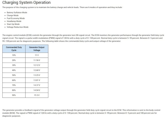

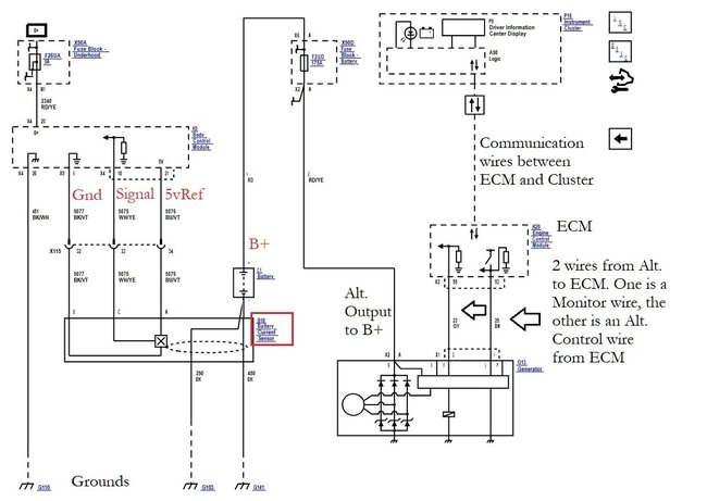

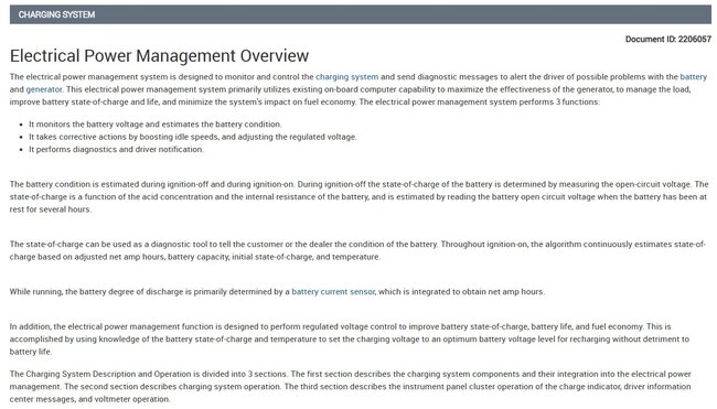

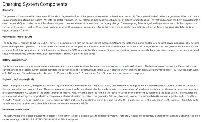

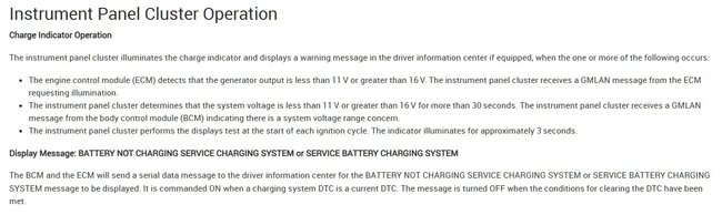

This is the Charging system operations and service info, it shows the different modes of operations depending on certain conditions. I added the OEM Charging system wiring diagram to show the Current Sensor wires. It works on a 5volt reference feed like many other 3 wire sensors. There might be a connector for it somewhere there that either may have fallen down or was wrapped up in the harness, although I'm not sure why anyone would do that. Does this vehicle have Dual batteries by chance? Some of these Suburban's come with two battery setups.

The Current Sensor is plugged into the negative cable. The vehicle only has one battery, although there is another battery box on the opposite side of the engine compartment.

Please give us your thoughts on what we tested. I read the system description you provided and it is indeed a sophisticated system.

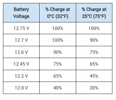

Just looking through service info, they really have this battery in a tight location. Being under the fuse block. 15volts is not unheard of these days, as long as it stabilized like you noticed. I agree that a multimeter won't catch the lowest voltage reading, 12.85volts at roughly 75f outside temp is a 100% charged battery, (the service spec is actually 12.75v for a 100%), This is the Battery voltage chart from service info. Granted sometimes a battery can be damaged if its fully discharged, but it doesn't sound like you're having any real issues with the battery itself, you may just be seeing that variation due to it being an aftermarket alternator. With pretty much every electrical load being on, and this alternator is below the amperage rating of the OEM, that's most likely the cause of the difference he's seeing.

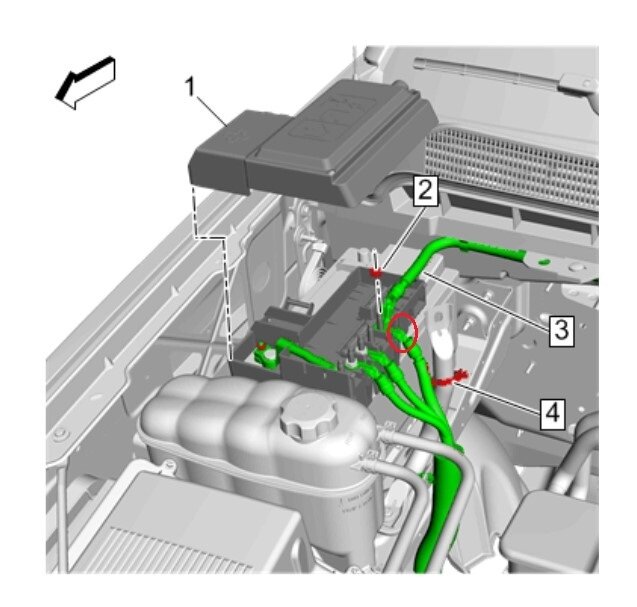

Check these main power cables as well for any green corrosion down inside the connectors where they are crimped (diagram 2). Once corrosion starts, it doesn't stop, it's like gangrene, it just travels down inside the wiring insulation. Just things to keep an eye out for.
