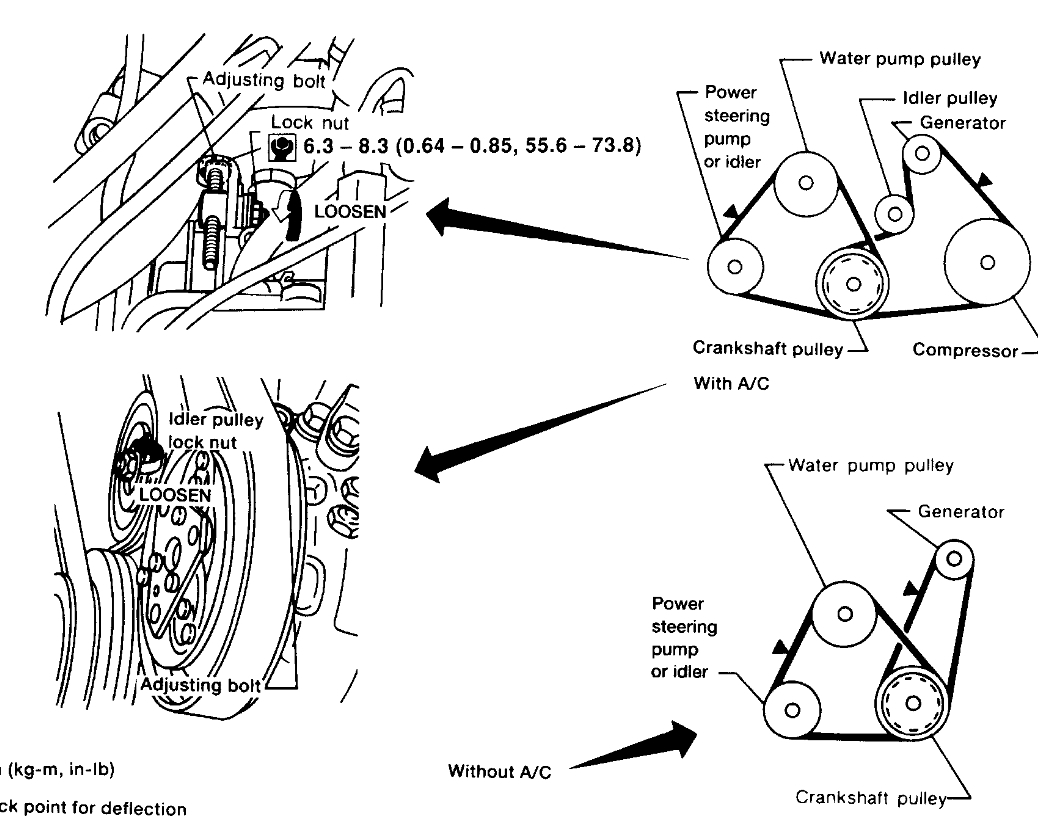

my car will shut off even if I just had it on charger, so I went underneath hood and realized there was no alternator belt. I can't get it on for nothing, is there some trick to this?
Nov 13, 2023 at 7:25 PM
Yes, you must loosen the idler pulley to replace the alternator belt, please check out the images (below). Let us know if you need anything else.
