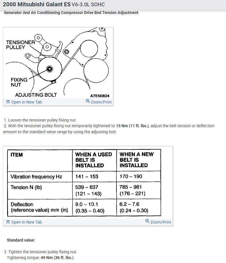

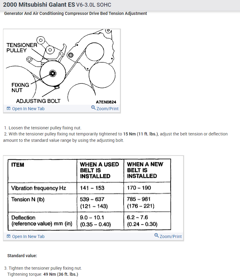

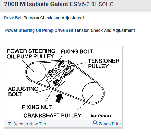

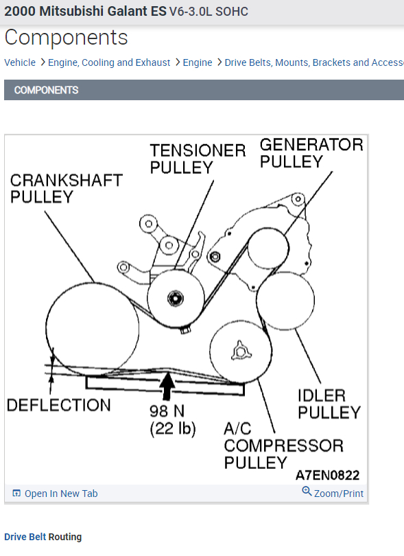

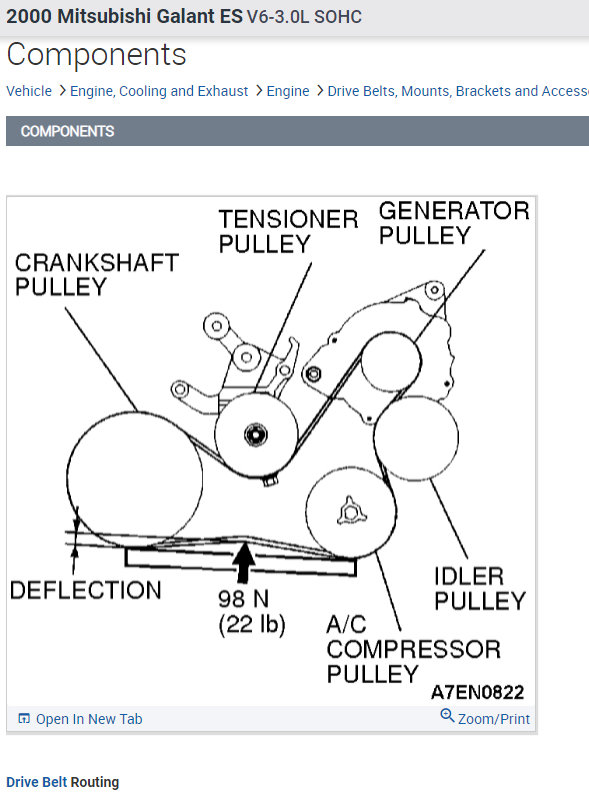

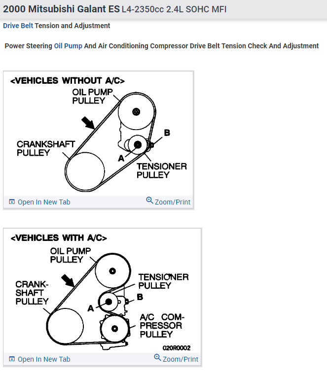

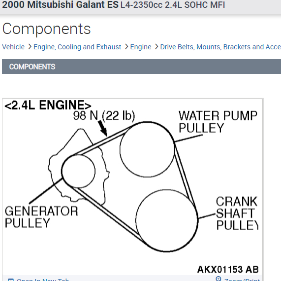

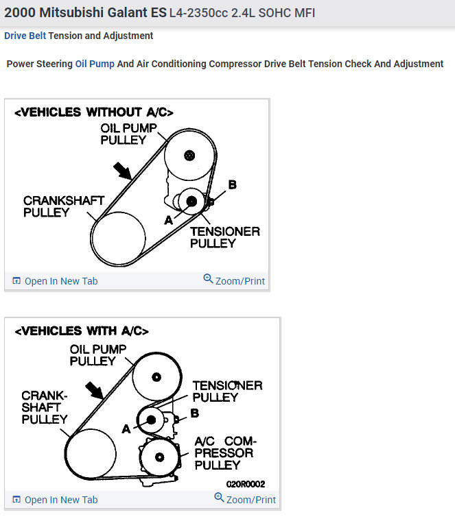

I see that you did not include the engine size so I have included diagrams for both of the 4 cylinder and 6 cylinder engines.
Unfortunately I do not have access to the size of these belts.
You might find these articles helpful:
https://www.2carpros.com/articles/how-a-serpentine-belt-works
https://www.2carpros.com/articles/replace-serpentine-belt
Look below for the diagrams.
