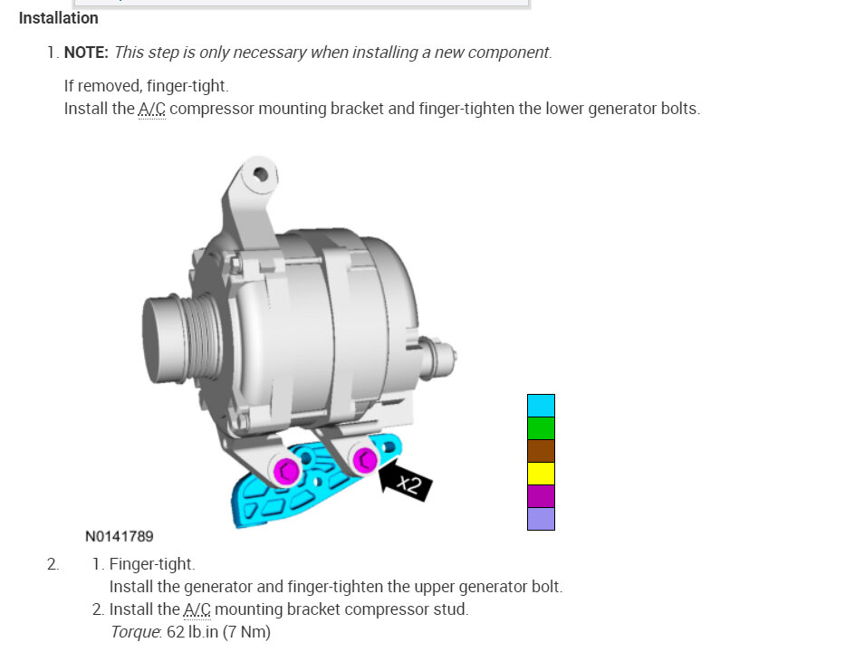

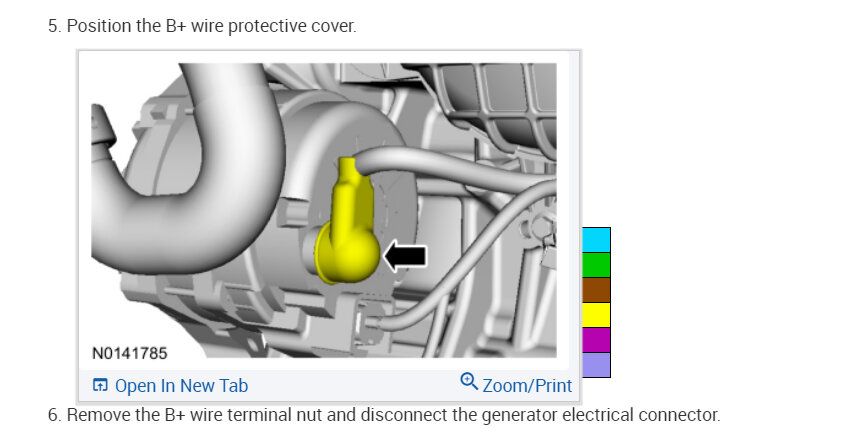

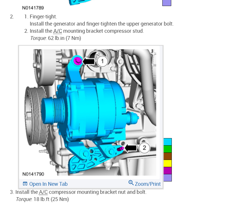

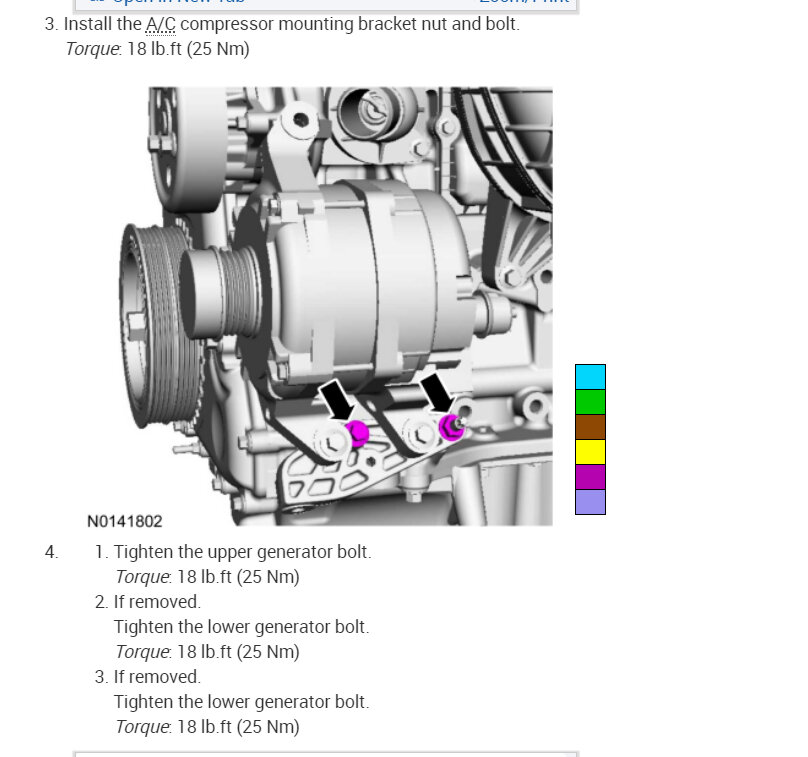

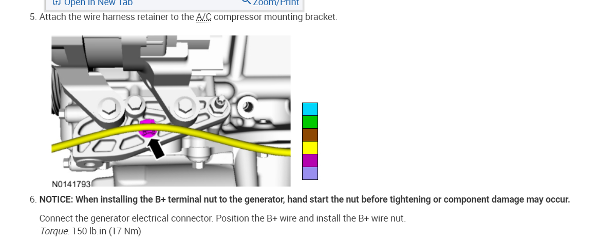

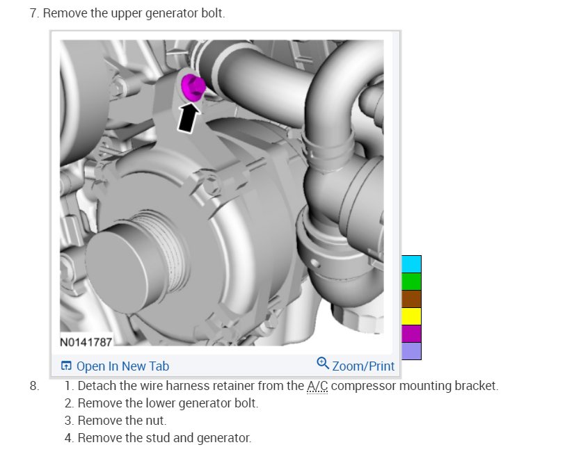

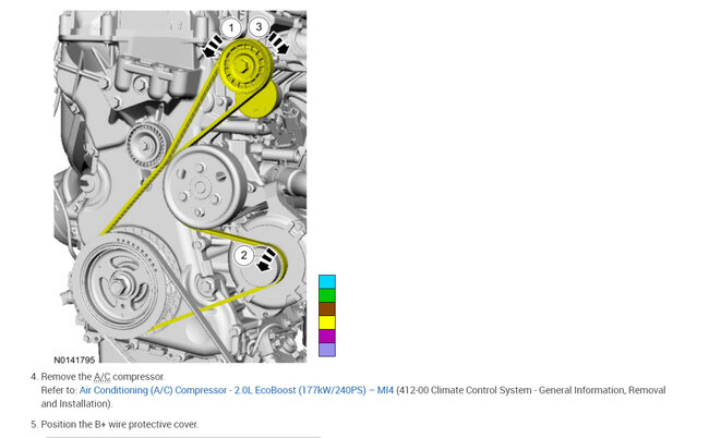

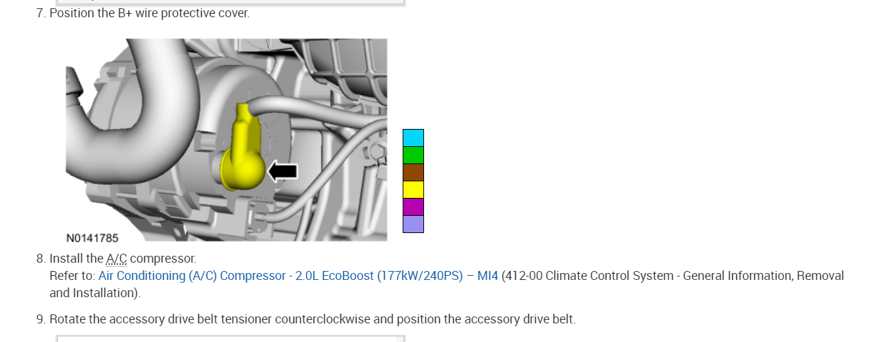

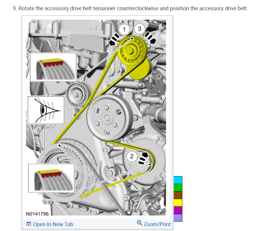

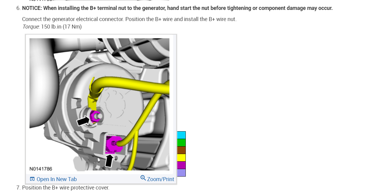

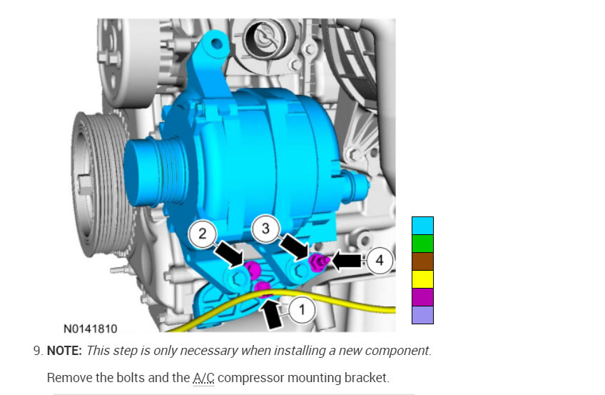

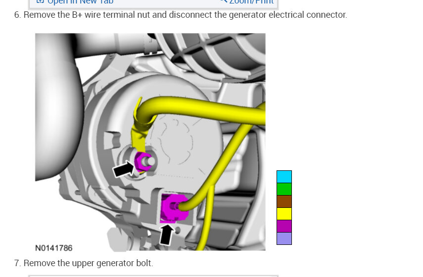

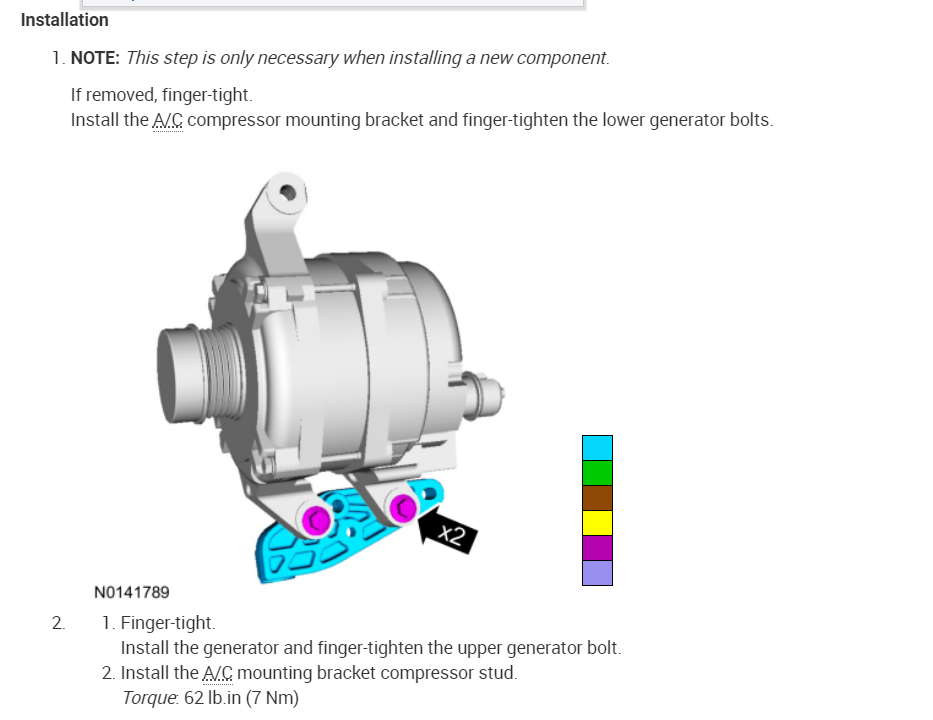

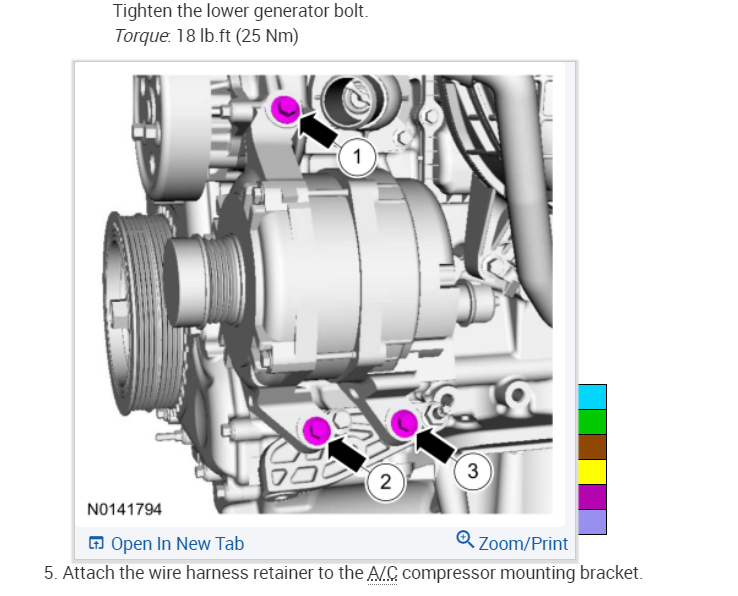

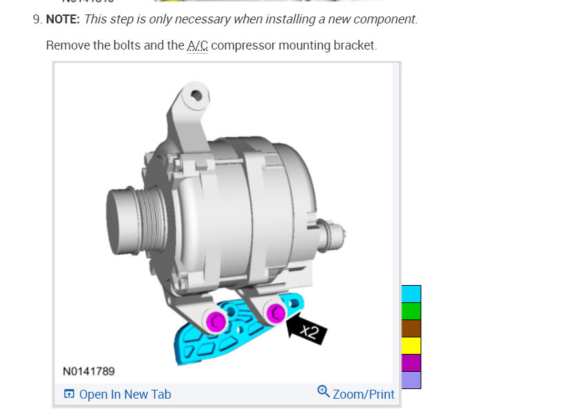

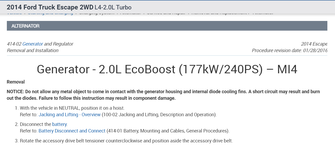

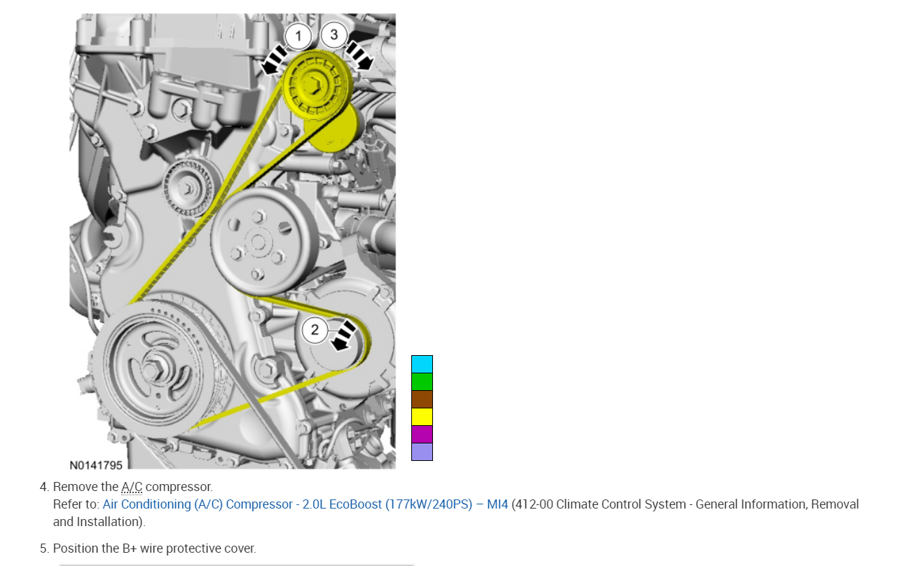

We only handle one subject at a time so please submit a new question for the windshield motor. Also, that is a strange problem on your phone to submit a question. Can I ask which phone you have, and can you upload a screenshot of what you see? Here are the instructions on how to change the alternator out start by disconnecting the battery negative cable. The job doesn't look too bad, but you will need to raise the vehicle up and do some of the work from underneath. If you run into trouble, please upload images of the problem so I can help walk you through the repair. Check out the images (below). Please let us know what happens.
