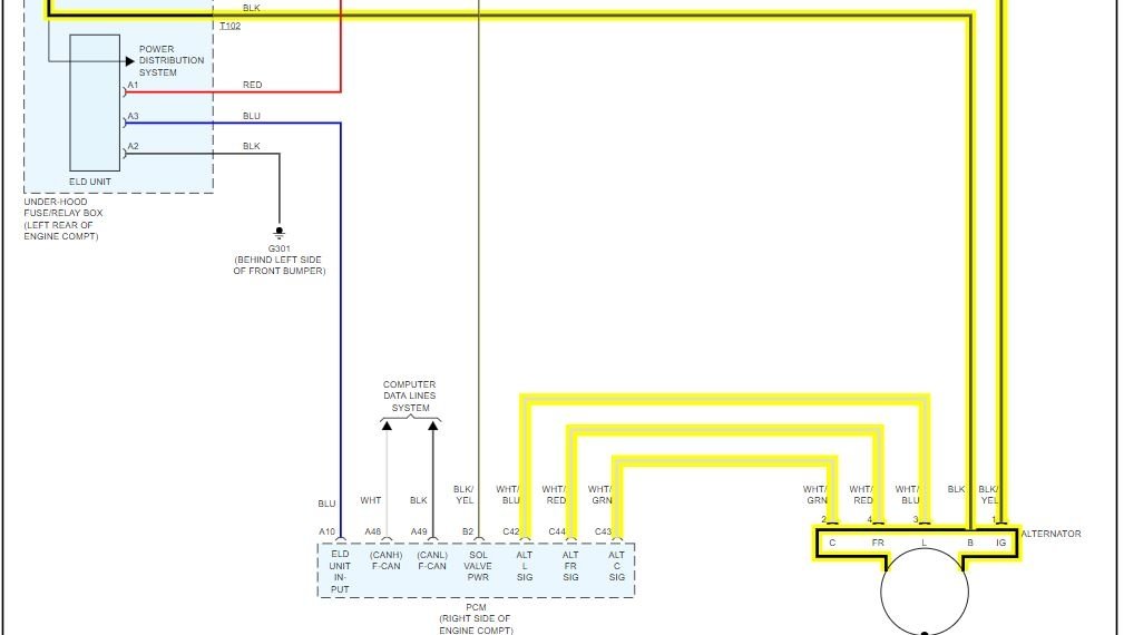

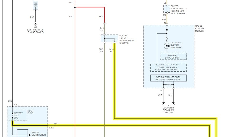

I attached a diagram as well for when we do testing.
