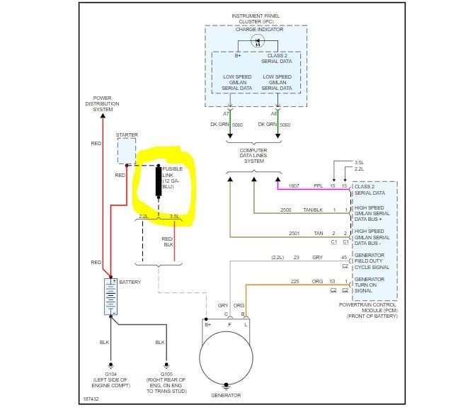

Does my car have a fuse or relay for the alternator?
Feb 1, 2019 at 2:52 AM
Good morning,
Yes, there is a fusible link down at the starter that feeds power to the back of the Alternator.
You need to check for power to the heavy red wire.
