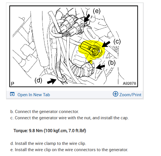

Battery light on dash is on, but when I accelerate the light goes out. I tapped on the alternator during idle, and the light went out. Voltage with light out is 13.8, with light on the battery volts is 12.5.
