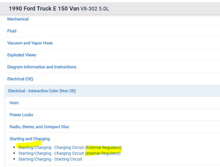

I went to the wiring schematics and found there are two different possibilities. One has an external and one has an internal regulator. I need to know which one you have so I can review the correct schematic.
Also, what do you mean when you say the wiring harness was gone? Do you mean everything is missing? Also, there are a couple of fusible links that may have failed causing a no-charge situation as well.
Let me know what has been checked and exactly what is left as far as wiring.
See pic below.
