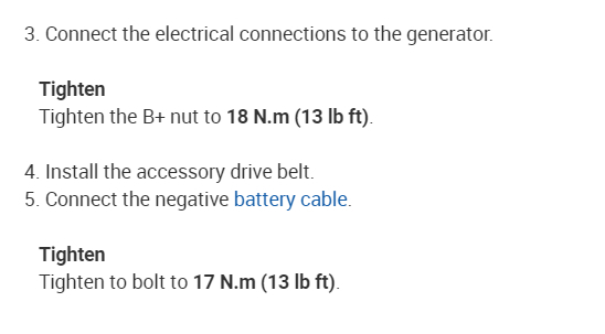

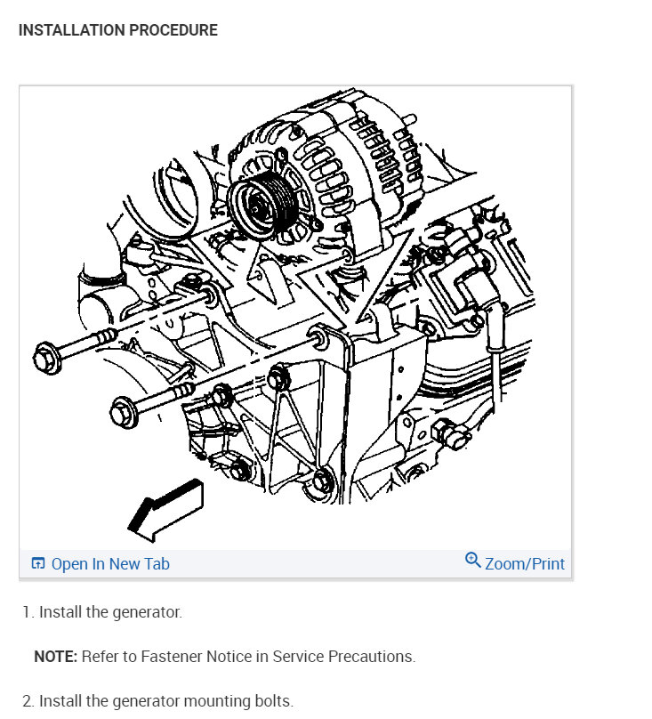

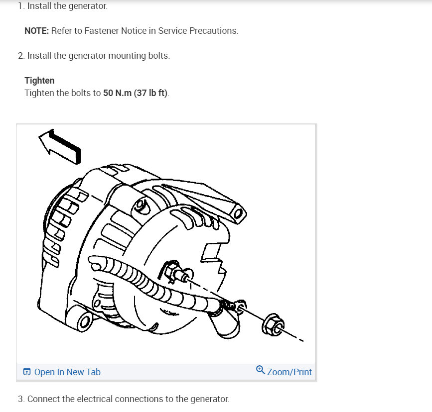

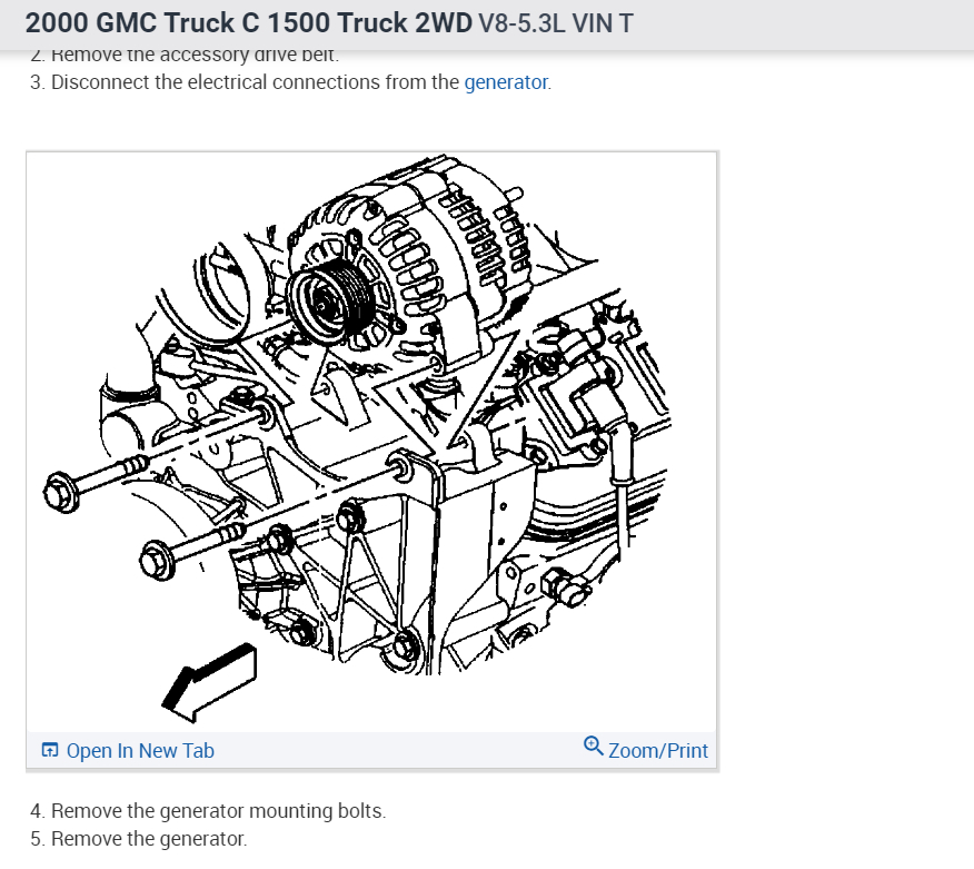

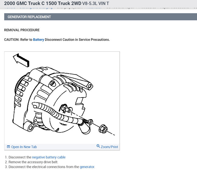

Here are the instructions for the replacement below. Please let us know if you need anything else to get the problem fixed. Disconnect the battery before you begin.
