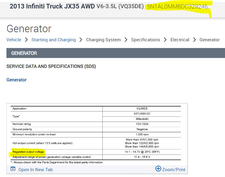

I'm not sure with the VIN number I have what amp alternator is needed for this car. VIN number is 5N1AL0MM8DC329246.
Jul 9, 2024 at 4:30 PM

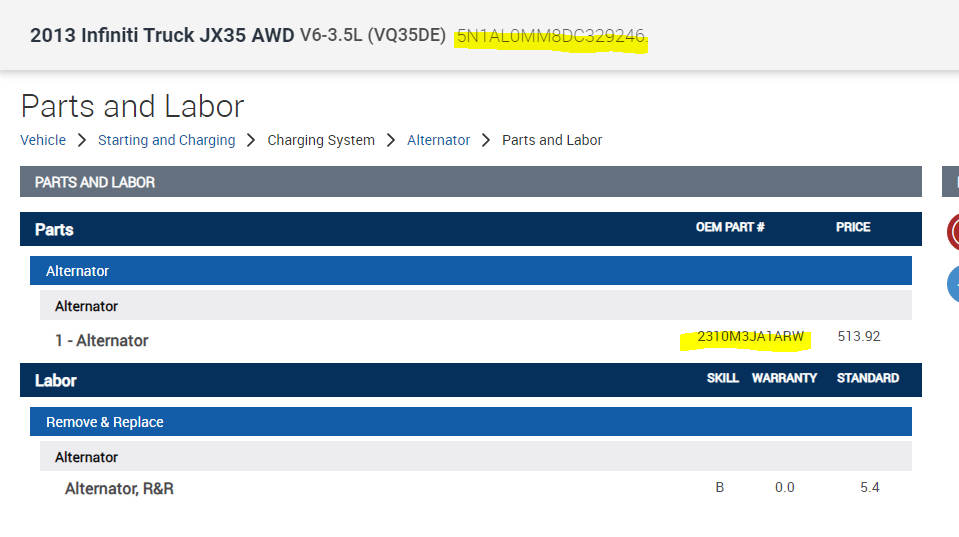

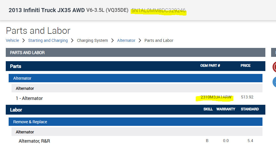

As far as the alternator, based on the VIN, I attached the OEM part number for you below. Note, when you purchase one, make sure the part number crosses to the OEM number.
Pic 2 is the specifications I found. Take a look through this information and let me know if it helps.
See pics below.
