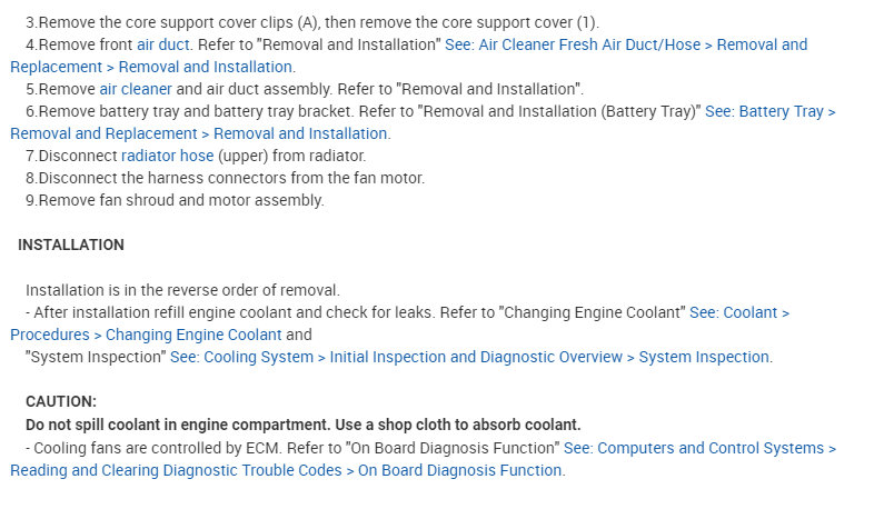

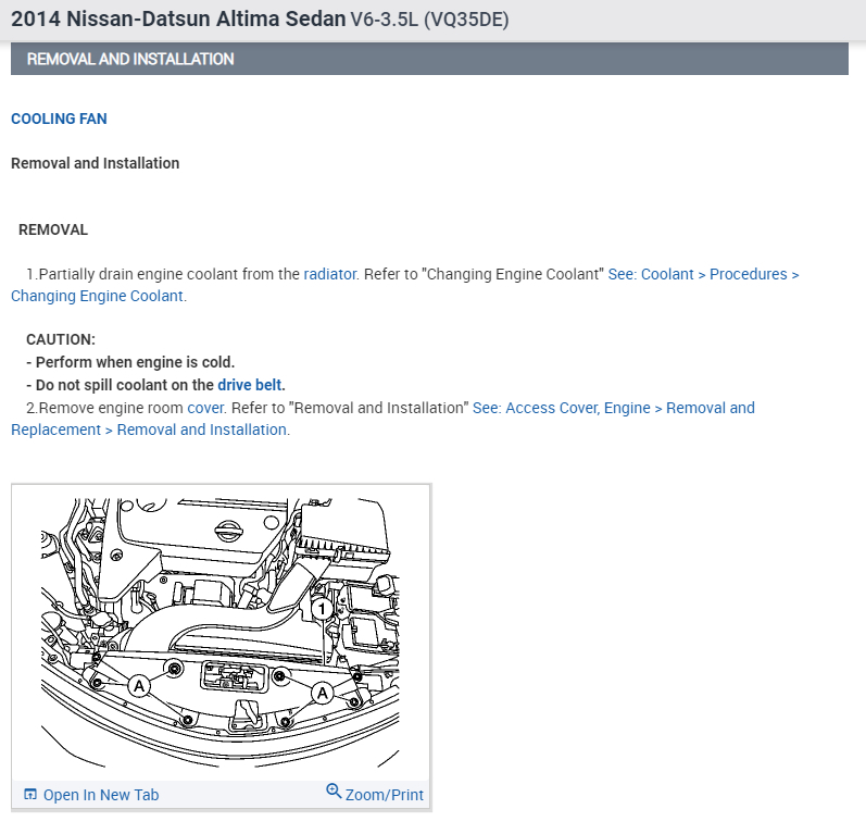

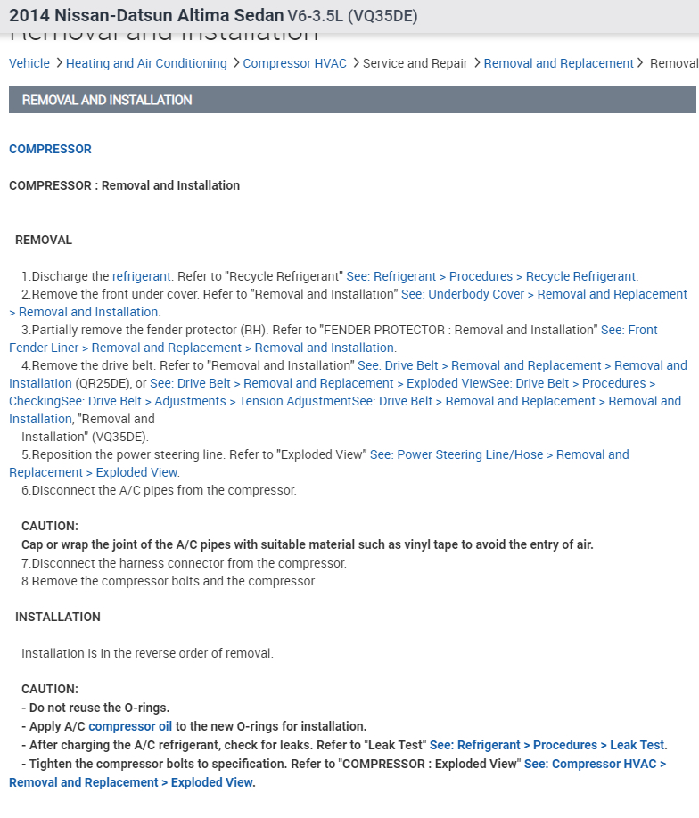

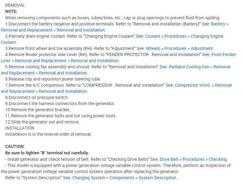

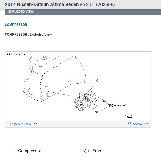

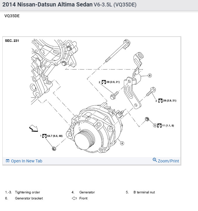

In order to replace the alternator, you will have to first remove the front passenger side wheel and remove the inner fender liner. Then the A/C compressor will need to be removed and the radiator fan. It will also require partial draining of the coolant system.
I have attached the steps below.
