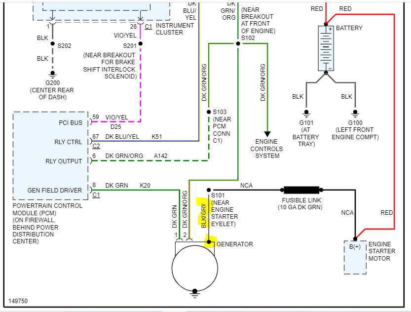

The alternator was likely not the problem. The alternator's output is regulated by the powertrain control module. It isn't integral to the alternator.

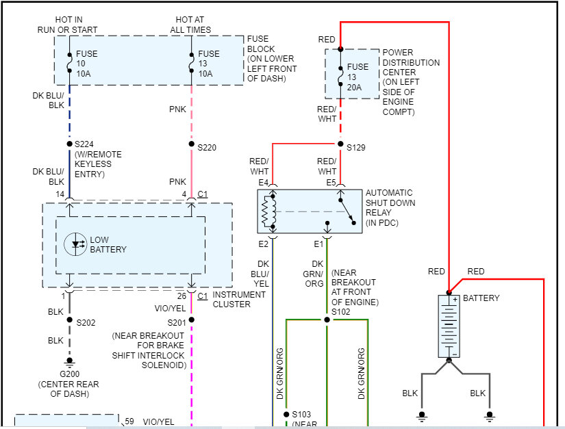

I attached the circuit wiring schematic below, so you have a reference.
Here is what I need you to do. First, there will be a black wire with a gray tracer at the alternator. It should have battery voltage at all times. Check to make sure that it is present.
If it does, I want, you to perform the alternator test listed in this link:
If the alternator fails the test, it has power to it, the last two things are the alternator or the PCM. I would remove the alternator and have it bench-tested at the parts store. I realize it's new, but anything is possible. If it passes the test, the PCM needs to be replaced.
