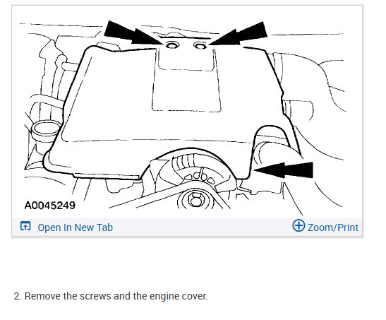

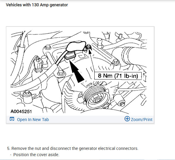

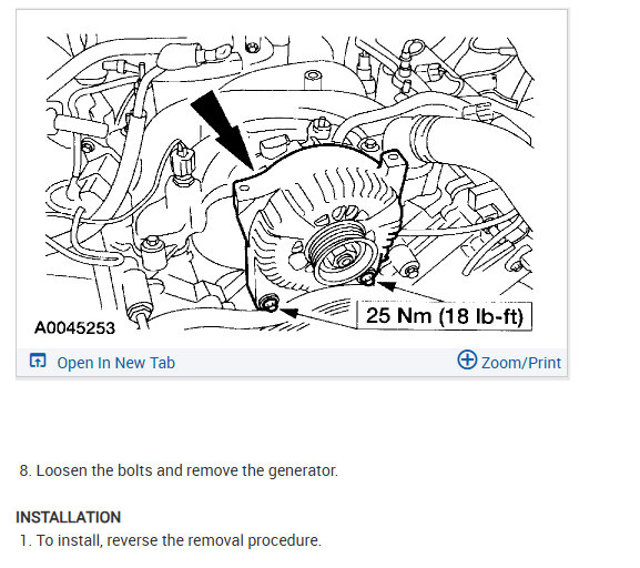

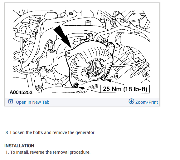

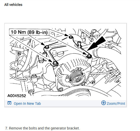

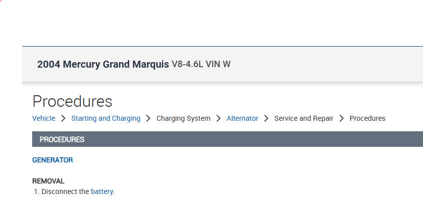

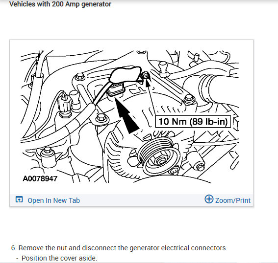

If you look below, I have attached the directions for replacing the alternator. Note that there are two different alternators that could have been used. One is a 130 amp, and the other is a 200 amp. You may want to remove it and take it with you when you get the new one. That way, the correct amperage can be obtained.
Also, here is a link that you may find helpful:
https://www.2carpros.com/articles/how-to-replace-an-alternator
See pics below. This is an easy one. Just make sure the negative battery terminal is disconnected before you start.
