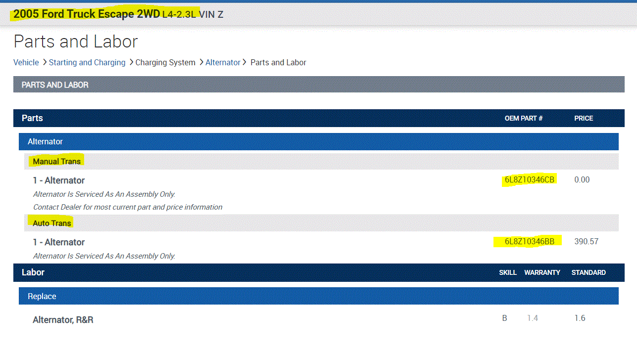

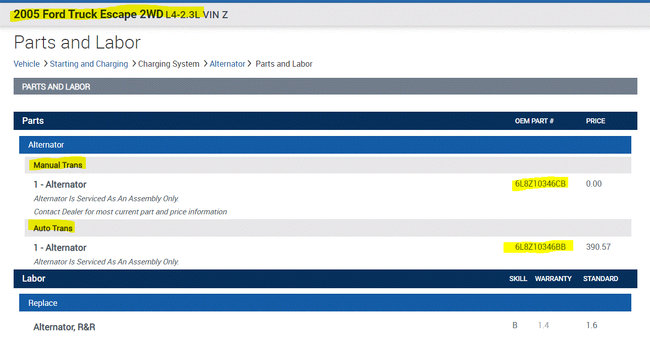

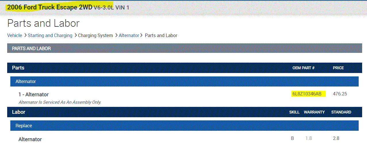

I looked up part numbers for both of the vehicles you mentioned. They have different part numbers, so I would not recommend it.
If you look at the first two pics below, it shows the part numbers and labor time.

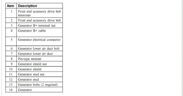

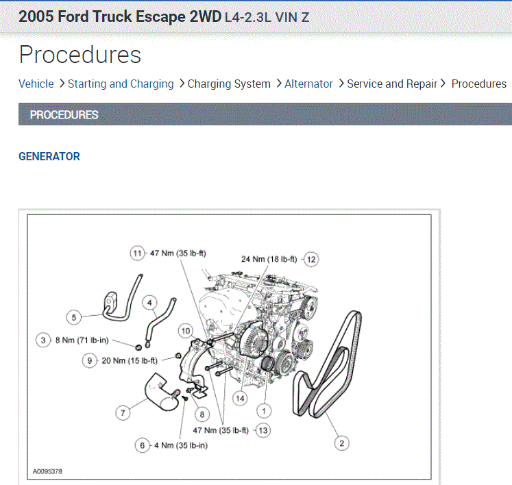

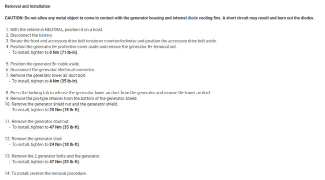

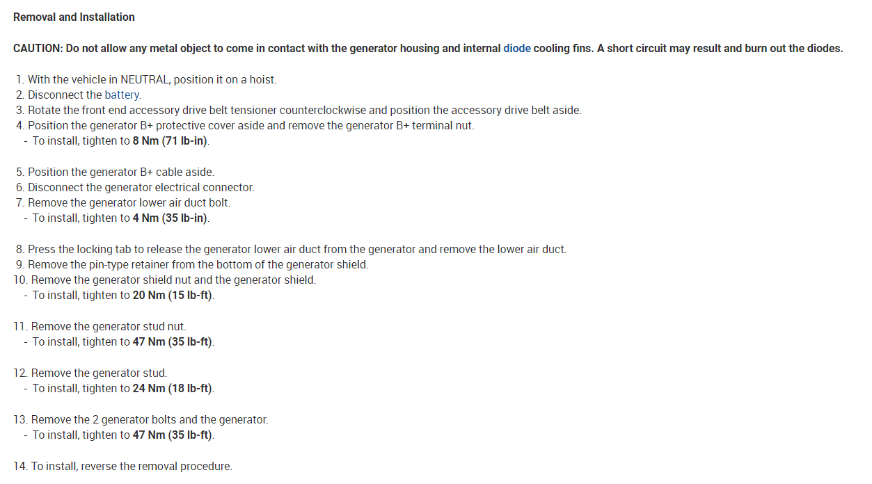

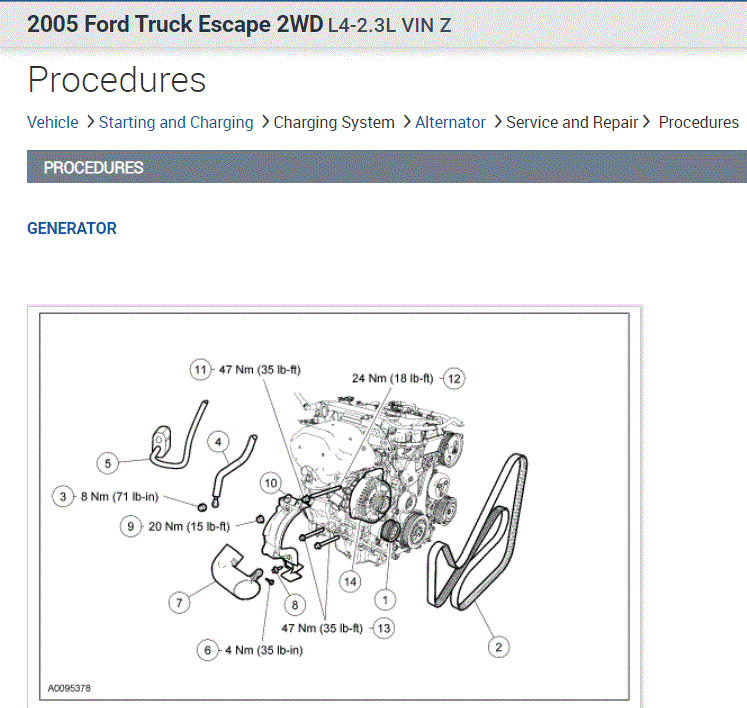

The remaining pictures are for replacement specific to your vehicle.
I hope this helps. Let me know if you have other questions.
See pics below.
