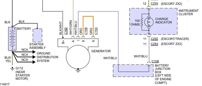

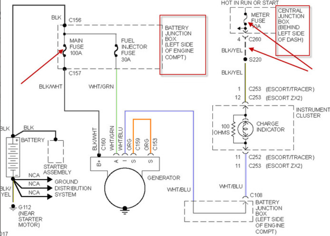

Had both re-manufactured alternators tested before installed. Had third one checked before taking it. Tested good. This is my wiring diagram.

Your injector fuse is involved, Our information says terminal A is hot all the time. You can check that circuit.
