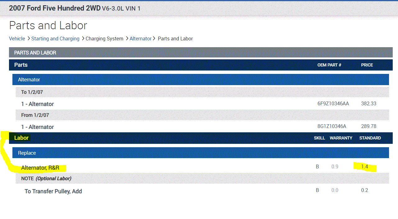

How long should it take roughly to change the alternator? i need to replace mine?
Jun 16, 2019 at 8:13 PM

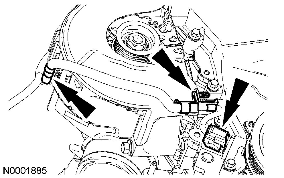

The labor rate is 1.4 hours with the correct tools. It may take longer without a rack to lift the vehicle. See pic 1 for labor time.

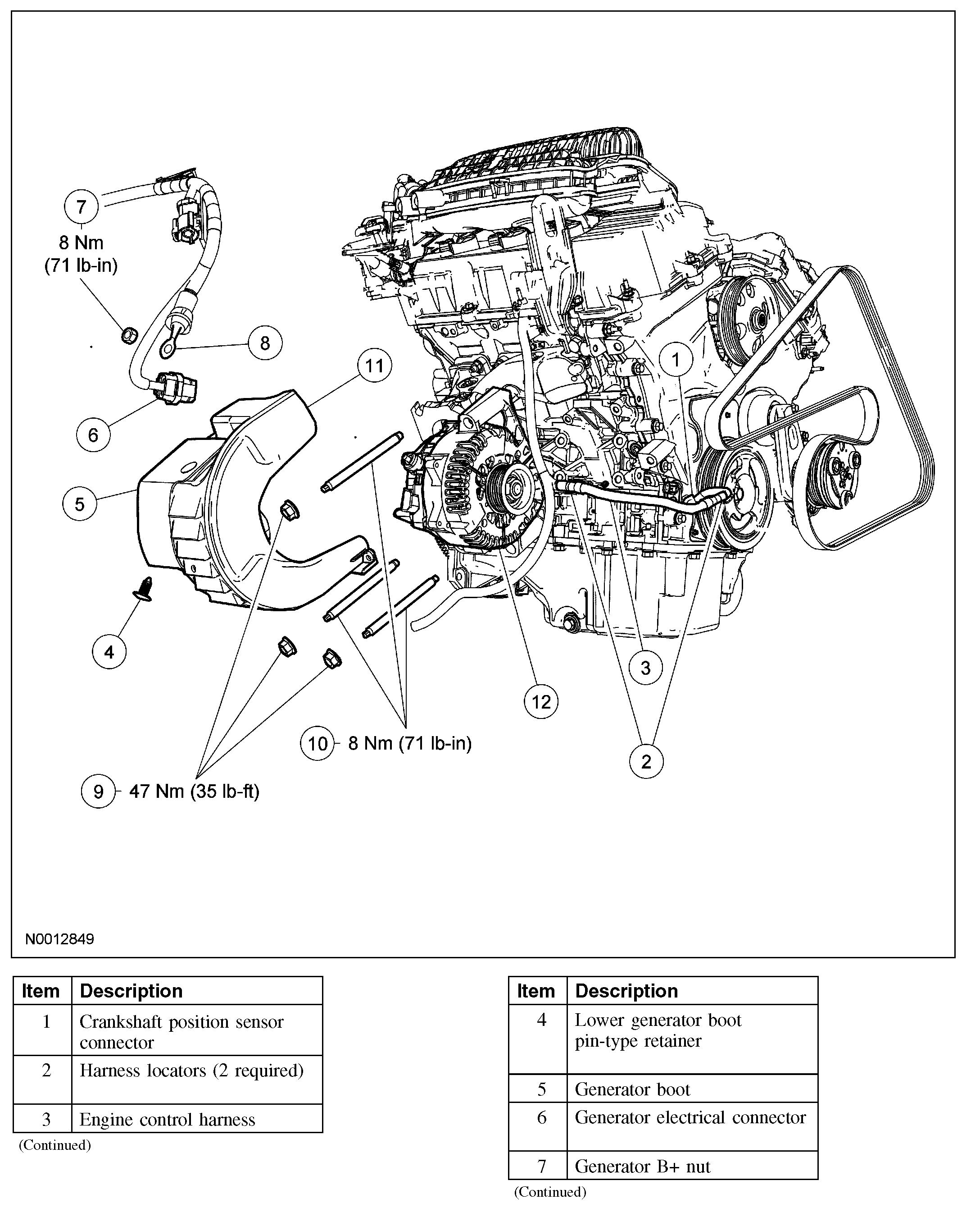

Here are directions specific to your vehicle for replacement. The remaining pics correlate with the directions.
__________________________________________
2007 Ford Five Hundred 2WD V6-3.0L VIN 1
Procedures
Vehicle Starting and Charging Charging System Alternator Service and Repair Procedures
PROCEDURES
GENERATOR

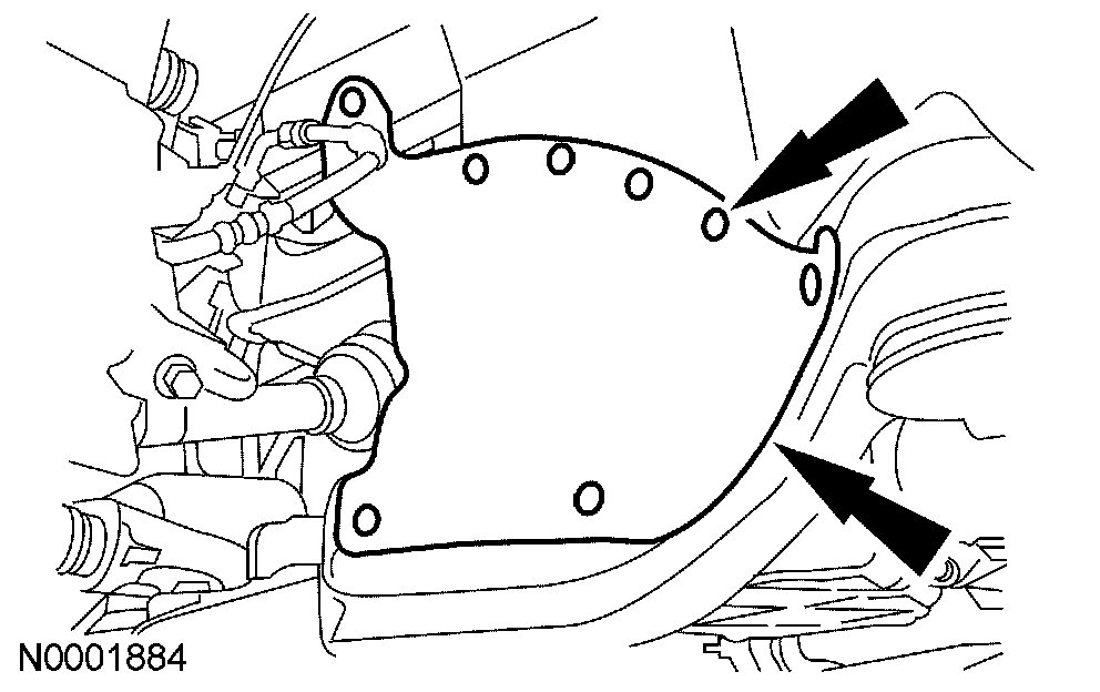

Part 1
pic 2

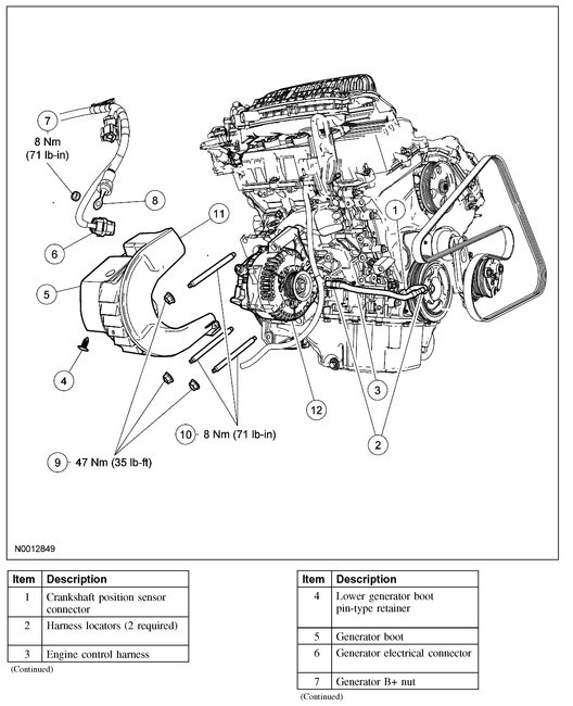

Part 2
pic 3
Removal and Installation
1. With the vehicle in NEUTRAL, position it on a hoist.
2. Disconnect the battery.
3. Rotate the accessory drive belt tensioner counterclockwise and position the accessory drive belt aside.

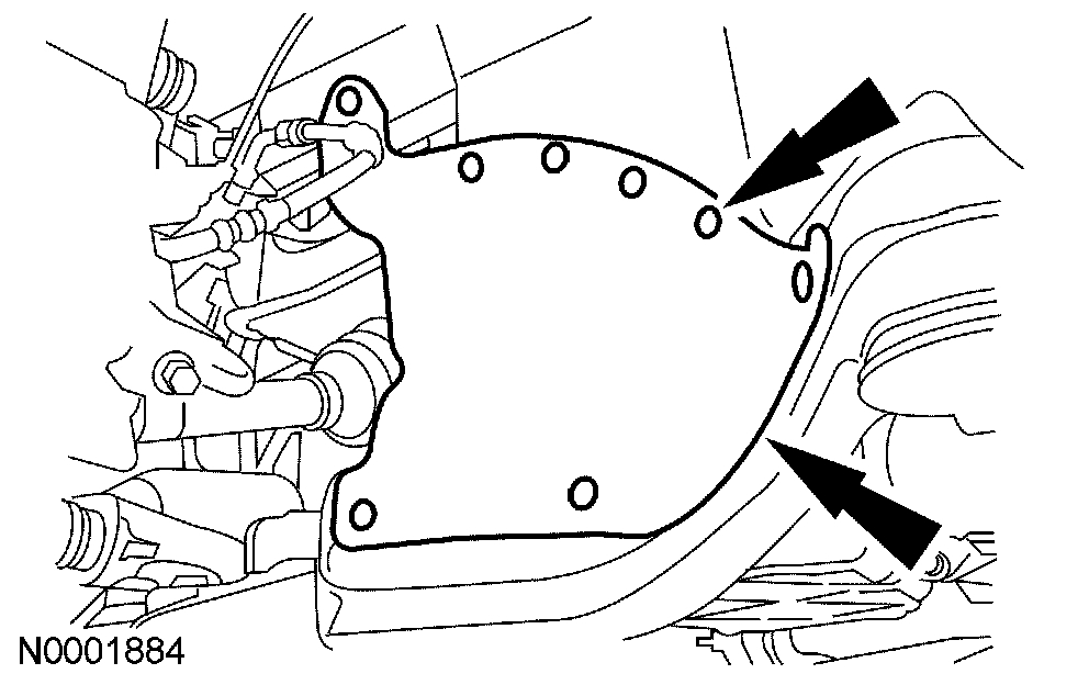

pic 4
4. Remove the 8 pin-type retainers and the right lower splash shield.

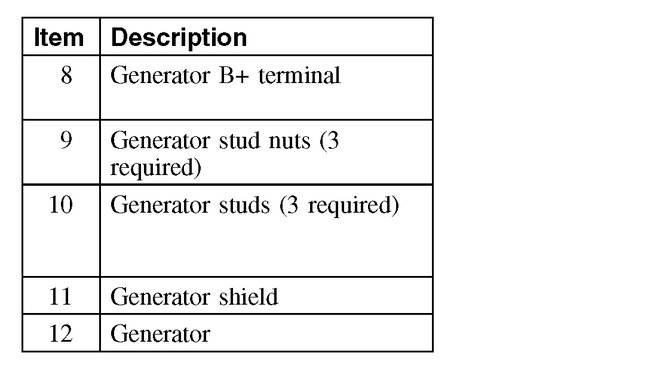

pic 5
5. Disconnect the crankshaft position sensor and release the 2 wiring harness locators from the generator splash shield.
6. Remove the lower generator boot pin-type retainer, fold the boot upward and disconnect the generator electrical connector.
7. With the generator boot folded upward, position the protective cover aside and remove the generator B+ nut and terminal.
- To install, tighten to 8 Nm (71 lb-in).
8. NOTE: The 3 generator studs and nuts may be replaced with 3 bolts (W709986-S437) to ease the installation of the generator.
Remove the 3 generator nuts and stud bolts.
- To install, tighten the generator stud bolts to 8 Nm (71 lb-in).
- To install, tighten the new generator bolts or generator nuts to 47 Nm (35 lb-ft).
9. Remove the generator shield and the generator.
10. To install, reverse the removal procedure.
