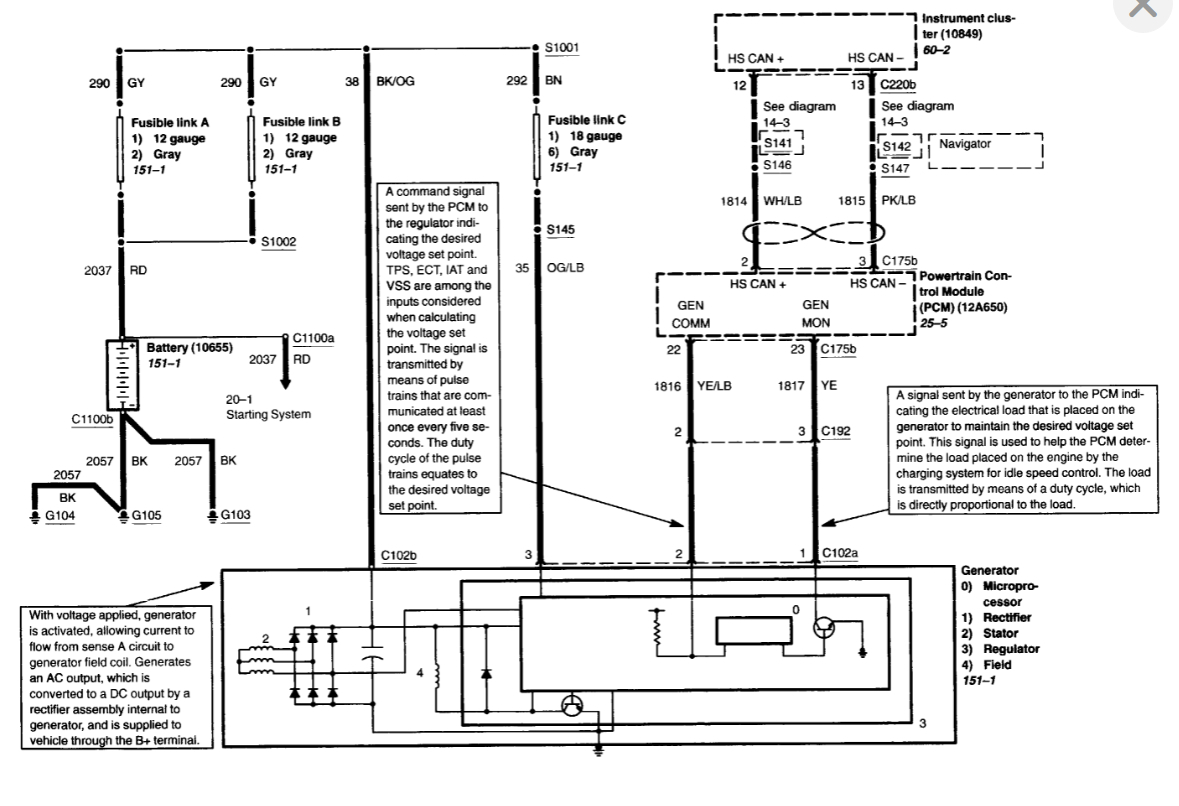

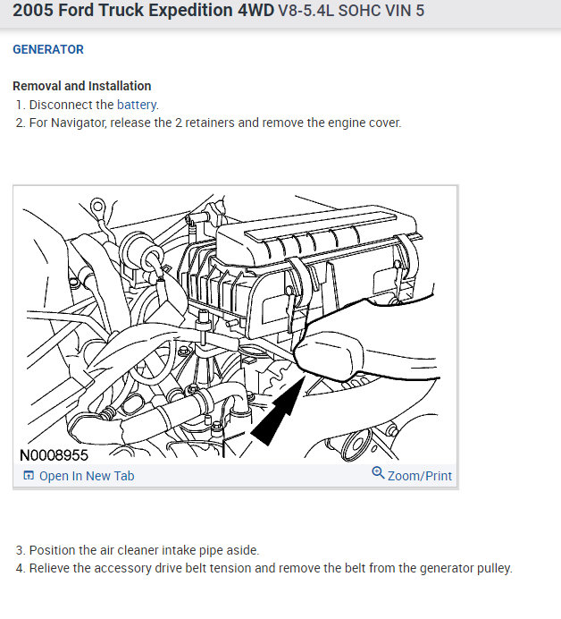

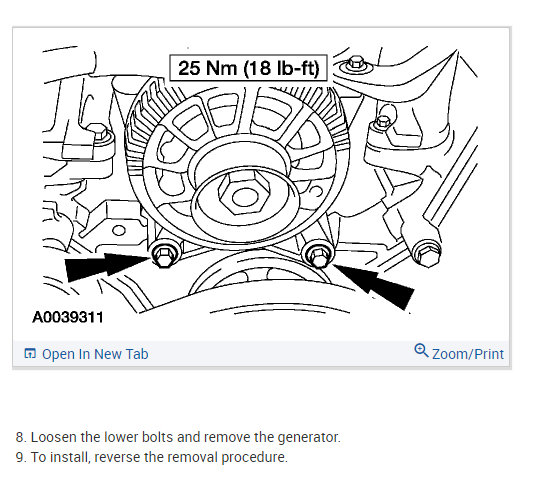

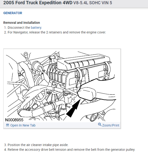

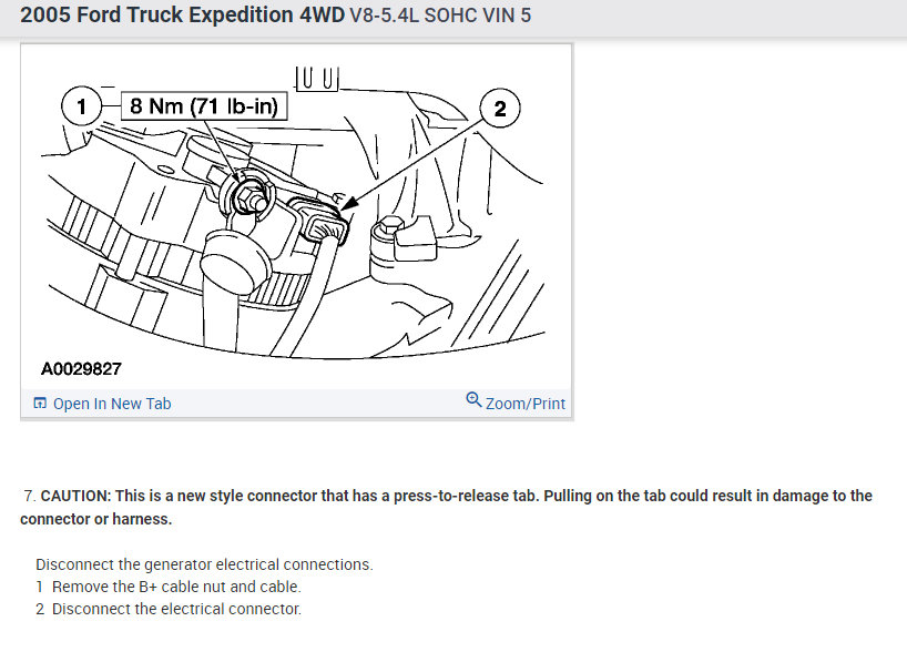

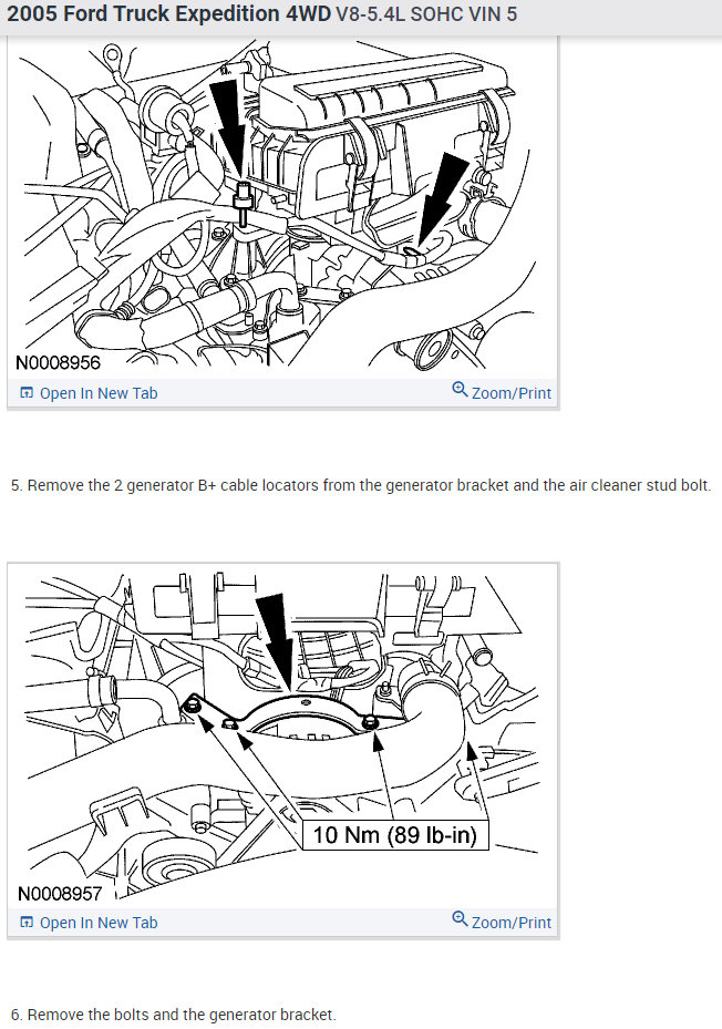

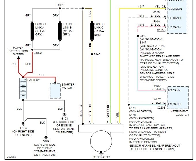

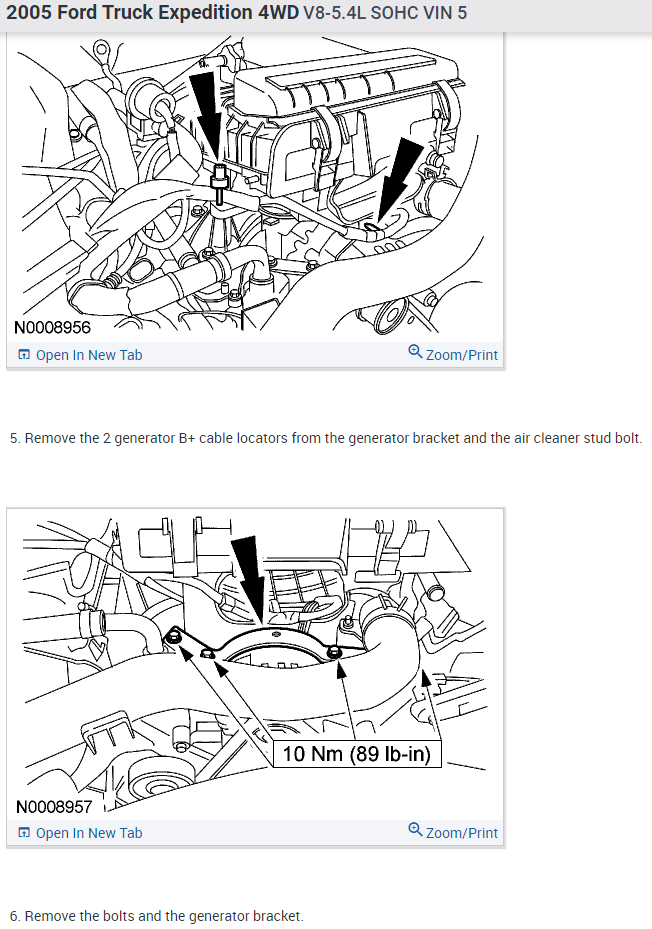

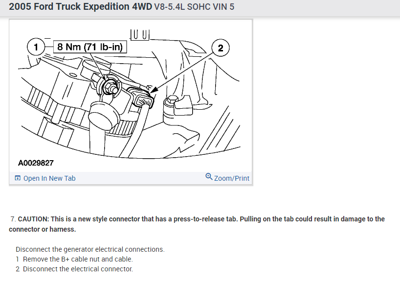

I have attached the wiring schematics of the charting system as well as the alternator replacement procedure your reference.
Thank you.

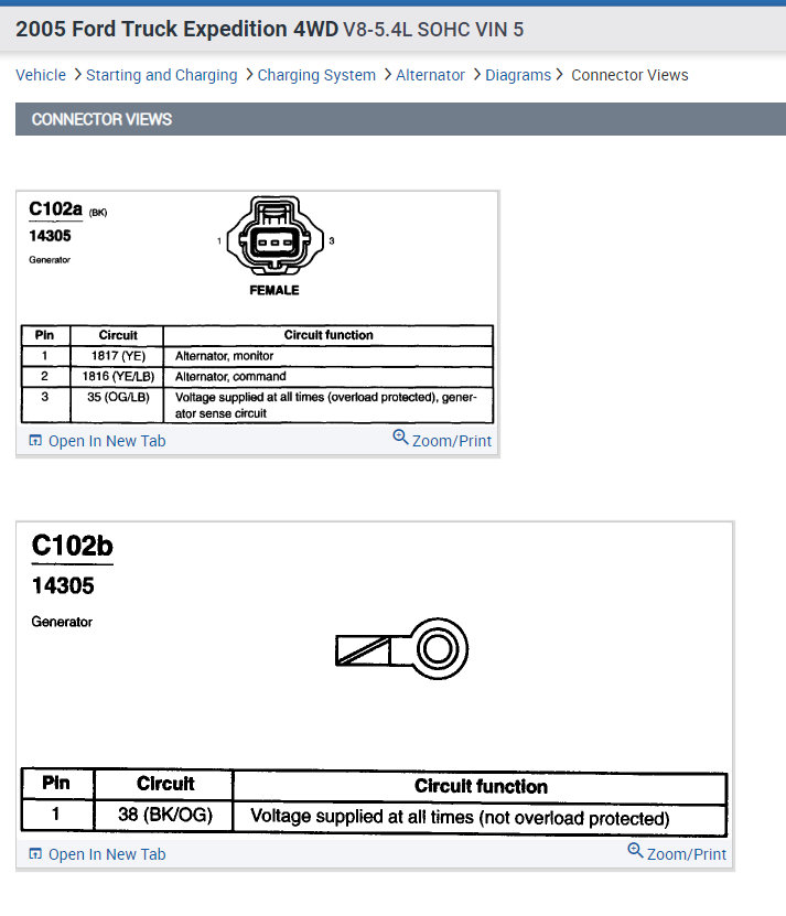

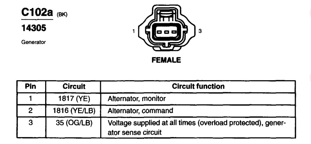

I only have 2 wire "A " and " I " (marking on connector).
Sep 16, 2021 at 12:03 PM
(Merged)
CERTIFIED EXPERT
52,796 POSTS

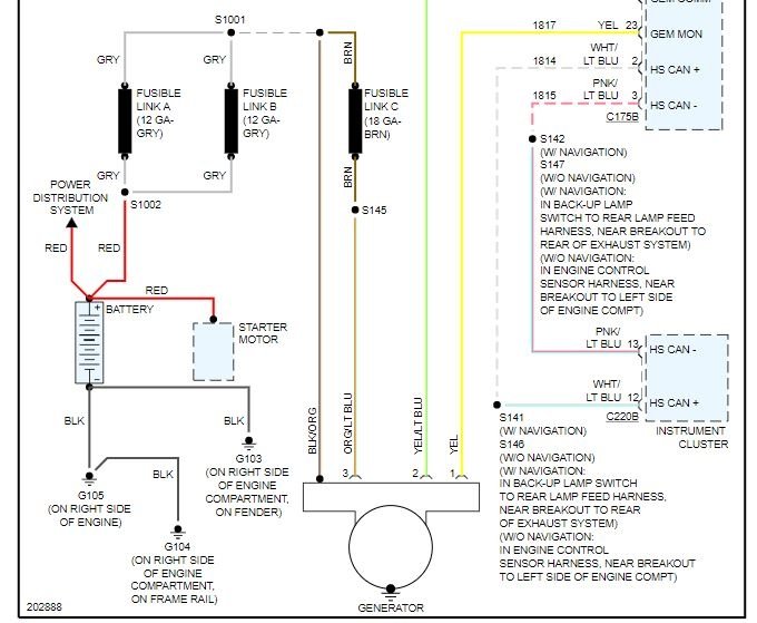

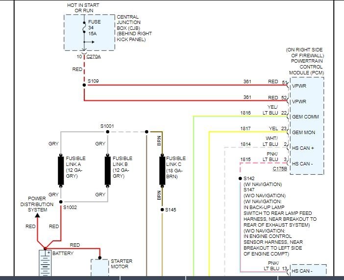

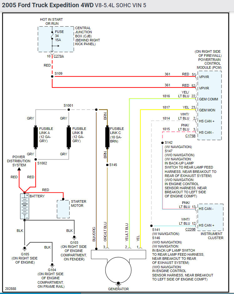

Good evening,
I attached the wiring diagram of the charging system for you as well as the connector diagram with the location of the wires for you.
