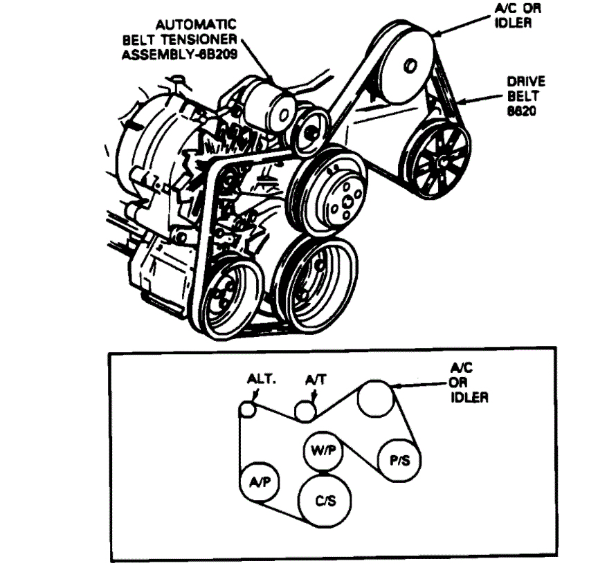

I attached a pic below showing the belt routing diagram. Make sure it is correct as well.
