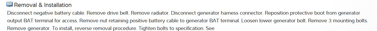

How do I remove my alternator in this car? Step by step please. I am new at this and do not want to mess up the car.

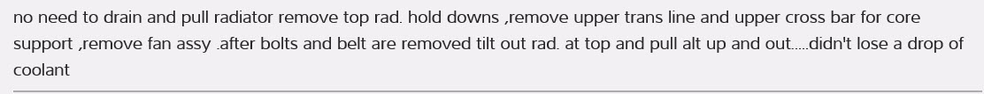

see pictures for instructions reverse for install. I have included a tip on how to do it without draining radiator like it says in instructions. the torque is 22 ft. lb. for both bolts on alternator. See pictures.
