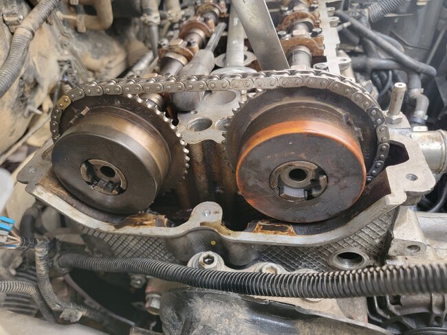

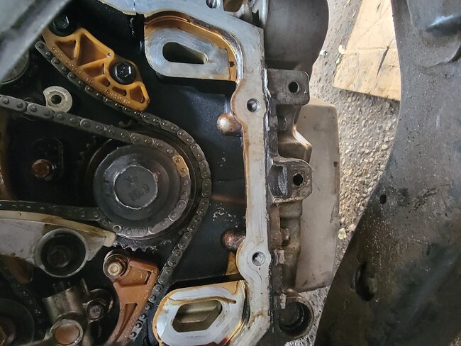

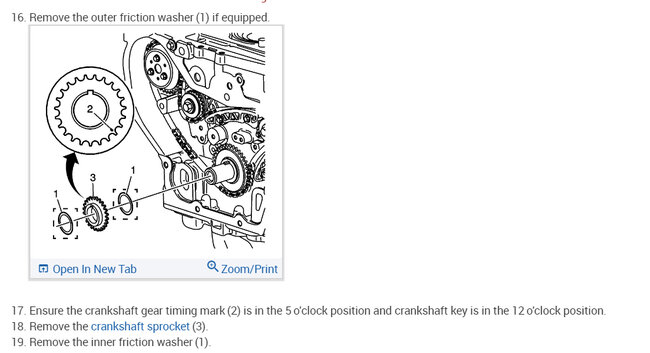

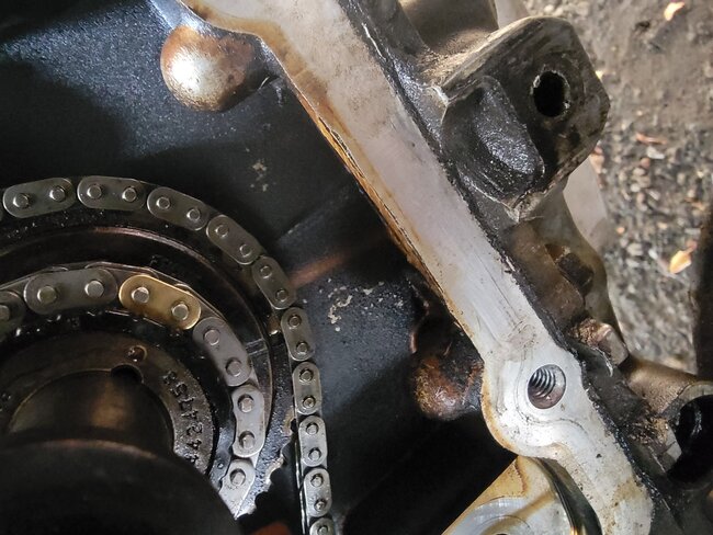

I got a couple of codes after changing timing chains, new chain and guides. I also pulled the engine to do refresh i will show you my work let me know what you think. These codes are listed as pulled in this order:
P0011
p0016
p0017
p0113
p0742
P0742 I'm thinking maybe didn't seat torque converter in correctly?
Sep 9, 2023 at 6:25 PM

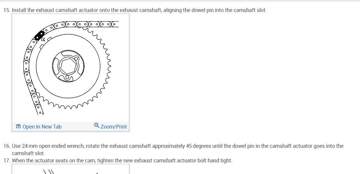

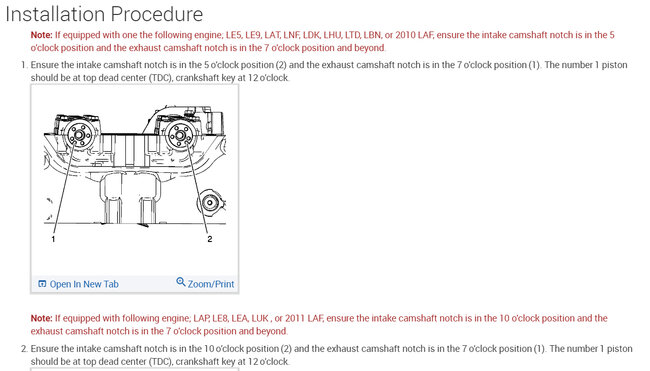

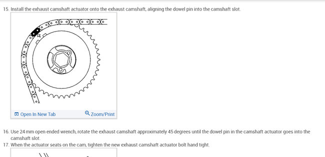

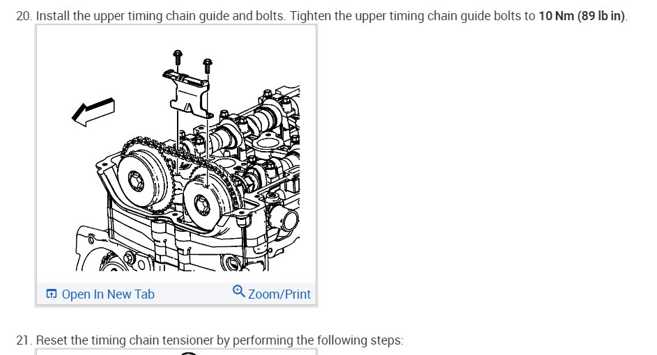

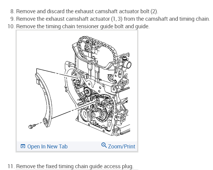

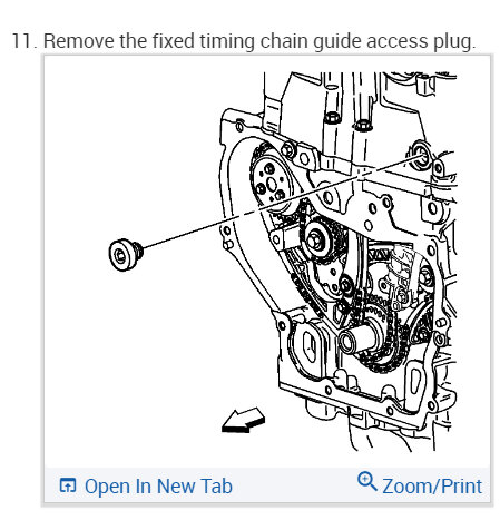

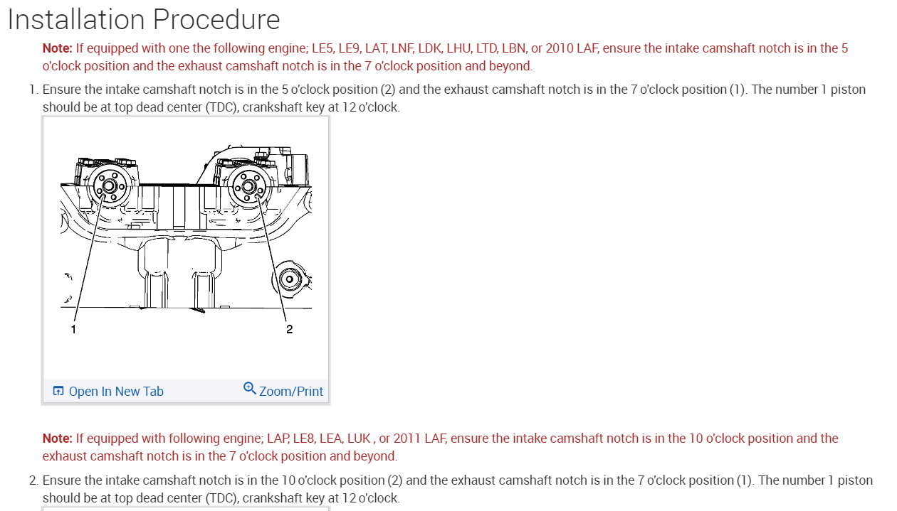

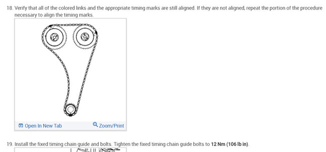

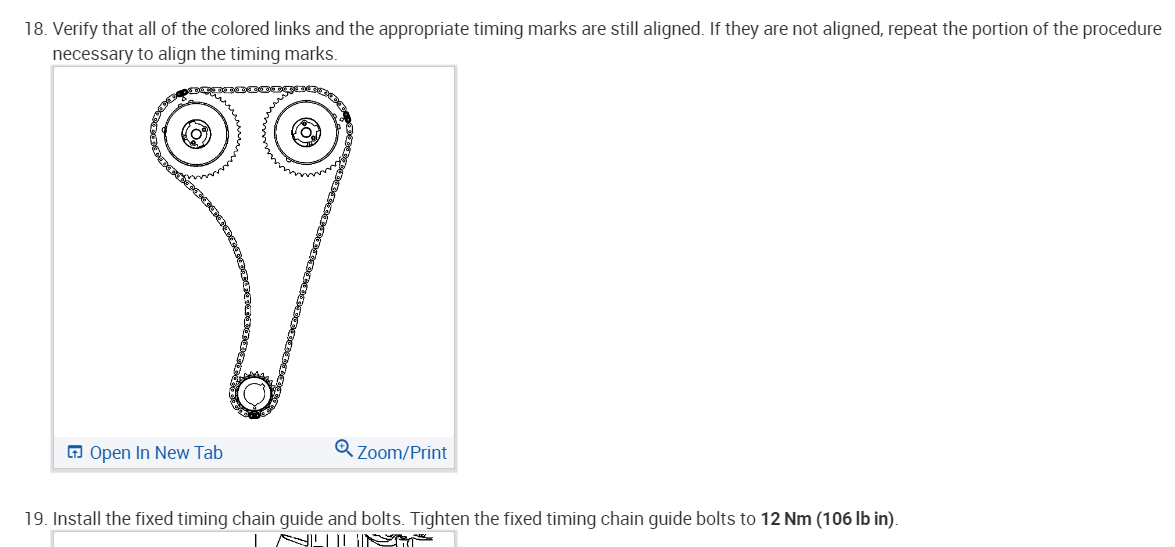

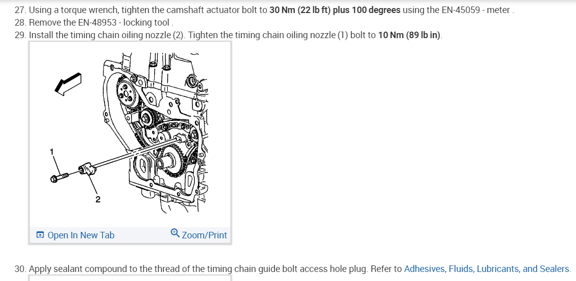

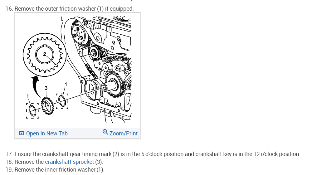

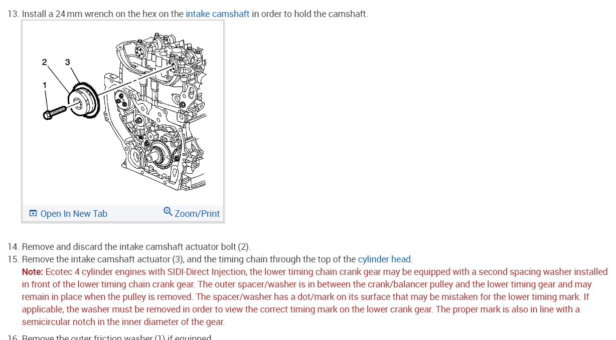

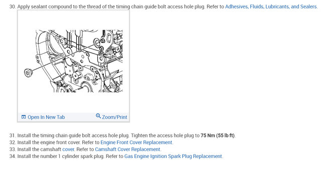

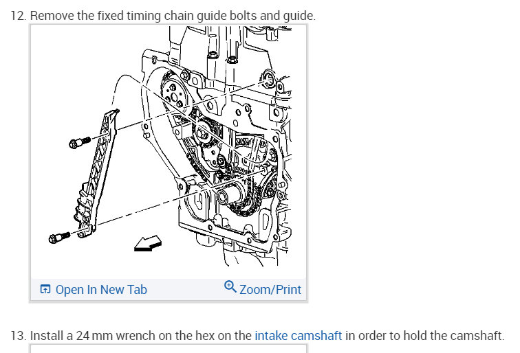

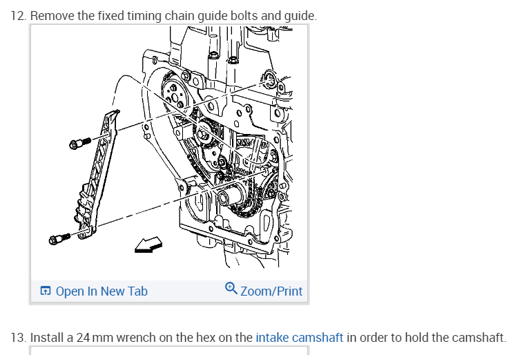

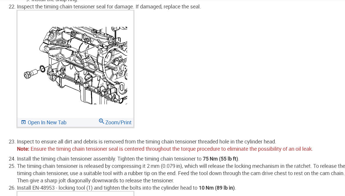

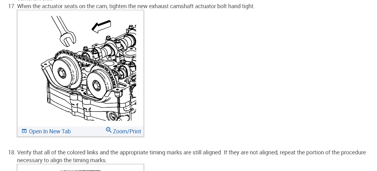

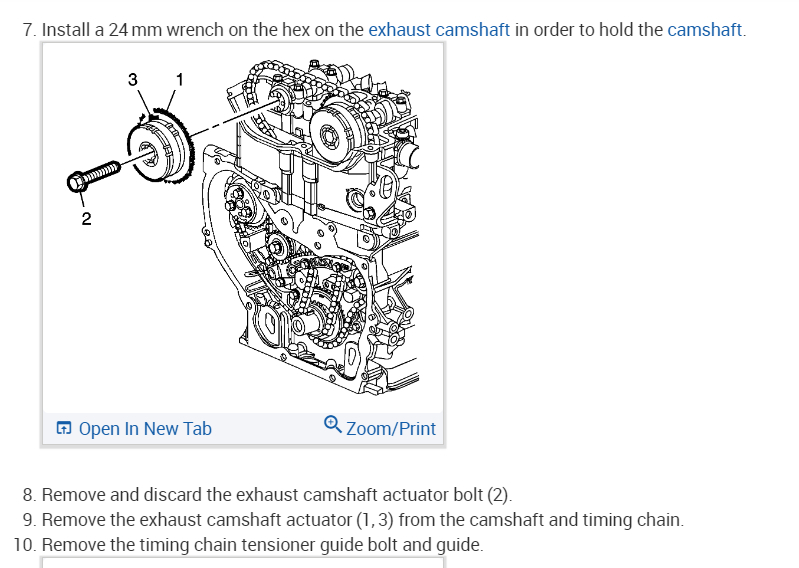

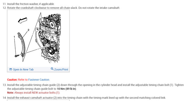

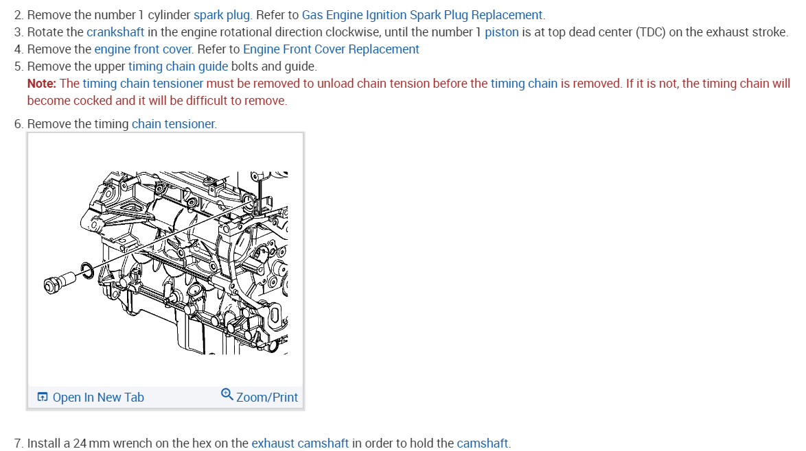

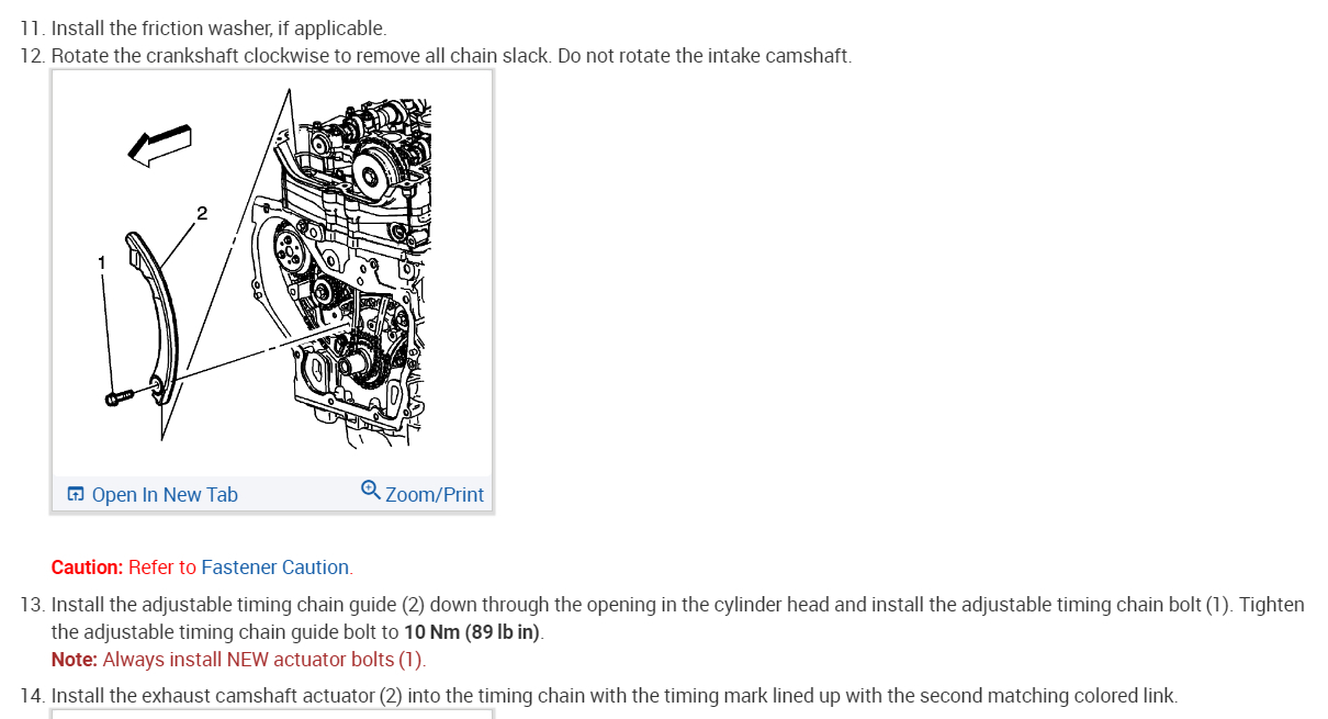

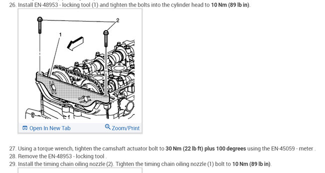

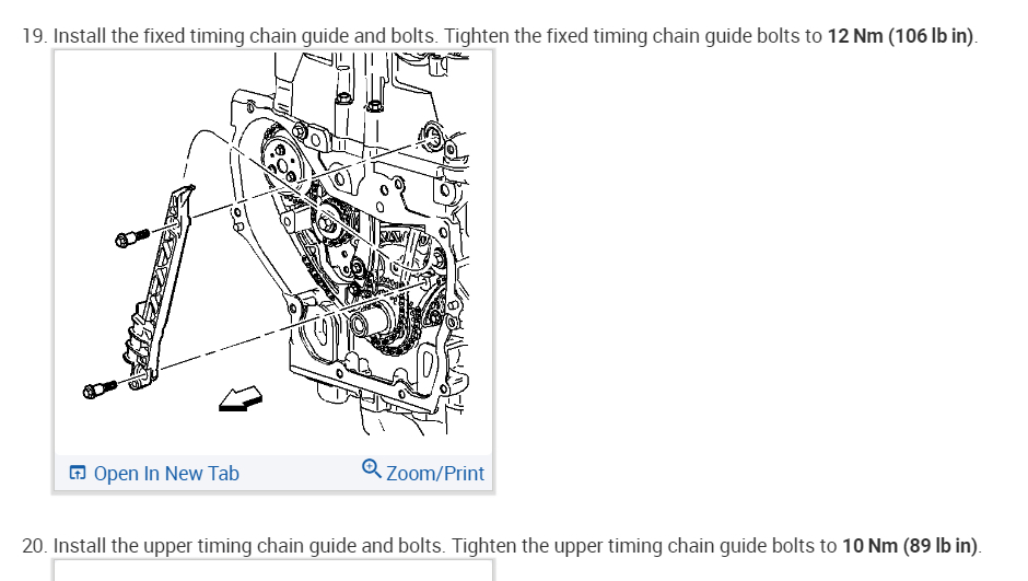

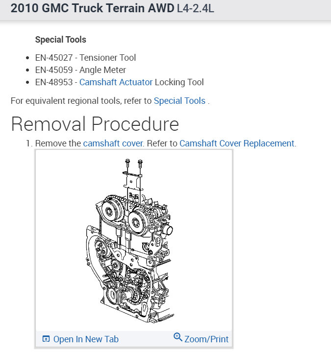

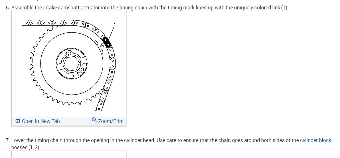

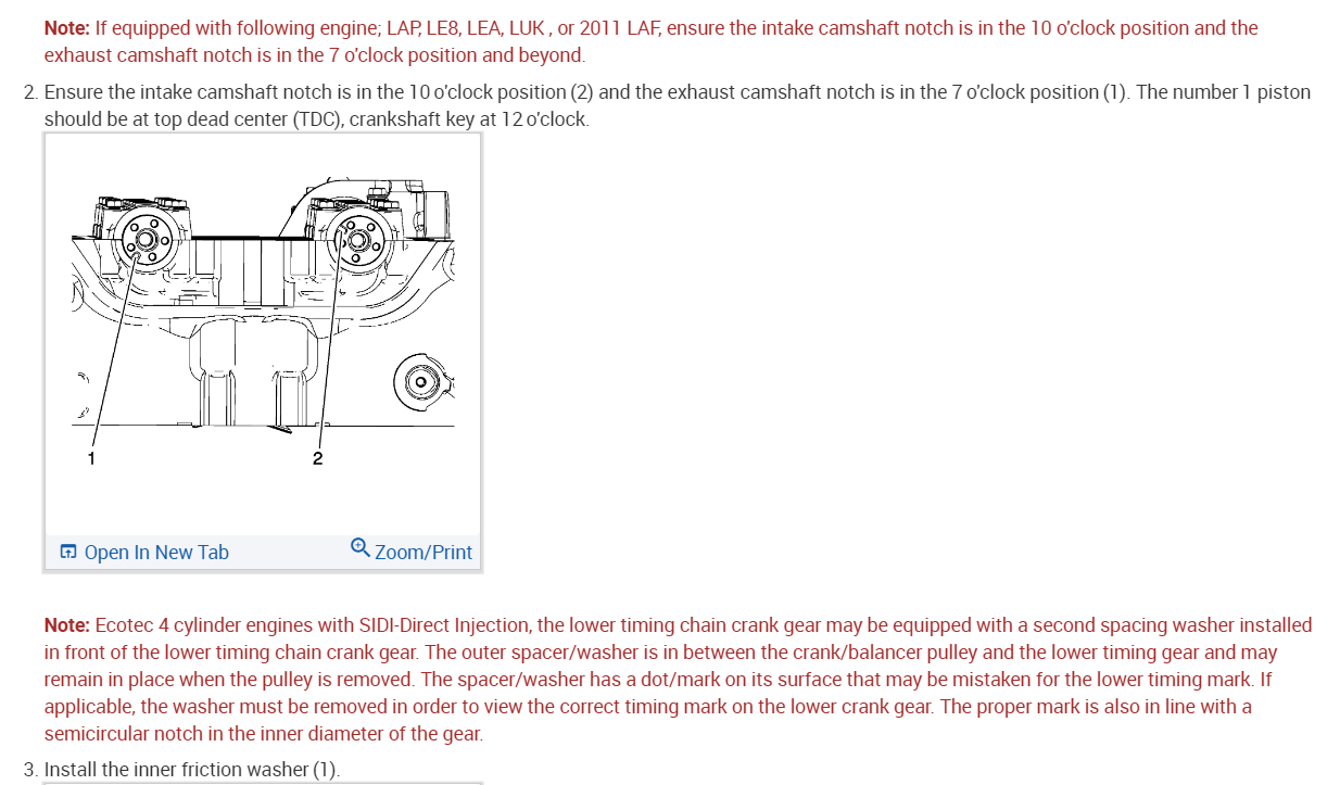

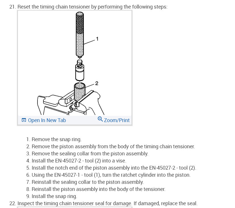

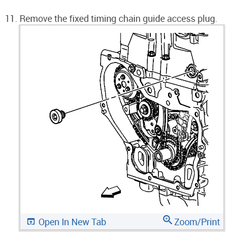

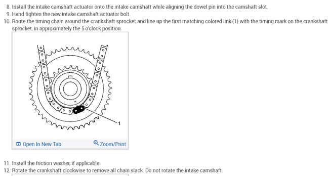

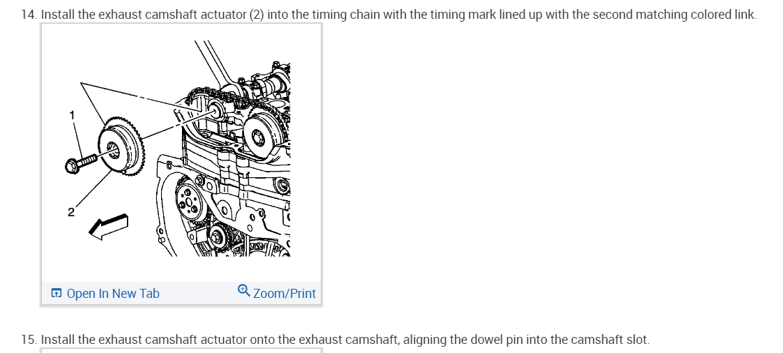

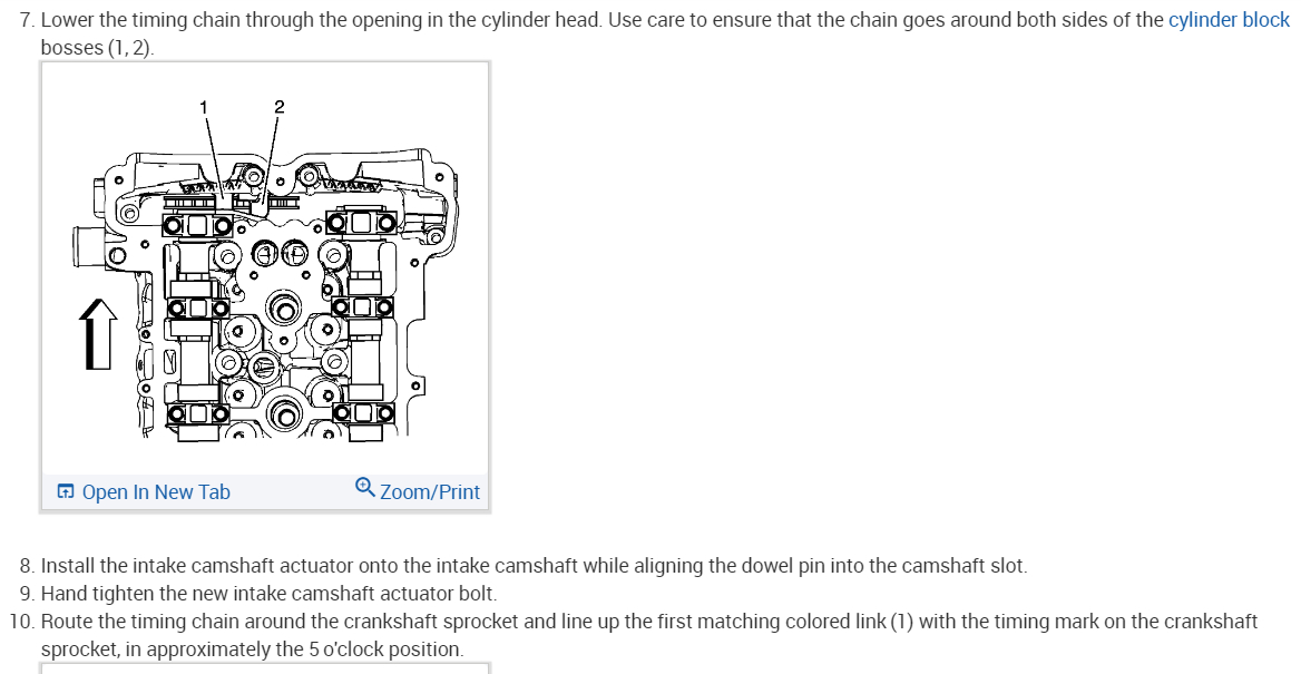

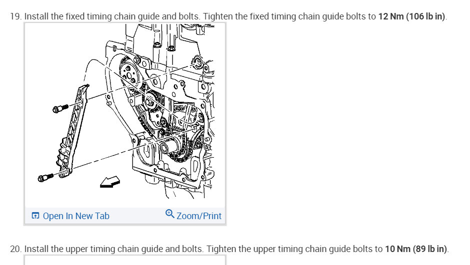

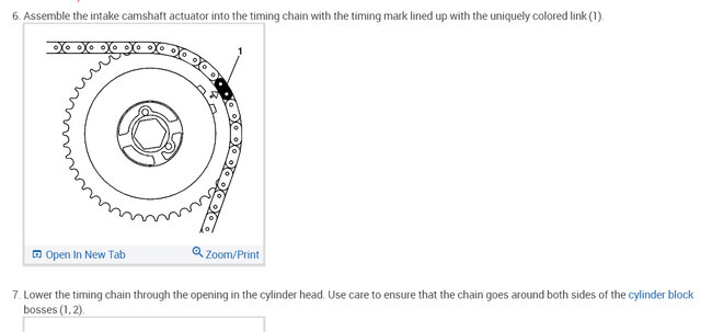

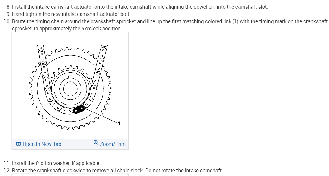

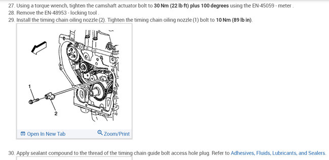

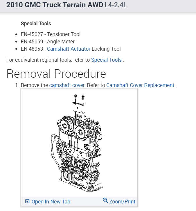

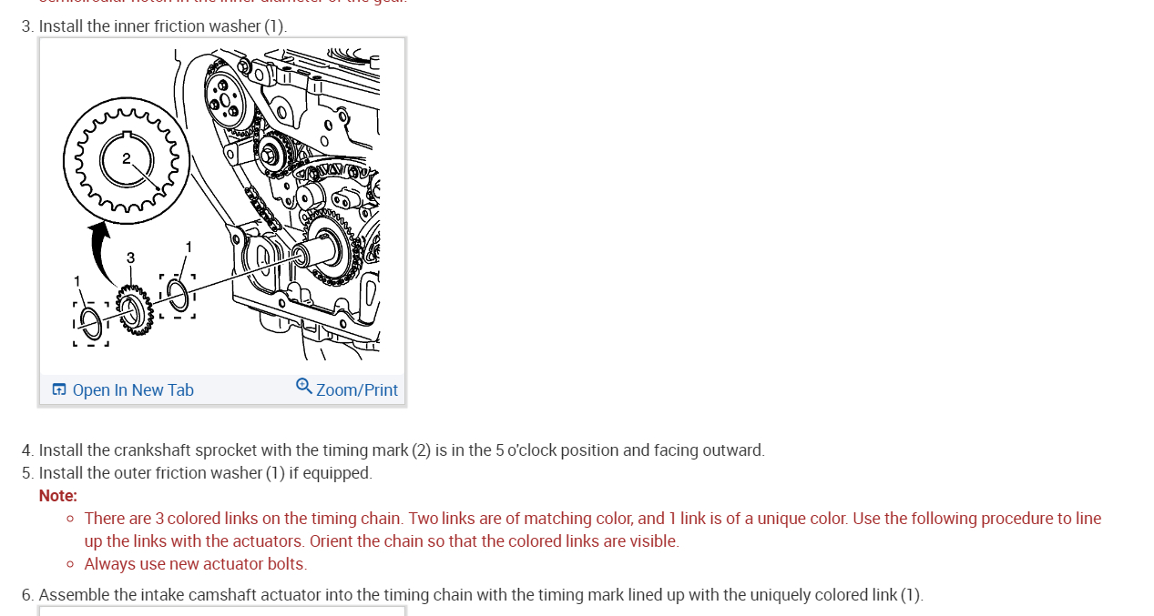

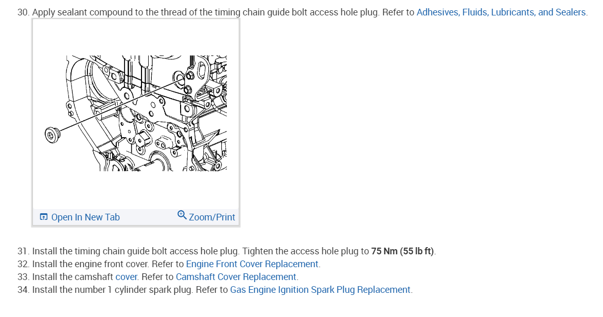

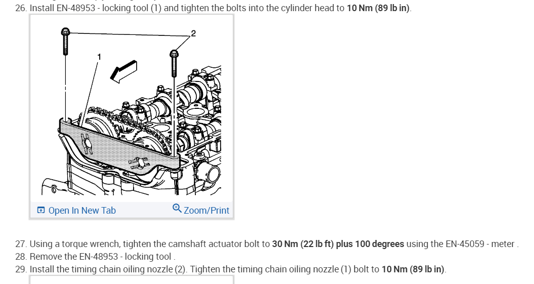

There is a procedure to get the timing of the crankshaft to camshaft correlation correct which I have included below. If you can confirm the timing is correct and you still get codes, please remove the camshaft oil control valve to see if any gunk/metal shavings have plugged the oil screen and the front of the valve.
P0011 - Camshaft Position "A" - Timing Over-Advanced or System Performance (Bank 1):
P0016 - Crankshaft Position - Camshaft Position Correlation (Bank 1 Sensor A):
P0017 - Crankshaft Position - Camshaft Position Correlation (Bank 1 Sensor B):
These two codes please start new questions for each code.
P0113 - Intake Air Temperature Sensor Circuit High Input:
P0742 - Torque Converter Clutch Circuit Stuck On:
Check out the images (below). Let us know what happens and please upload pictures or videos of the problem so we can see what's going on.

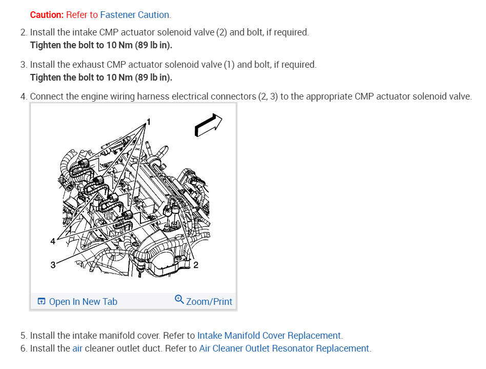

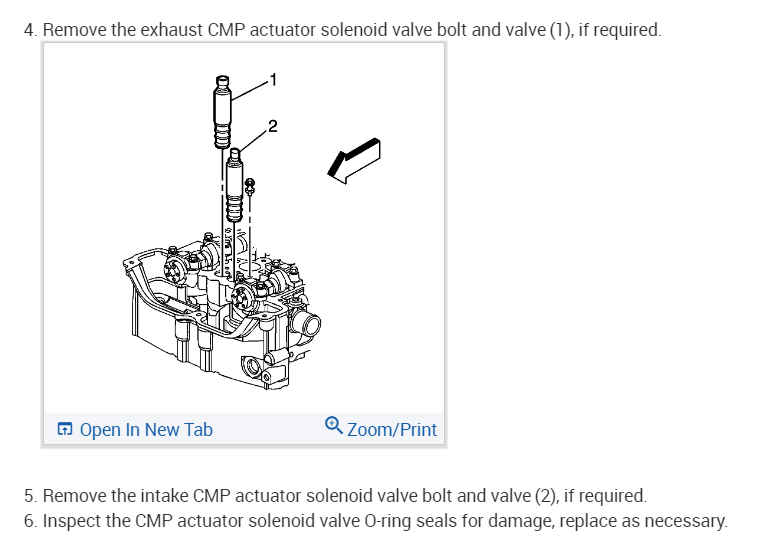

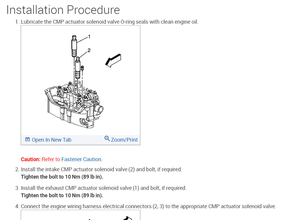

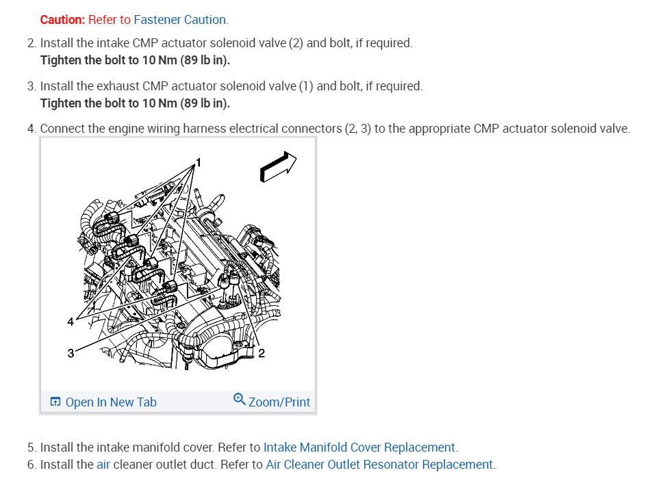

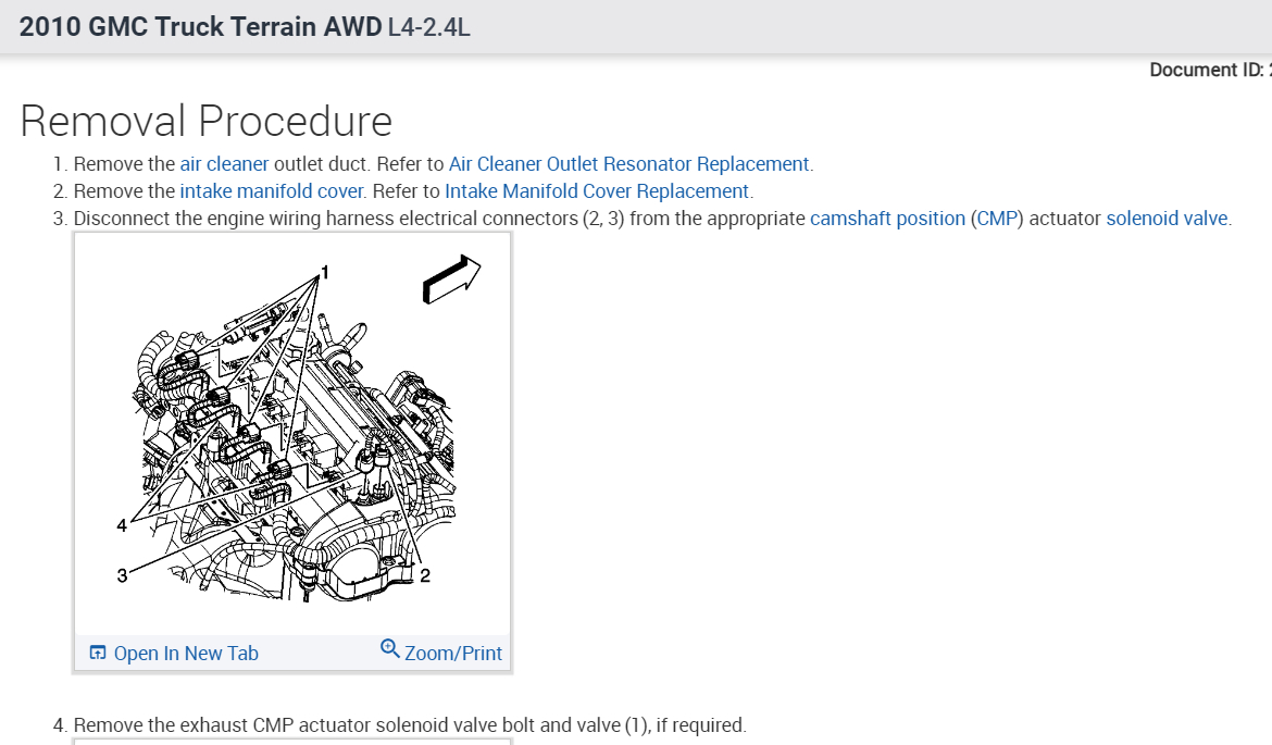

Here are the locations of the oil control valves of the camshafts. Check out the images (below). Please let us know what you find.
Sep 11, 2023 at 12:45 PM
Anything?
May 7, 2024 at 10:07 AM
KINGJD123
  • 104 POSTS
Yep, all good.
May 7, 2024 at 2:13 PM
Glad you could get it fixed, thanks for letting us know. Please use 2CarPros anytime we are here to help.
