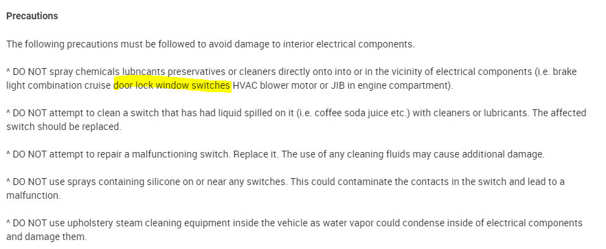

I ask because if you know how to cause it, we can remove one fuse at a time that powers the multiplex network to see if there is one that stops it from happening. I suggest that so we know if there is a short in one of the circuits.
Let me know. Also, when you removed and replaced the door lock actuators, did you use any type of cleaner, lubricant, or anything that could have provided overspray in that specific area? See the list below.
