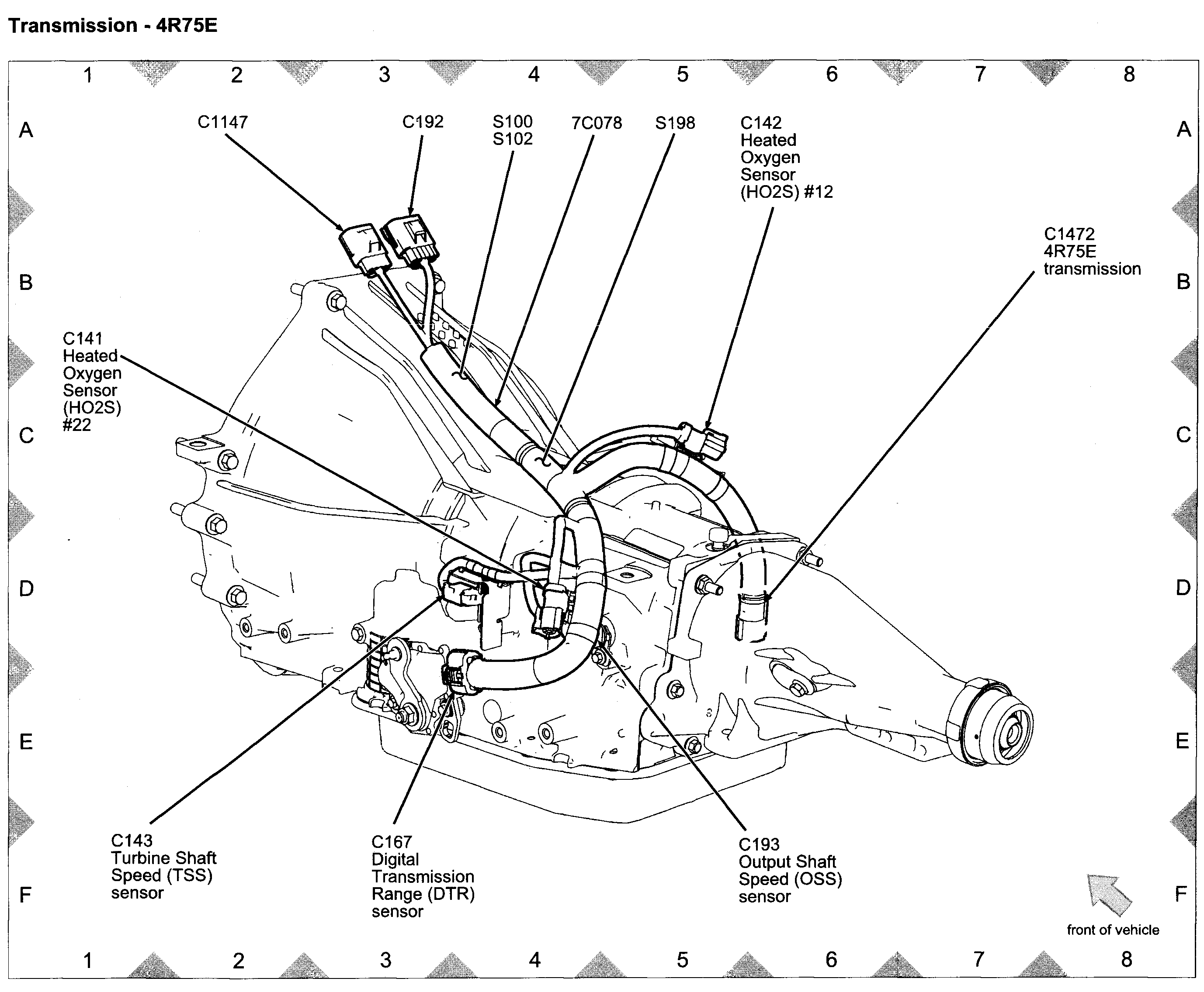

It sounds like a short to the vref circuit that is in the digital transmission range sensor. To verify this, the first step will be to retrieve the trouble codes from the power-train control module (PCM).
