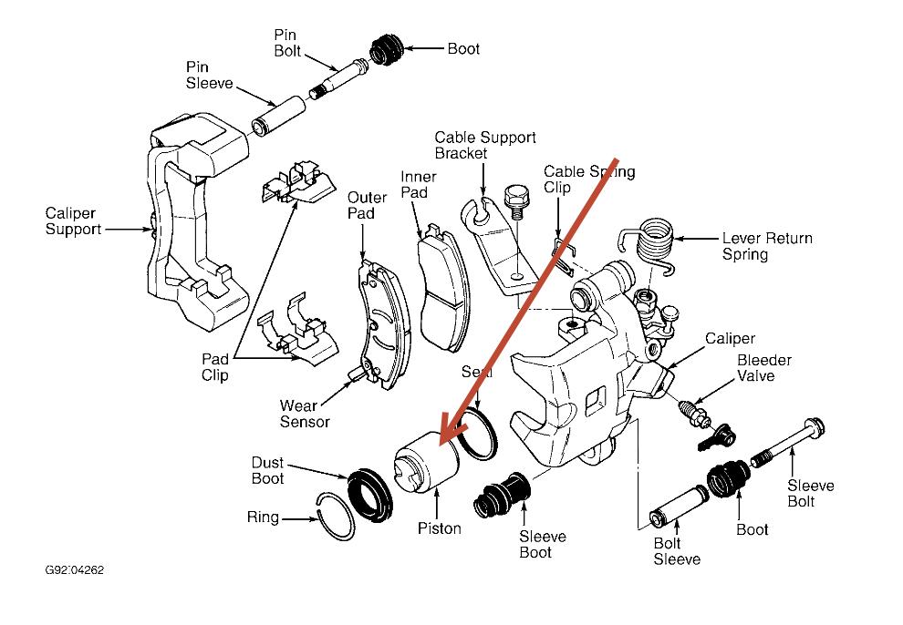

likei sadi in the first response uhaul has a tow rig that you jack up front wheels and the wheels don't turn so you can tow it behind a car. so all you need to do is get the back wheels free which you can pull each wheel and turn the piston backwards to release the parking brake then it can be towed pic included. you may need a tool to do this but auto parts sell these...
