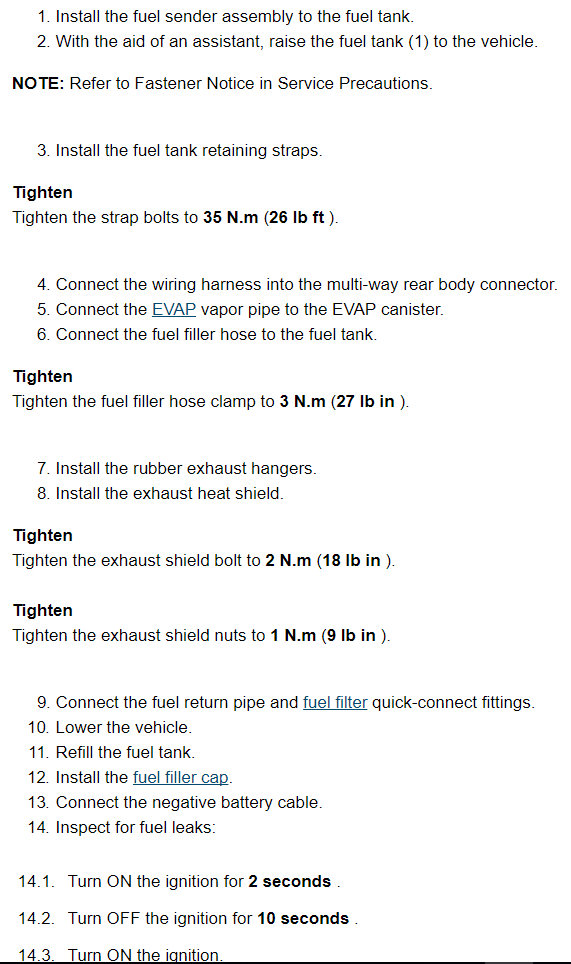

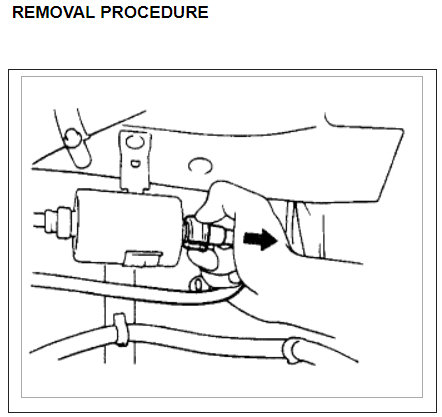

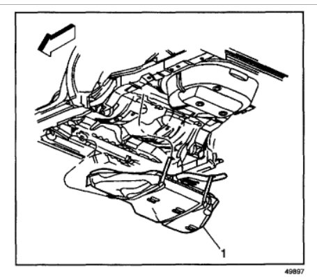

Here is how it will be for your car (below)
