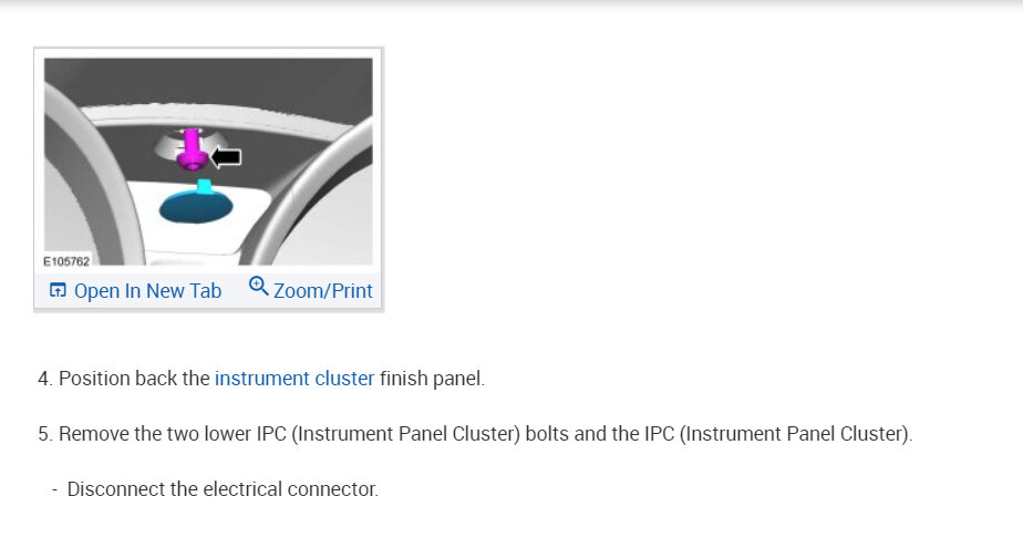

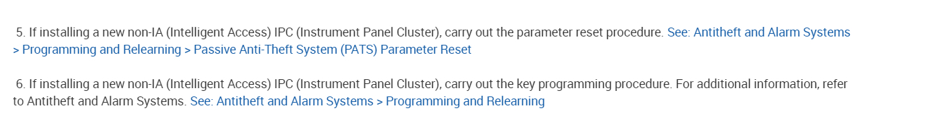

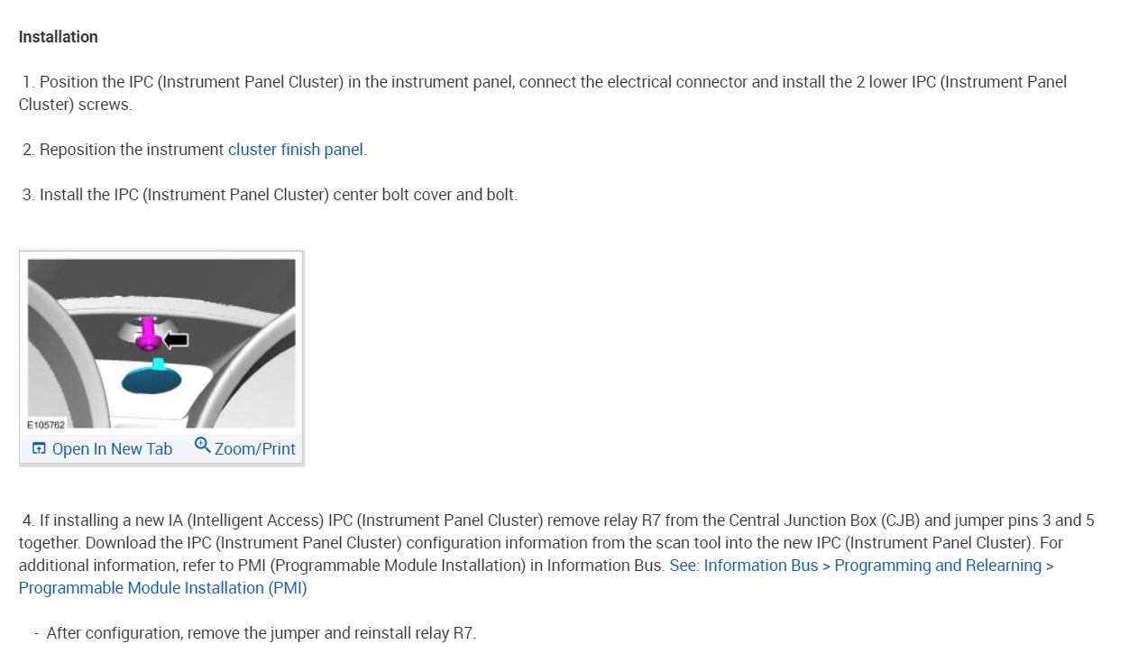

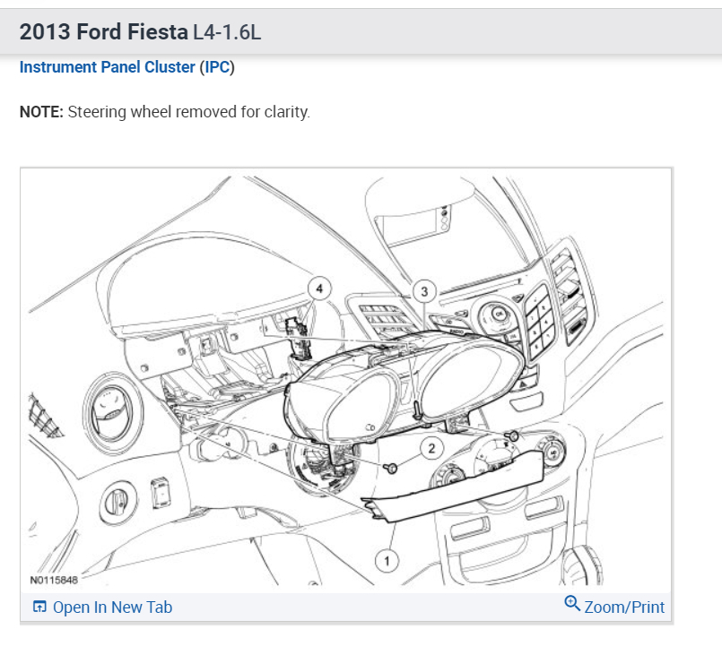

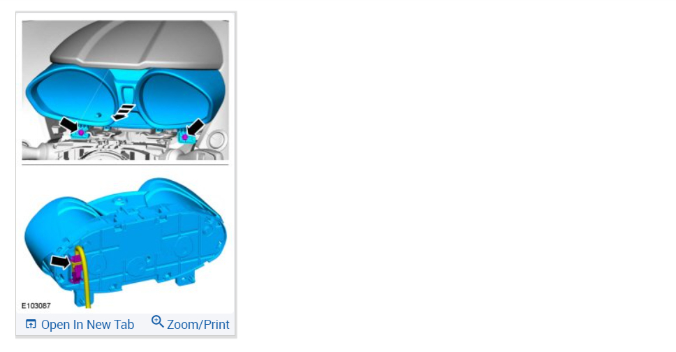

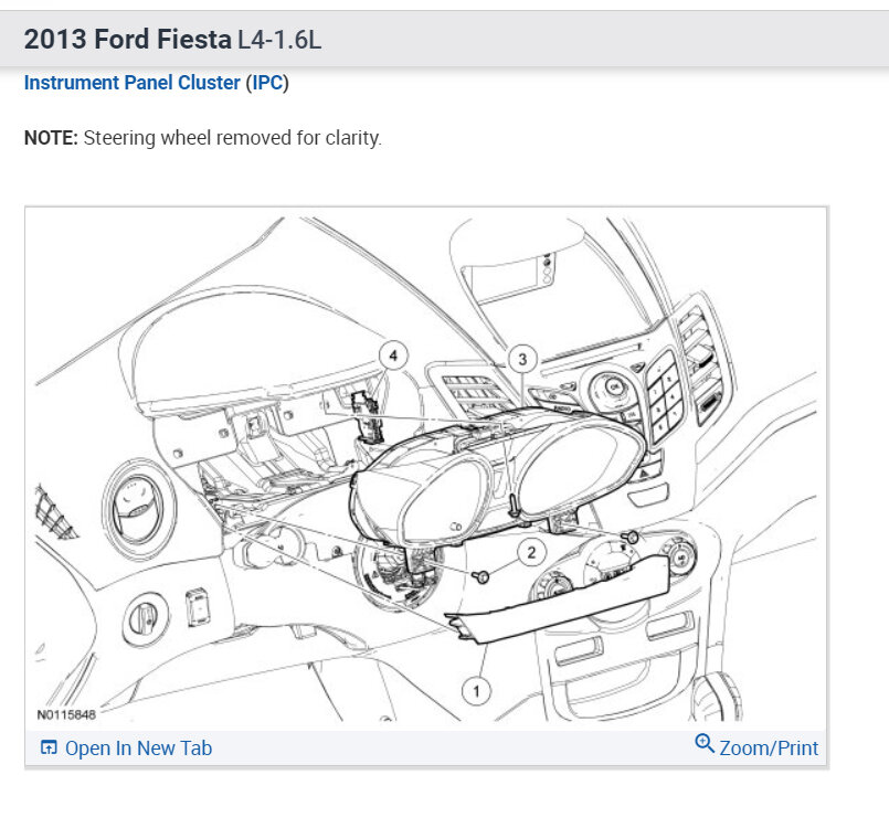

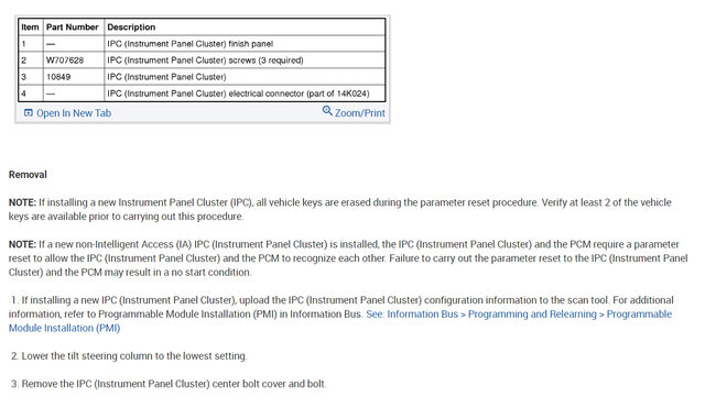

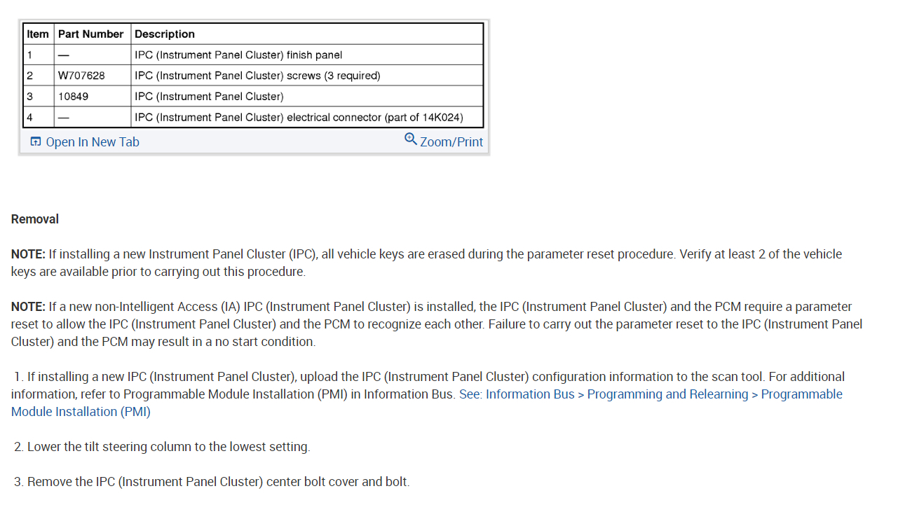

Here is how to change the cluster out and you can get a rebuilt cluster that is pre-programmed by searching Google or eBay. Check out the images (below). Please let us know what you find.
