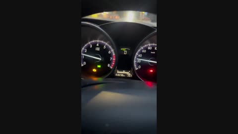

A month ago, I took my car into the mechanics as when I was driving my steering locked up every light on the dashboard turned on, i was going 30kmh and the revs were really high and loud. I had to pull over as my engine overheated. Well, the mechanics said it was the ABS pump, so I paid 900$ for it to be fixed. It took them a month with hardly any communication. Got the car back and on the way home it is doing it again.

Here’s a video of the lights.

Have you scanned the computer to see if there are relevant diagnostic trouble codes? I watched the video, and it appears there are stability control, ABS, and other related lights turning on. Is that correct?
If it is, this could be something as simple as a wheel speed sensor. If possible, can you have the computer scanned for diagnostic trouble codes? That will point us in the right direction. Most parts stores can do a general scan for you at no charge. However, we may be better off scanning the can-bus system.
CAN stands for controller area network. Basically, the different modules are tied together via a few wires. This type of scan will retrieve codes from any module storing codes. In this case, it may be the ABS module.
Here is a link that shows how it's done:
https://www.2carpros.com/articles/can-scan-controller-area-network-easy
Let me know if that is something you could have done. Also, if you have a scanner that can read live data, check the wheel speeds when the vehicle is moving. They should be at the same speed.
