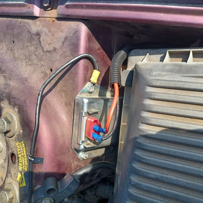

I installed an external voltage regulator because PCM was not controlling voltage to battery. I noticed that, after I installed it, the dash lights and headlights were pulsing. I have checked the ground and tried different locations for sourcing power, but have not had any success correcting this issue. Any advice will be appreciated.

What kind of regulator did you use? Chrysler's 1970s unit is what is commonly used. Did you do any diagnostics on the system before modifying it?

You do have the common regulator used for this modification. I did the same thing on my skid steer. While the setup will get the job done, there are some technical problems with it. This was the first electronic voltage regulator, first used by Chrysler on 1970 models. They have a really long list of "firsts" that truly benefitted car owners.

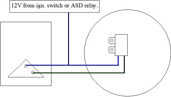

The second thing to be aware of, while likely not the problem here, is this regulator has a third, very important wire. That is the ground made through its metal housing. Relying on the bolt threads is not the best idea. Instead, consider scratching a clean surface through the paint to get the best possible connection. To check the connection, use a digital voltmeter on the lowest DC volts scale, then measure the voltage drop between a clean spot on the housing and the battery's negative post. Since mechanical connections are involved, there will be some slight voltage drop, but it should be in the order of millivolts. I'd expect to see less than perhaps 10 to 20 millivolts. If you find more than that experiment with additional ground wires between the engine and body sheet metal, and between the body sheet metal and the battery's negative cable. That will be the smaller cable of the two in the negative cable clamp.
The next concern has to do where you're getting the 12 volts to run the regulator. The Engine Computer usually has four 12-volt supplies. One is constant to maintain learned fuel trim numbers, sensor personalities, and any diagnostic fault code data. A second supply from the ignition switch turns the computer on. There may be a third supply that gets switched onto one of the outputs to turn on the automatic shutdown, (ASD), relay. That relay feeds 12 volts to the ignition coil(s), injectors, fuel pump or pump relay, oxygen sensor heaters, and it is the fourth 12-volt supply going back to the computer. That is the 12 volts the computer looks at to monitor system voltage. By monitoring the ASD line, it maintains steady voltage to everything that makes the engine run right. The lighting circuit comes along for the ride. It will be stable as long as the engine controls are stable.

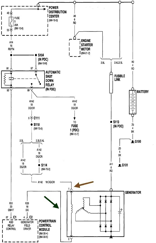

If your regulator circuit in the computer is open, meaning a break in the circuit, you will find exactly the same voltage on both smaller terminals. There's no current flow through the field,coil, so no magnetic field is being developed, and with no current flow, no voltage is dropped across it, so you end up on the second terminal the same as you started with on the first one. This is the condition you're trying to solve.
In this diagram, you'll see the feed wire to the field coil is dark green / orange. The "control" wire is dark green. In this story, we've determined the field circuit is open, and it appears you correctly found the defect is inside the Engine Computer. Before going through the work of the modification, (or spending our customer's money), we had better verify the alternator itself is okay and doesn't have an additional problem. A real fast way to do that is with a "full-field" test. All that involves is grounding the dark green wire while the engine is running. Be aware this is definitely no time to raise engine speed. Doing so has the ability to send system voltage well over 30 volts, enough to destroy multiple computers and burn out any bulbs that are turned on. Alternators and generators are very inefficient at low speeds, but if working properly, they will develop plenty of increased voltage to be seen. Monitor battery voltage, or watch the brightness of the head lights when you ground that wire. If voltage goes up, the alternator can be said to have "not failed". It still may not be working to full capacity, but that's a story for another day.
Next, I get to discuss some problems with this dark green wire. This same circuit was used on Dodge Shadows. We had three of them, donated by Chrysler, to my community college, that I used for training. On those models, there was an inline connector halfway between the computer and the alternator. I never did, and never allowed anyone to pierce wire insulation to take measurements. Instead, those connectors made dandy test points. That is a perfect place to touch a jumper wire, and to ground, to full-field the system. If you don't have an inline connector, or know where to find it, you're presented with a new problem. You can do this test right at the back of the alternator, however, both wires go through a black plastic block and emerge as two thin tabs bolted to the two small terminal bolts. When the system is working properly, it's easy to tell which tab goes with which wire by the voltages. It's when you have your problem of an open circuit, both voltages will be exactly the same. Which tab do you ground to perform the full-field test? If you try the correct one first, charging voltage will go up. If you grab the wrong one first, you'll blow the fuse feeding the ASD circuit. No harm done, but it is embarrassing. I do have a relatively simple trick to figure out which is the correct terminal to ground, but I can't give out all me secrets at once.

There's two more things to consider. The first is when you added the external regulator, the one to the computer has to be disconnected. The one with the lower "target" voltage will overpower the other one, then the two will fight each other. The most likely symptom of that would be those pulsing lights. A second issue, somewhat hard to explain, is controlling the charging system is not actually done by holding field coil voltage constant. Instead, it is switched from full-on, (maximum output), to fully-off, (no output), about 400 times per second. The percentage of "on-time" to "off-time" is adjusted to change the average output voltage. The resulting pulsing is smoothed out by the battery. (That's another sore point with GM charging systems and repeat generator failures). The external regular switches the same way, called "pulse-width modulation", or "pulse-width dimming", and is why such a tiny, lightweight transistor can control such a high current. Switching current flow off through a coil of wire sets up a huge reverse voltage spike. That's highly desirable in ignition coils, but aged batteries in GM vehicles can't dampen and absorb those spikes. Those spikes are what destroys a lot of their generators and causes elusive engine running problems. On your car, if the original regulator is still in the system, one regulator might be switching on while the other one is switching off. With two different target voltages, the alternator is responding to two different commands. Just like when you would hear a whistle when tuning a really old AM radio, if one regulator is switching at 400 cycles per second, and the other is switching at 399 cycles per second, they'll go in and out of sync and you'd see that as a pulsation of the difference, or one cycle per second.
That's getting way more technical than necessary to solve this. First, be sure the internal regulator is not connected at the same time. If you aren't sure, just unplug one of the wires on the external regulator. If the charging system keeps working, there may not actually be anything wrong with the computer. For my better comment of value, given the age of the car, I would seriously consider finding a used Engine Computer from a salvage yard. There will be plenty in the pick-your-own-parts yards. Do a search for "Pull-A-Part" to see if there's one in your area. I've been to 16 of them. All are very clean and well-organized. The last computer I bought for one of my vehicles cost $25.00.

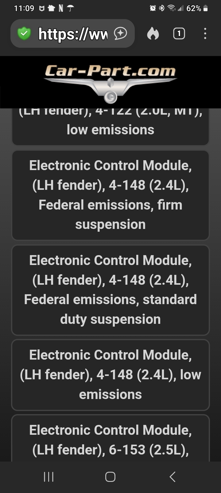

I think I will go back to square one. I am going to reconnect ecm and re-test. However, I have a couple of questions. When I connected external regulator, I cut the two small wires that go to plug on back of alternator. I then tied external regulator to that plug. This takes regulator in ecm out of the loop, correct?
The other questions I have are in regards to buying a used ecm.
The options I see online ask if I need:
Low emissions vs federal emissions.
Firm suspension vs standard suspension.
Also, would it need to be programmed or can I just match part numbers?

First question. Yes, if you cut the wires, the internal regulator is removed. The two on the external regulator go to the two on the alternator. No polarity, meaning either wire can go to either terminal. Then the entire modified charging system needs a 12 volt power source. I put this drawing together to show it better. On '70s and '80s models, for all cars and most trucks, every dark blue wire under the hood got 12 volts switched onto it when the ignition switch was in "run". By the mid '90s that 12-volt wire was commonly dark green / orange. On the voltage regulator, that 12-volt wire is the one at the top peak of the triangular plug, like in my sad drawing. (For some '80s trucks, that 12-volt wire was often red).
The emissions is basically one system for vehicles sold originally in California. The federal system is for the other 49 states.
I've never heard of a different Engine Computer based on the type of suspension. Unless you're aware of some type of optional sport package, assume you have standard suspension.

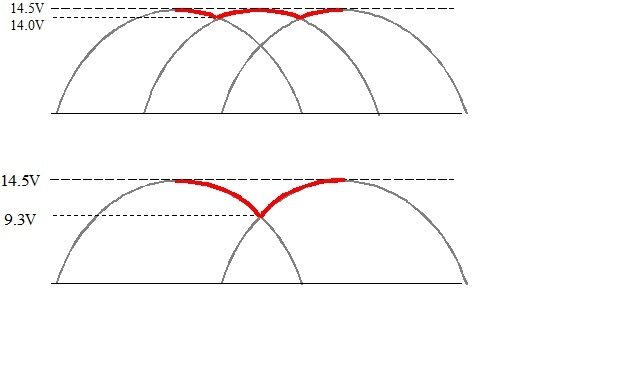

The first problem is the battery is needed to assist the voltage regulator in doing its job. All AC generators put out three-phase output, similar to what's found in large factories. After it passes through the internal "diodes", one-way valves for electrical current flow, it looks like the top waveform in the drawing below. The "ripple" voltage shown here as 0.5 volts, (the difference between 14.0 and 14.5 volts) is very easy for the battery to smooth out. In fact, the battery is preventing it from going much above 14.5 volts.
When a battery cable is disconnected while the engine is running, that ripple voltage increases and the peaks could easily go to 16 to 18 volts. That voltage goes right back around to run the field coil. With a higher voltage, you get higher current and a stronger electromagnet. That causes a higher output voltage to be induced resulting in higher output current. That cycle continues until it's very easy to reach well over 30 volts. For demonstration purposes this has to be done on a generator test bench because on a vehicle, 30 volts will destroy most of the computers, any bulbs that are turned on, the diodes in the alternator, and on GM generators, the built-in voltage regulator. The only thing that can save it is all generators are very inefficient at low speeds. Raise the motor speed on the test bench and that 30 volts is reached and exceeded in a heartbeat. Once the smoke comes out, you can't put it back in.
Without the battery in the circuit, the voltages in my top waveform are more likely to be 12.6 volts and perhaps 16.0 volts. Some voltage regulator designs operate by looking at the 12.6 volts. They increase generator output in an attempt to get that up higher. As they do, the 16 volts goes to 18 or 20 volts, but the regulator keeps seeing and responding to that 12.6 volts. Stuff gets burned out.
Other regulator designs look at the 16.0 volts and cut back on generator output in an attempt to get that down. Without the load of the battery to help with that, it can't cut back far enough. It keeps dropping and dropping field current until there's insufficient output current to keep the engine running. Injectors and electric fuel pump alone take over ten amps. The engine stalls, giving the false illusion the generator is not working.
