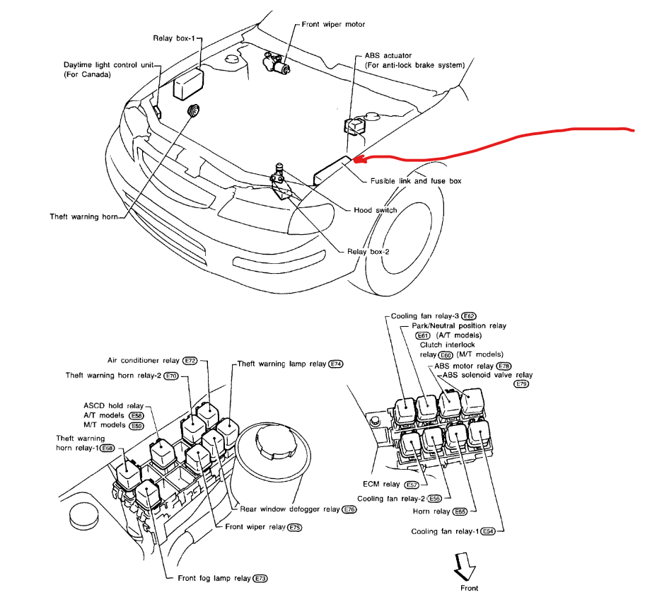

The car starts and runs but interior electrics fail gauges, blinkers, power windows, heater, sunroof, everything goes flat.

There is a fusible link F that needs to be checked. Here is a guide to help you test the link and the location as well in the images below:
Image (Click to enlarge)
