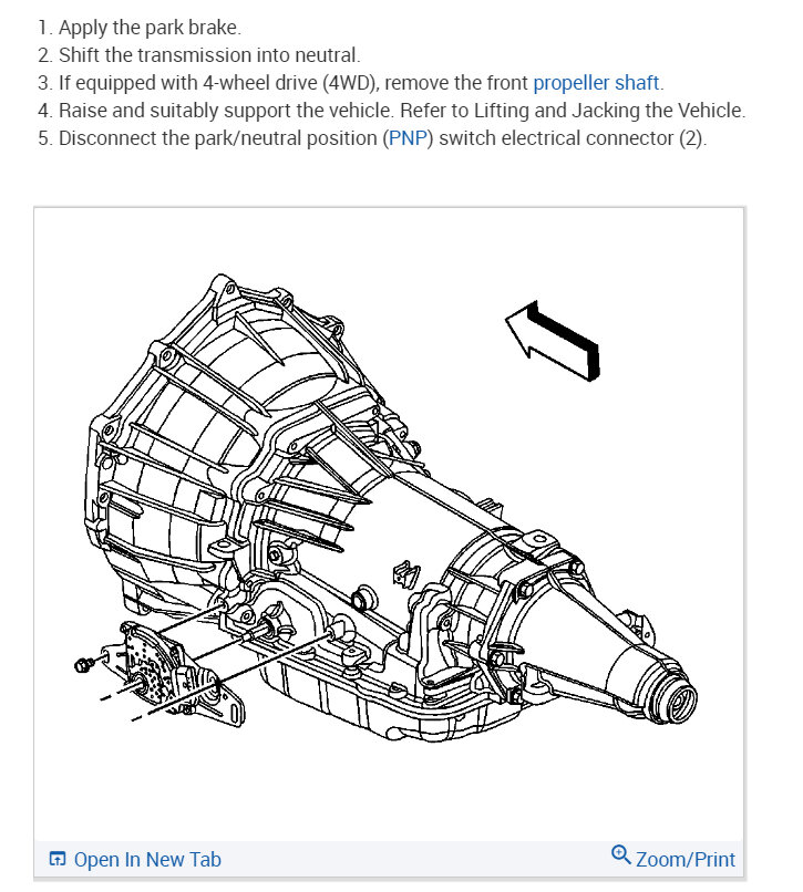

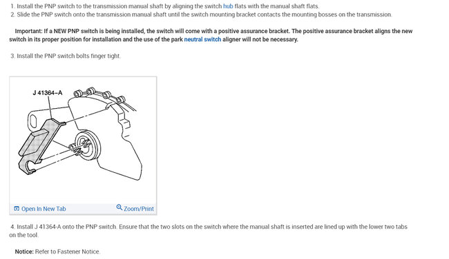

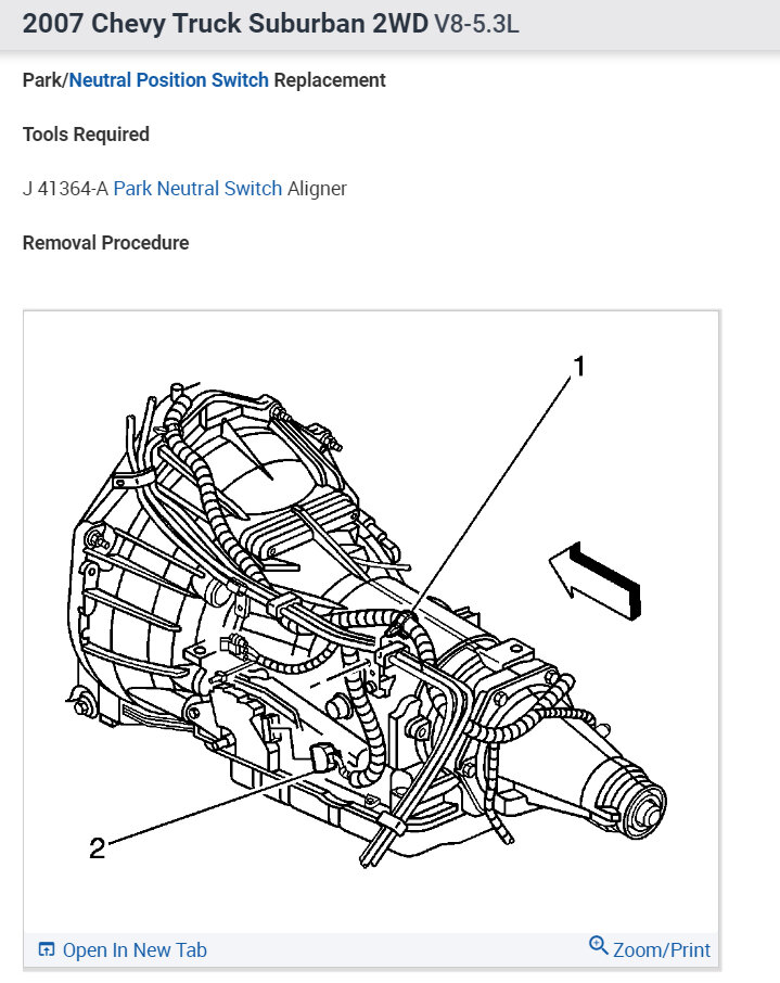

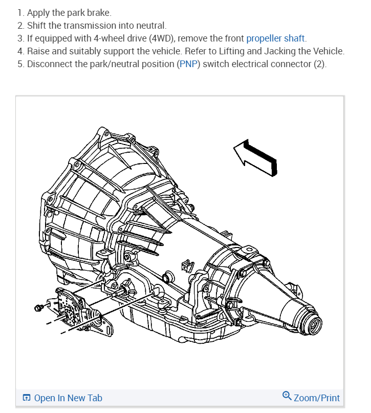

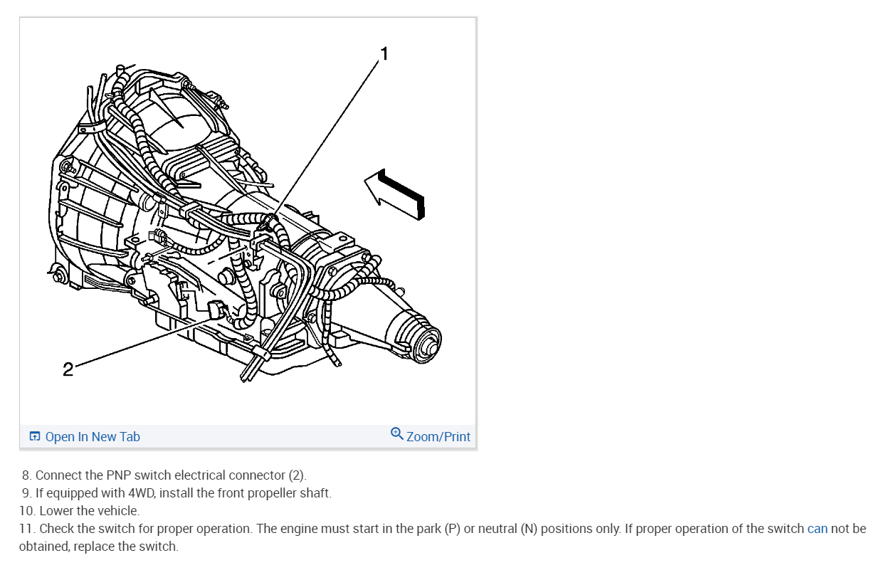

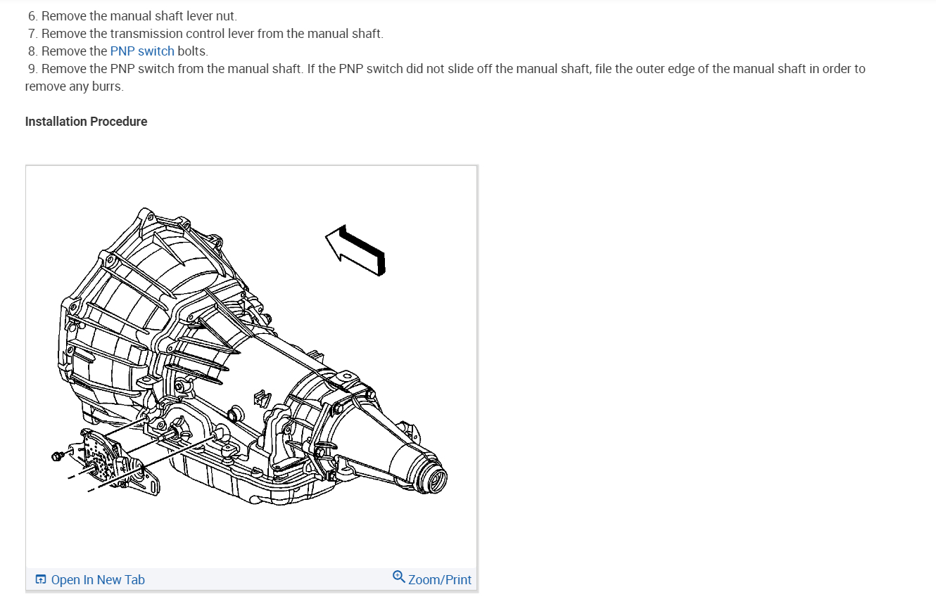

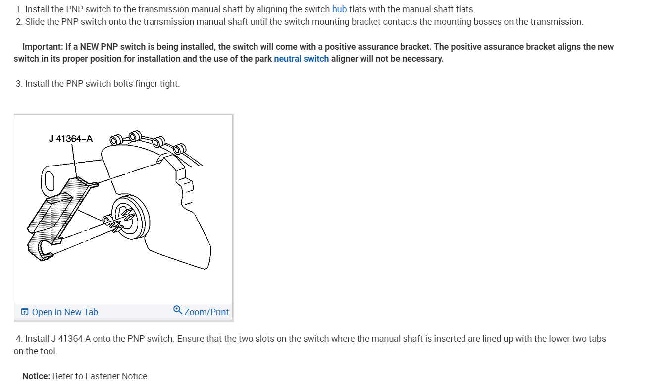

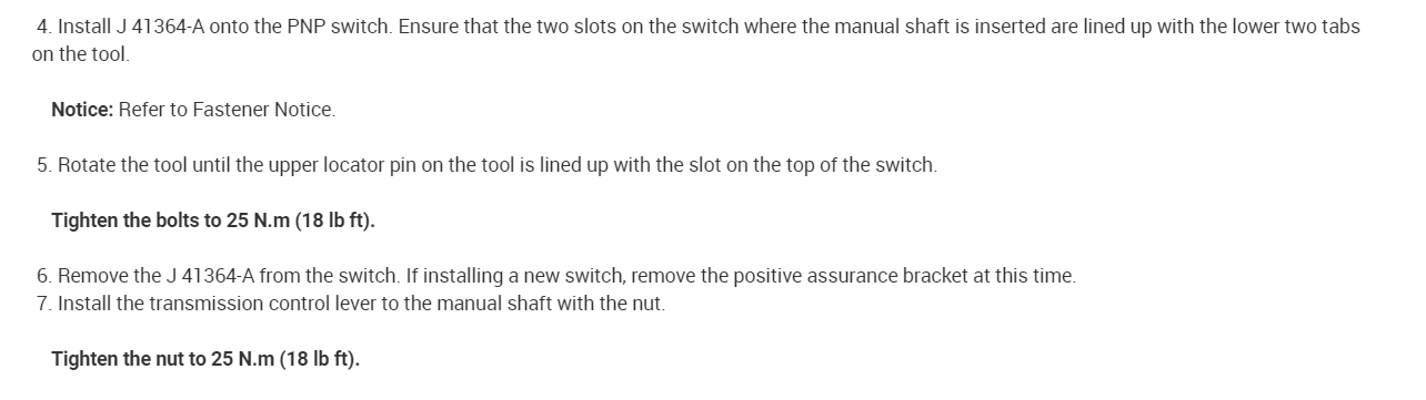

When you put the transmission into drive, does the "D" light up on the dash? If not, then the gear range sensor needs to be replaced. Have you run the codes to see what comes up?
Here is a guide to help:

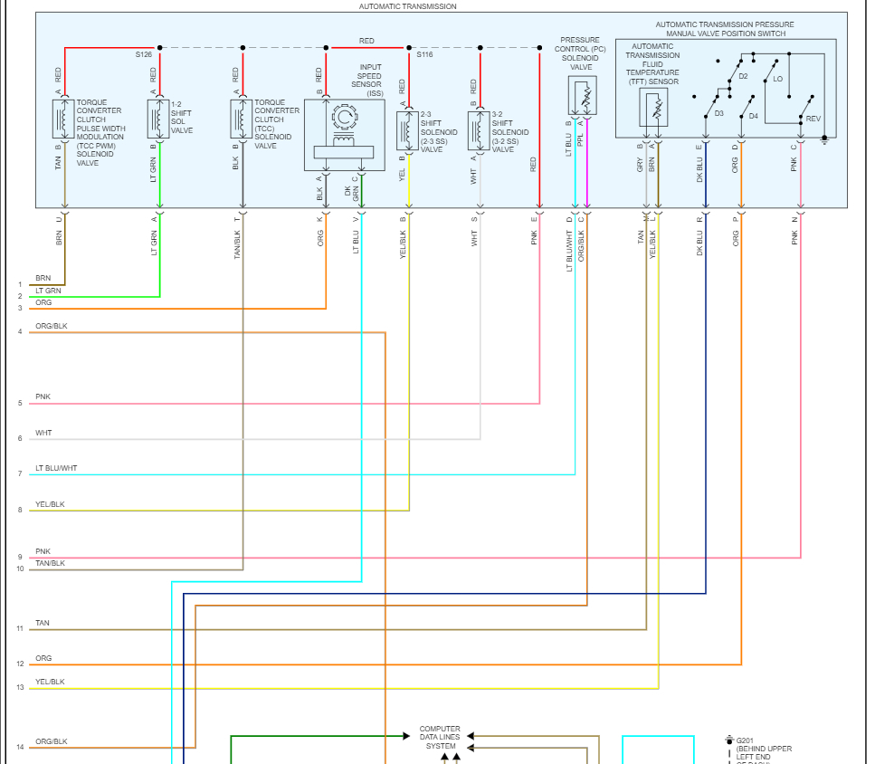

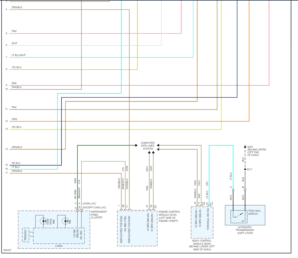

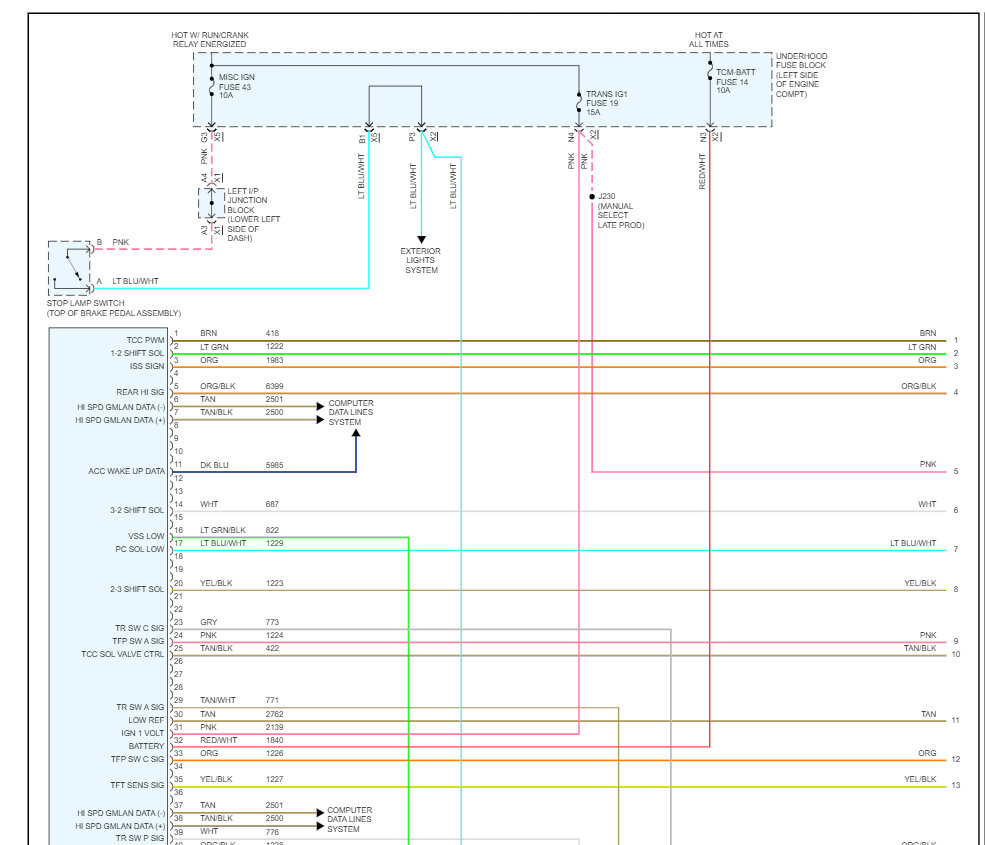

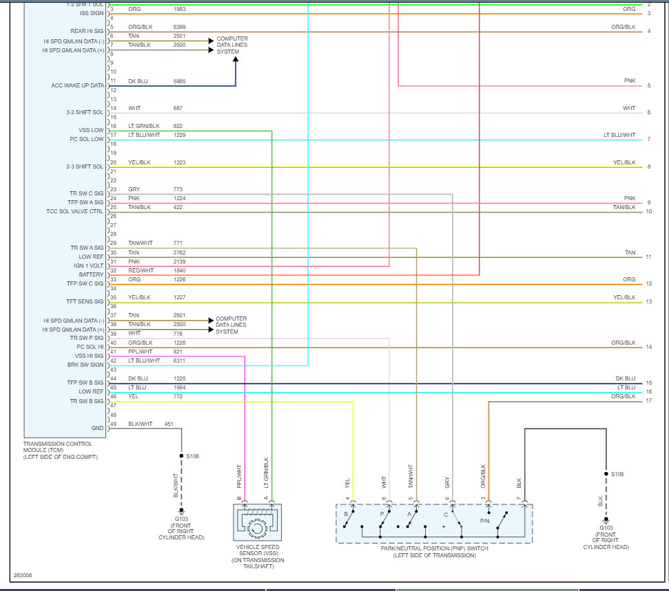

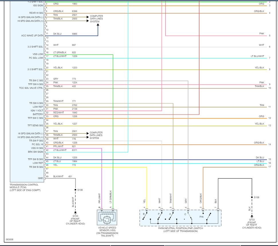

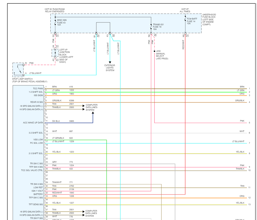

Also check the fuses# 34, 19 and 14 in the under-hood fuse panel. I have included the transmission wiring diagrams so you can see how the system works.
