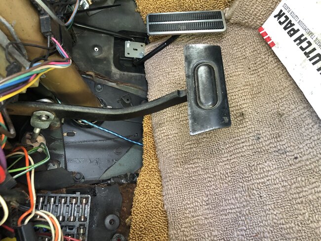

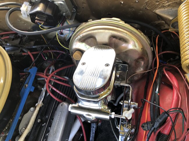

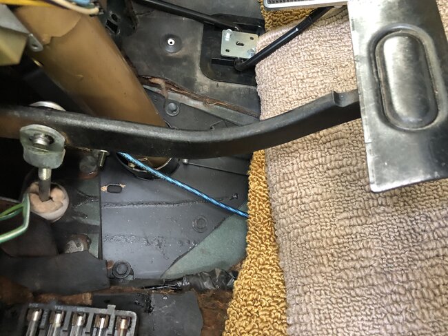

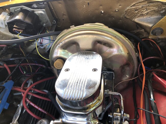

DONALD OGLESBY

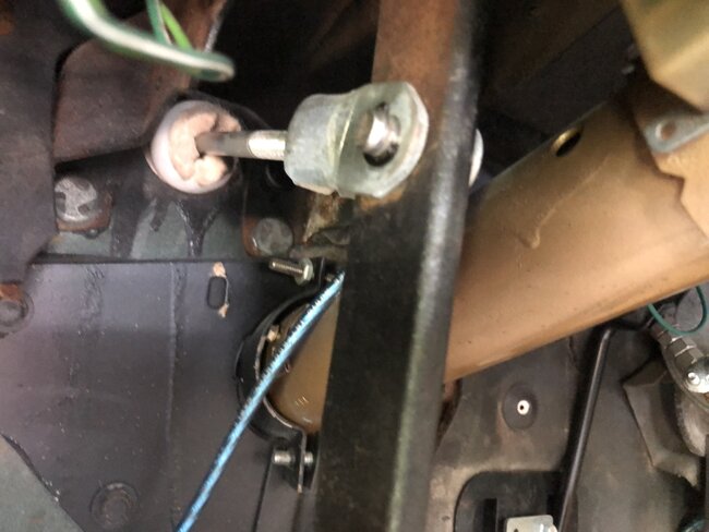

Are you speaking of the Rod that attaches the brake pedal to the booster? The only adjustment is under the dash where it attaches to the brake pedal. It has a nut on it. Very little adjustment at the pedal. No adjustment at the firewall in the engine compartment.
May 2, 2023 at 9:34 AM
Thanks for the images. The rod I am talking about is between the booster and the master cylinder. Did you try to loosen the master mounting bolts to see if the system depressurizes? If not, the master cylinder is bad, and you need another one.
