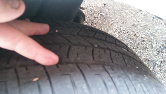

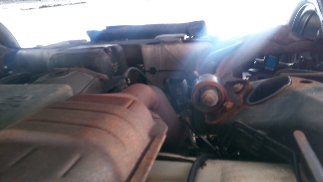

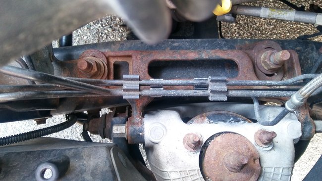

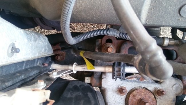

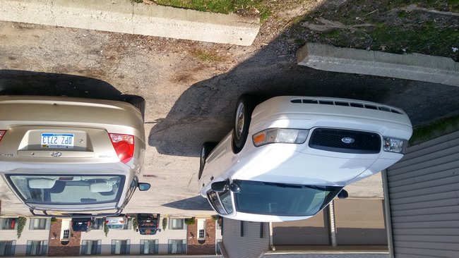

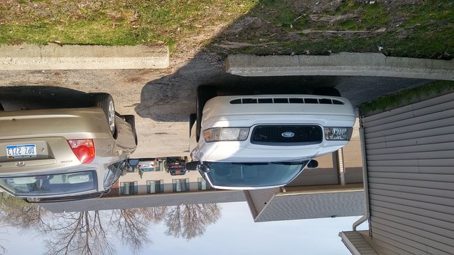

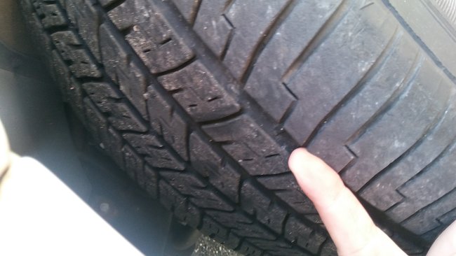

My car has goodyear eagle m+s tire with traction and temp rated at A and the speed rating of 98w. I will send before and after pics once its aligned so you can decypher the readings. I have some pics of front alignment adjustments and tire wear if you can tell anything from just that.
1. Front. Dr. Side tire
2. Front pass. Side tire
3. Dr. Side lower c arm
4. pass. Side lower c arm
5. Dr. Side lower c arm bushing( both pass. And dr. sideshave the mounting bolt offset from middle and shifted towards pass. side. Pic isnt great. Anyways do these need replacing?
Both pass. side tires have same wear, and the dr. side both have same wear. This doesnt make sense to me unless the po rotated them that way for to fix the cars pull. But the car pulls a tiny bit to the right that is a** backwards.
Thanks again for bearing with me. I wont bother you again until i get it aligned lol

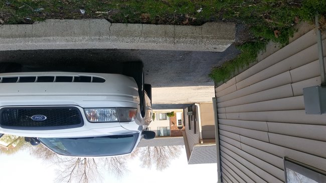

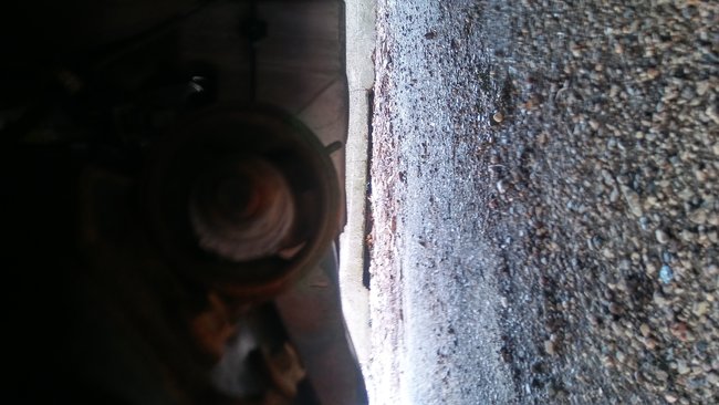

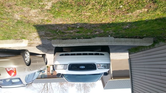

I forgot these pics. I know its not sitting even or if the different is visible to you via camera orientation so it might not help. It was windy as heck outside and blowing dirt in my eyes so I didnt get the best pics. Dont know why they are upside down.

Photos 3 and 4 should be the upper control arms. The slotted areas under the nuts are the inter-related caster and camber adjustments. This type of adjustment was common on older Fords and Chryslers. It's not abnormal to find one of these adjustments all the way to the end of its travel, but if you find both of them on one side adjusted as far as they can go, and you need more adjustment, that's the time to suspect sagged ride height.
Direction wheels are leaning and steering is hard to tell from photos. The biggest problem has to do with the rounded body panels. Your front fenders can make a front wheel appear to be turned out to that side. We used to sight along the front and rear of the sidewall, then extend that line of sight to the rear tire, but even that can be misleading. A lot of models have front wheels that are further apart than their rear wheels. I've run into that too many times when I thought something was badly out-of-adjustment, but found everything to be fine according to the alignment computer.
