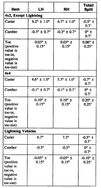

i need front end alignment specs.
Sep 26, 2019 at 7:07 PM
BMDOUBLE
CERTIFIED EXPERT
1,139 POSTS
Here you go.

Thank you so much. i have been online for two evening's trying to find this information. Next time i have a mechanical question i be coming to you guys.
