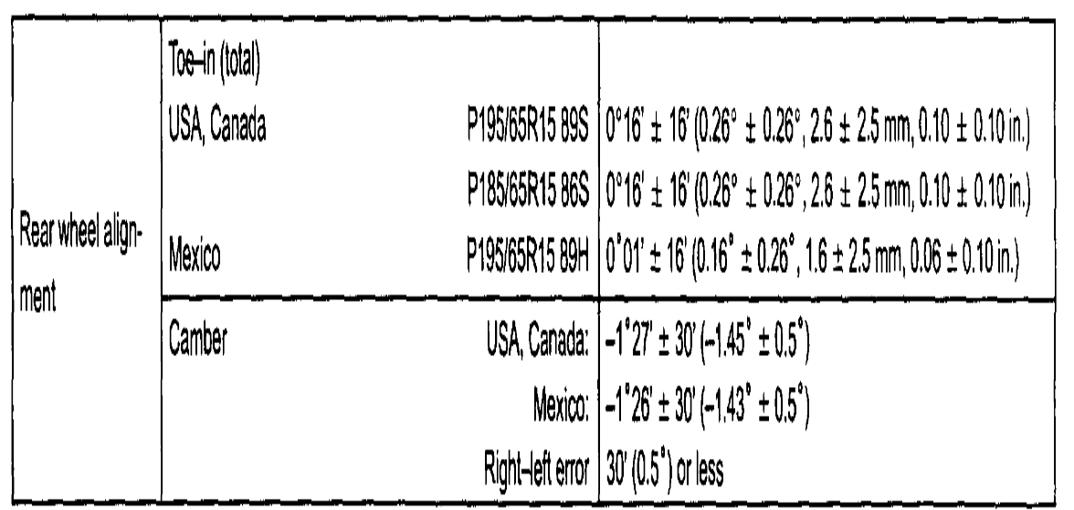

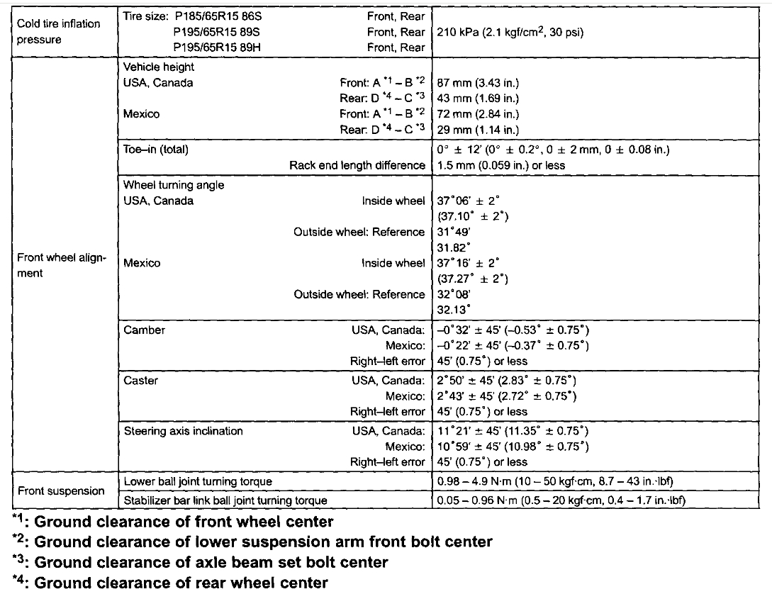

I would like to know alignment specifications (toe, camber, caster) for my car. Also, I would like to know are camber and caster adjustable for front wheels. And are toe and camber are adjustable for rear wheels? also, i would like to know the track width front and rear.

Sure, here are the alignment specifications for your 2004 Toyota Corolla. Check out the images (below). Let us know if you need anything else.

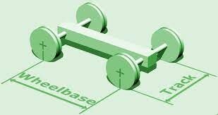

I need to know the distance between the rear wheels and the distance between the front wheels. they call those track width of the front and track width of the back.

Sir,
What I need is shown in the picture. it says "track" for the front two wheels and the rear two wheels.
Thank you
Mar 28, 2024 at 7:43 PM
Sorry, I never had anyone ask this question before. I couldn't find the exact front and rear track measurements in the sources I accessed.
