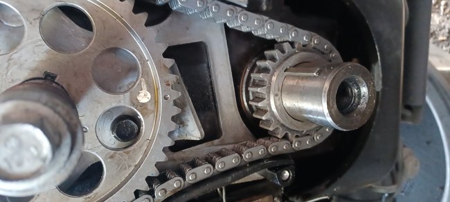

I like to see my engines run before I button everything up. If you can run the engine for even a few seconds with the timing cover off, you'll have confidence in your work as you're putting everything together. This will be with no water pump, alternator, power steering pump, and given enough time, oil spraying around.

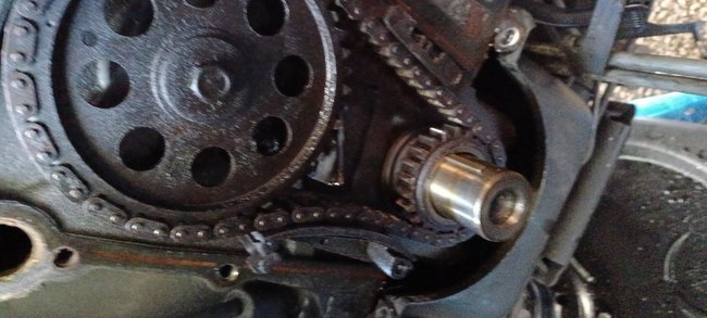

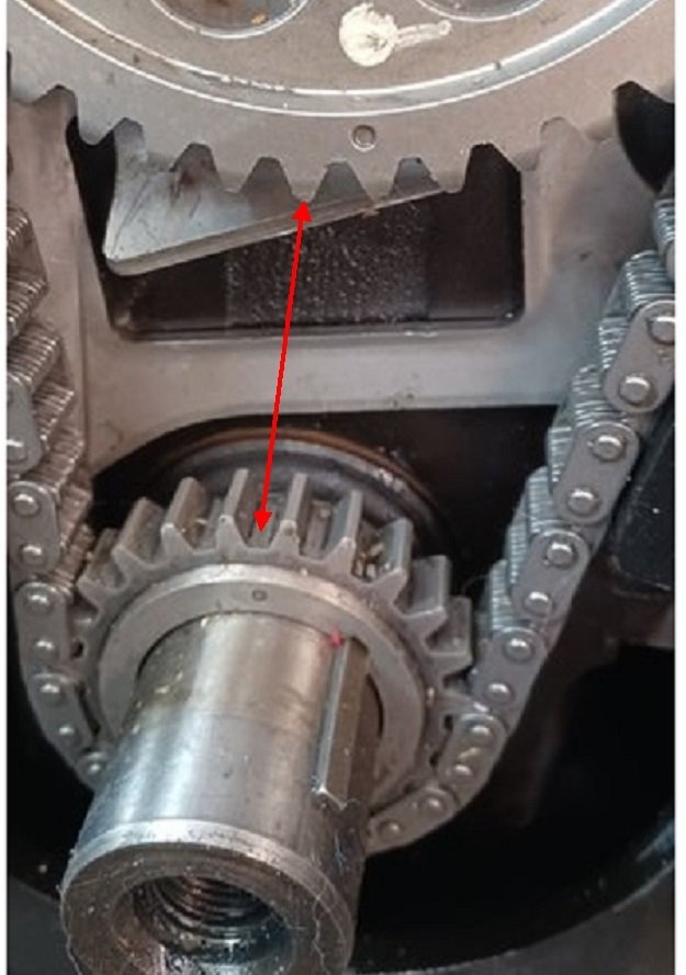

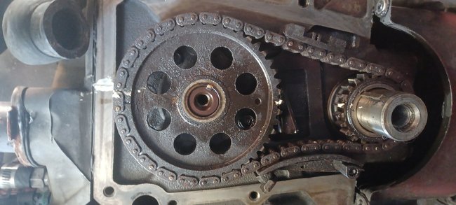

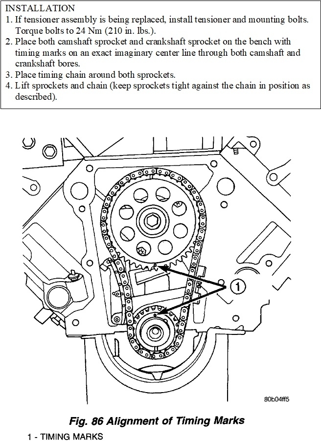

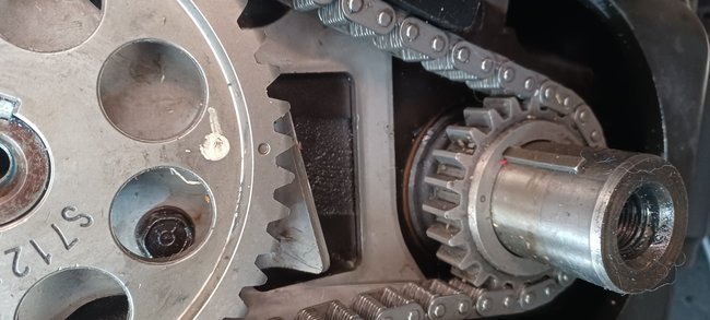

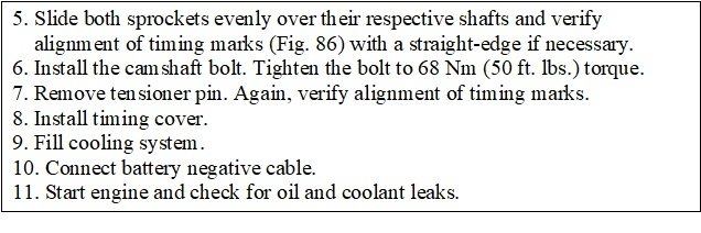

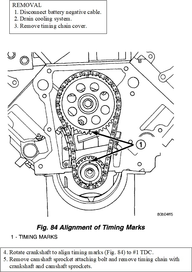

After you do enough of these, you become confident, and even complacent, and tend to stop paying such close attention to detail. That's when things go wrong and you have to take things apart again. The good news here is you don't have a lot of new technology to make this a confusing job. This is just a basic 318 c.i. with two cylinders lopped off. 318s never had the fiber tensioner on the side of the chain. Regardless, you're still looking for the same thing. Rotate the crankshaft by hand with a socket and ratchet two times, then recheck the timing marks. That's clockwise as you're sitting in front and looking at the front of the engine. If you're ever confused on another engine, just look at where the crank sprocket is pulling the timing chain tight, (right side in this case). When you're turning it the right way, all of the slack in the chain or belt ends up on the side with the tensioning device.
