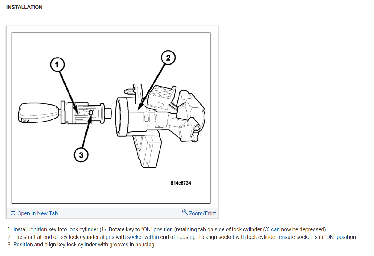

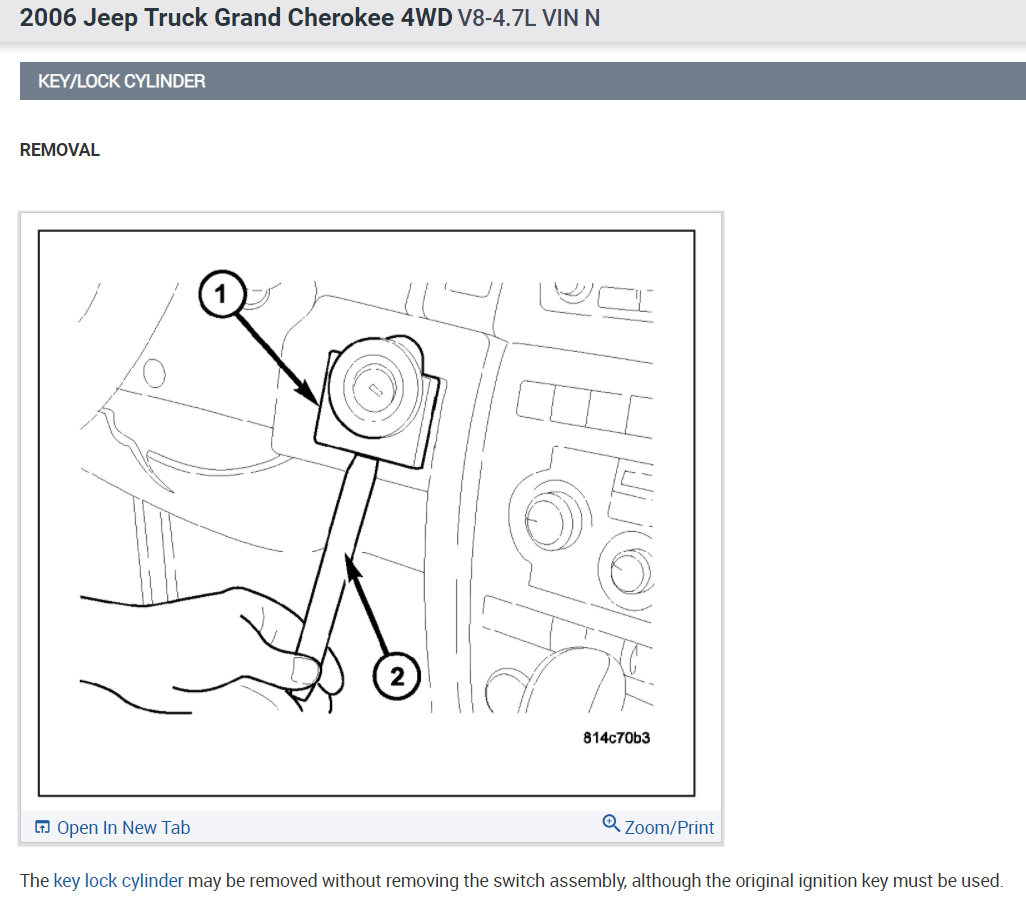

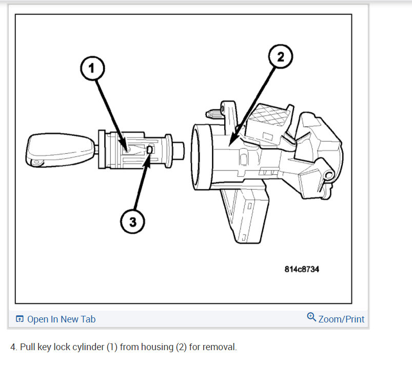

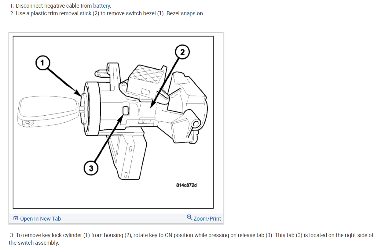

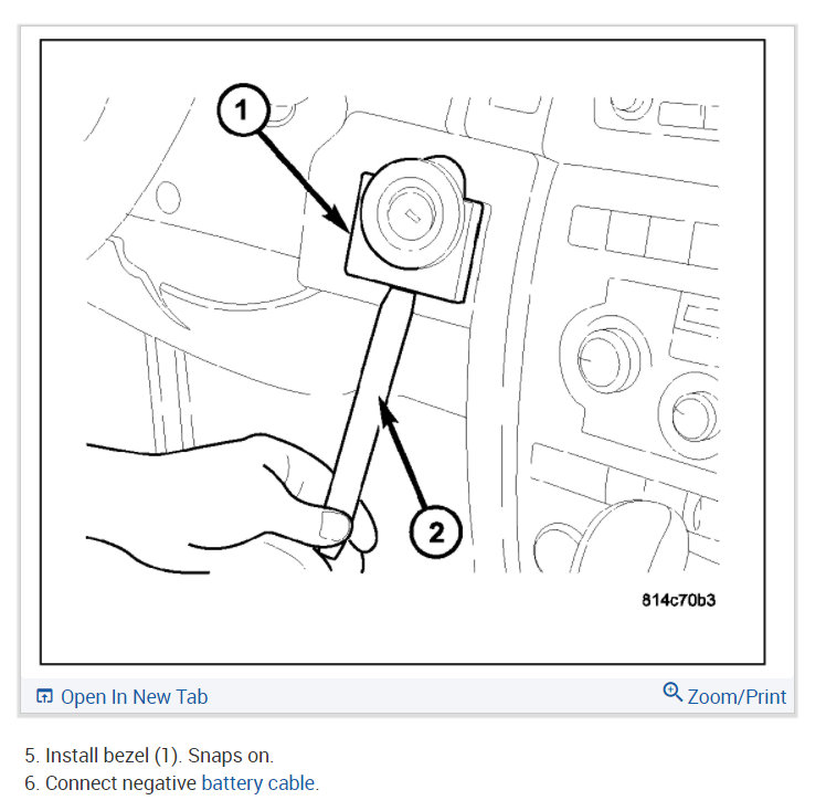

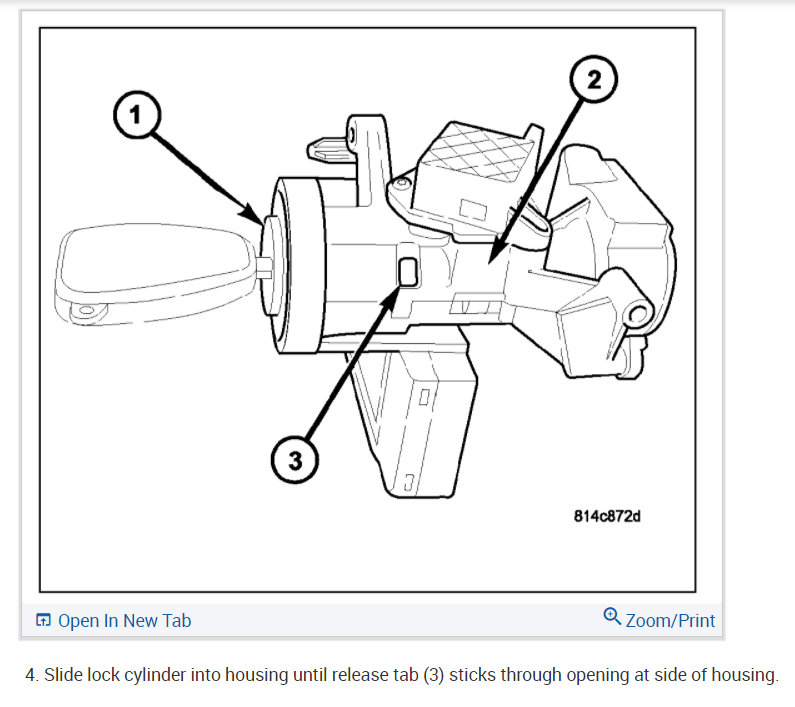

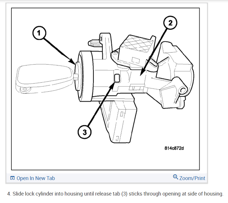

You can go to the dealer with your VIN and they we program the key for you. here are the instructions on how to get the old key and ignition switch out in the diagrams below. Check out the diagrams (below). Please let us know what happens.
