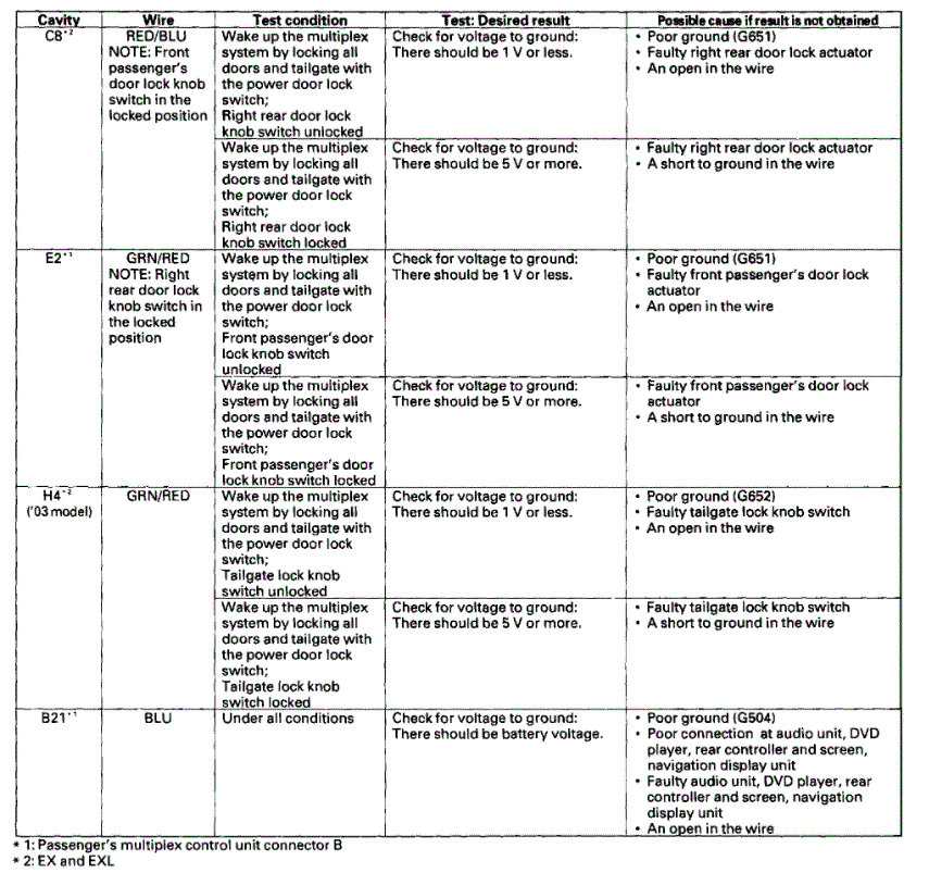

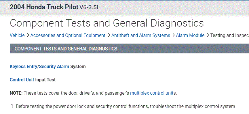

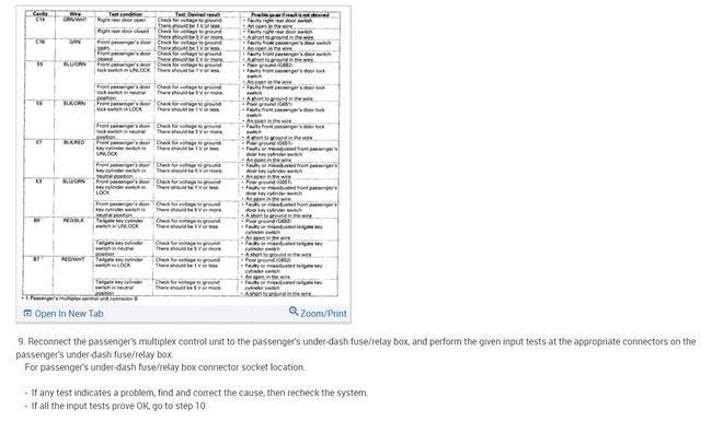

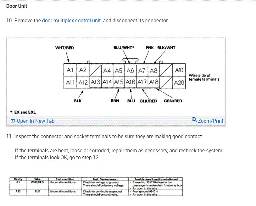

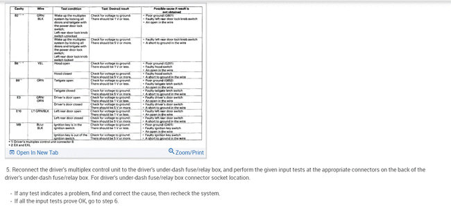

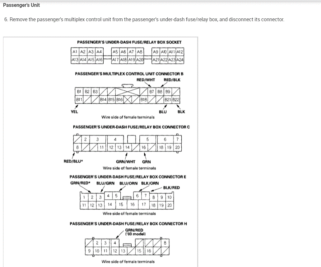

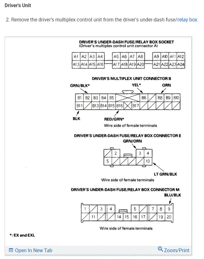

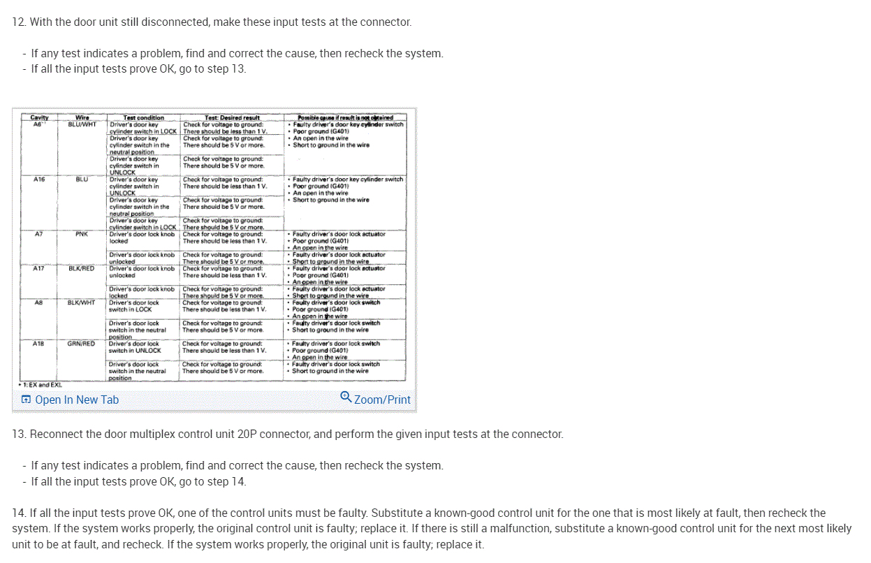

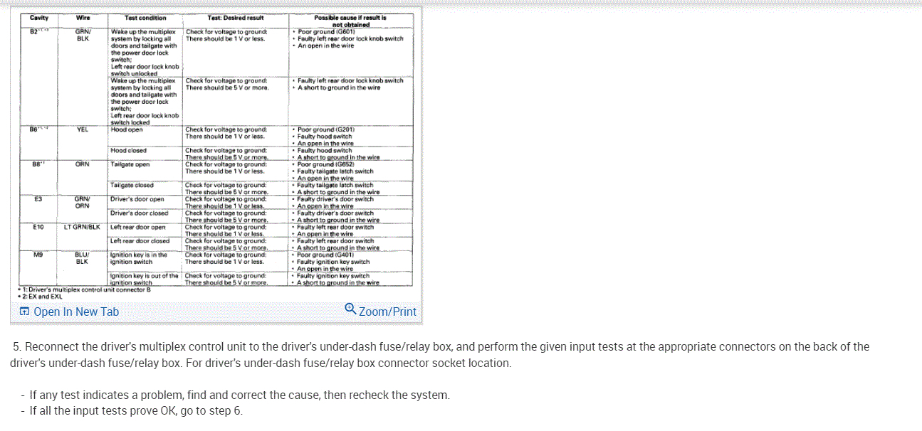

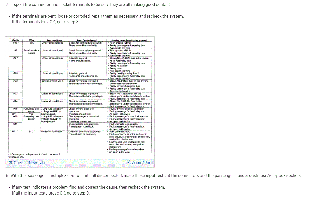

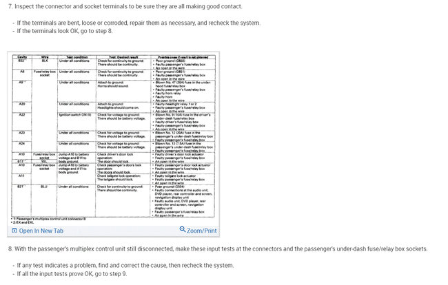

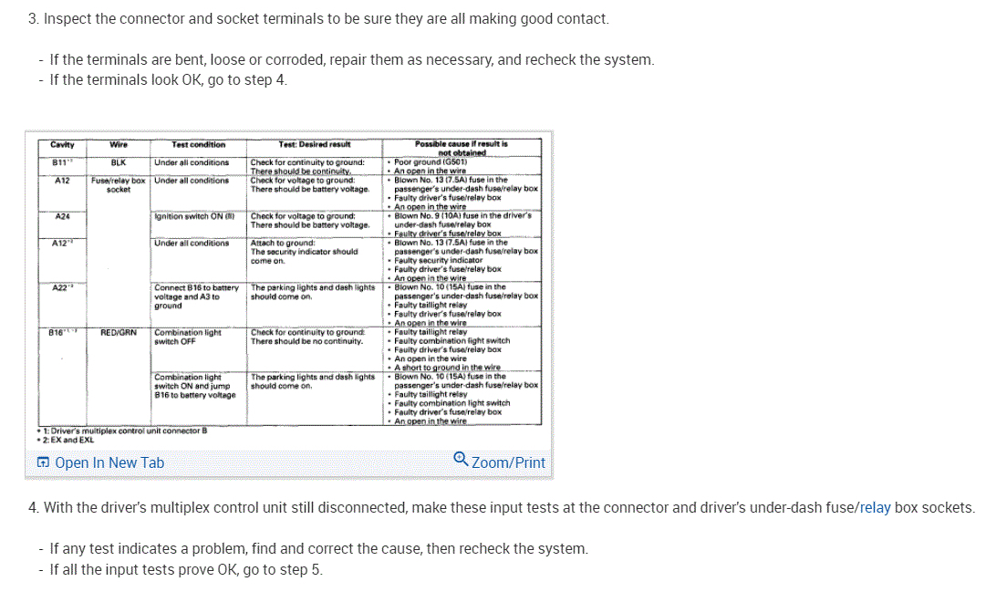

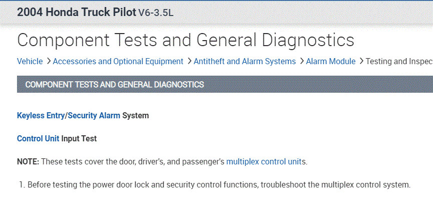

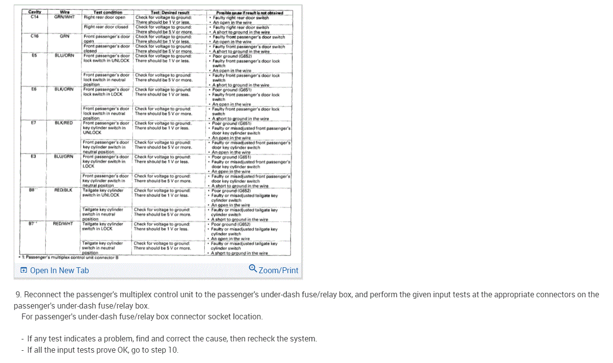

The module itself can also be tested. I attached the directions below. It is much more involved. Take a look through them and let me know if this is something you are comfortable doing. It is quite extensive.
Here is a link that you may find helpful if you decide to test the module:
Take care and let me know what I can do to help.
See pics below.
