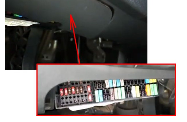

There is a fuse located in the fuse box under the dash that controls the alarm.
Removing the fuse should turn off the alarm.
It should be number 44, a 5A fuse.
I have attached a picture for your reference.
Let me know if you have any questions.

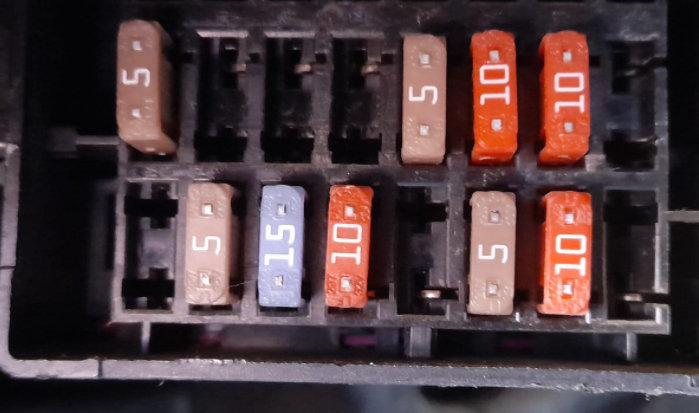

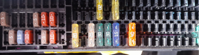

Looked in Fuse box the fuse 44 to the right of the box is 25amp and is a grey color.
the smaller fuses on the left are grey and orange and fuses 9,18,22 are 5-amp.

Since Seat is not sold in the USA, I don't have specific technical information. However, it should be number 44. You can pull the fuse and see if that takes care of the alarm. Be sure that the vehicle is off before pulling the fuse.
