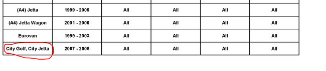

I have a technical service bulletin related to this type if issue. Take a look through it. It explains a couple ways to attempt repair. Please note that this issue isn't only related to your model vehicle. As a result, you will see references to several models. However, focus on the steps related to the City Golf.

pic 1
