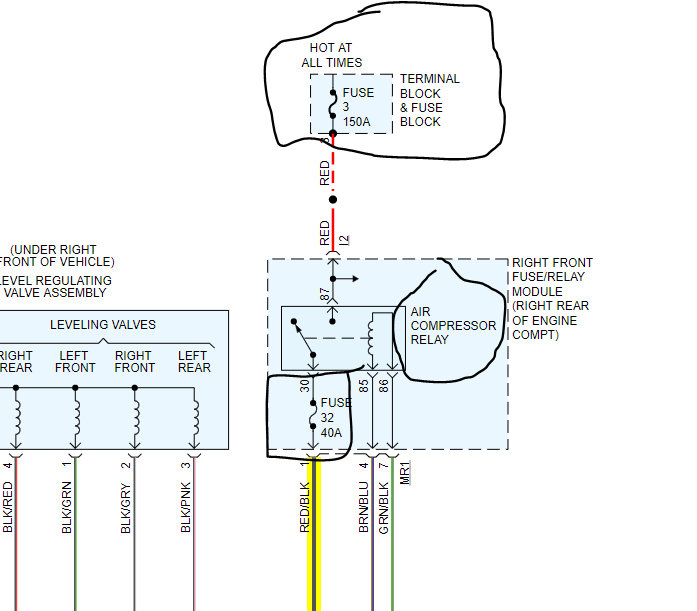

If only those two aren't getting power, you really need to remove the fuse box and check connections behind it. I have to be honest, if the vehicle was used for an extended period of time with the alternator over charging, that could have causes a few different issues. Since the fuse boxes were replaced indicates there were problems.
I attached a pic below from the wiring schematic. Let me know if these are the fuses you are referring to. Also, if you haven't already, check the relay.
Jan 2, 2020 at 10:41 PM
KRW1832
Sorry for the long wait. Was busy with work. Yes those are indeed the two fuses I am talking about. The relay tested fine, I took the fuse box out and couldnt find any melted or frayed wiring. Didnt find any loose connections to the fuse box either. Checked under the passenger foot well and no fuses were blown there either. Cleaned all connections to make sure and nothing.
Jan 8, 2020 at 11:59 PM
Is there power at fuse 3? (150 amp)
If there is power there, does it leave the fuse?
