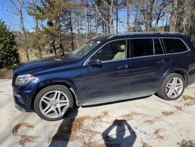

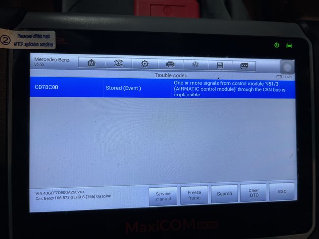

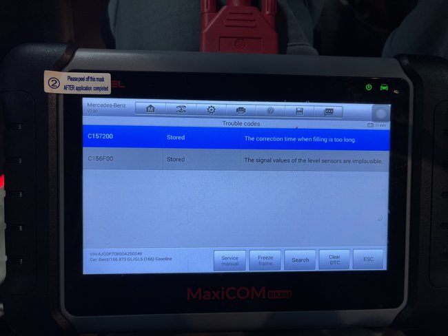

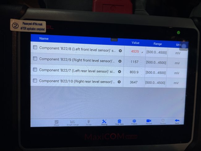

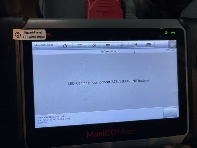

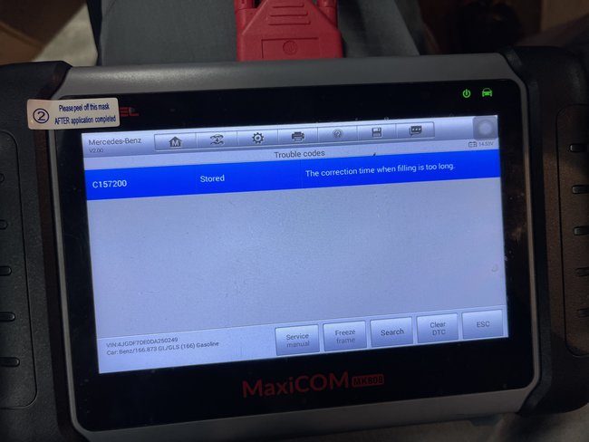

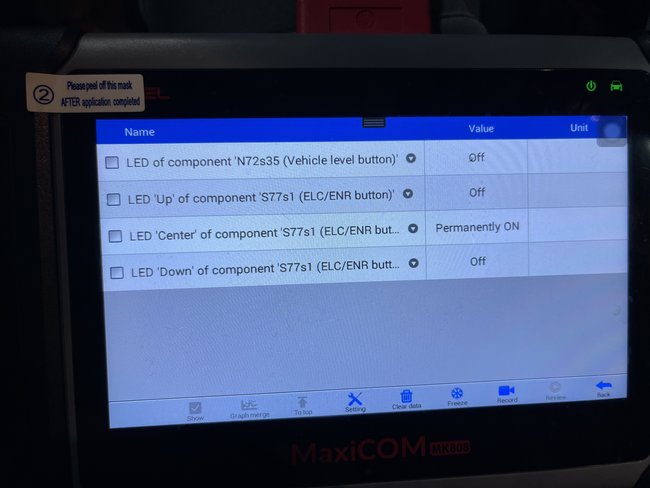

Left front sinking, can't be driven. But i also feel that most of the sides are lower than they should but left front is very low. I think the compressor ran and ran but couldn't get that side up, so it stopped. But i don't hear it at all. Am trying to find out whether it's the compressor or the left strut having a leak. Here are some data from the dampening system. I know the compressor location. Not sure if it can lock temporarily due to the front left sinking. I have had BMEs, Merecedes Benz, and Lexus that even of one side is down once you start it compressor kicks on and try at least and in many cases, they go up until you leave it for few days. Any help is appreciated.

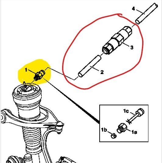

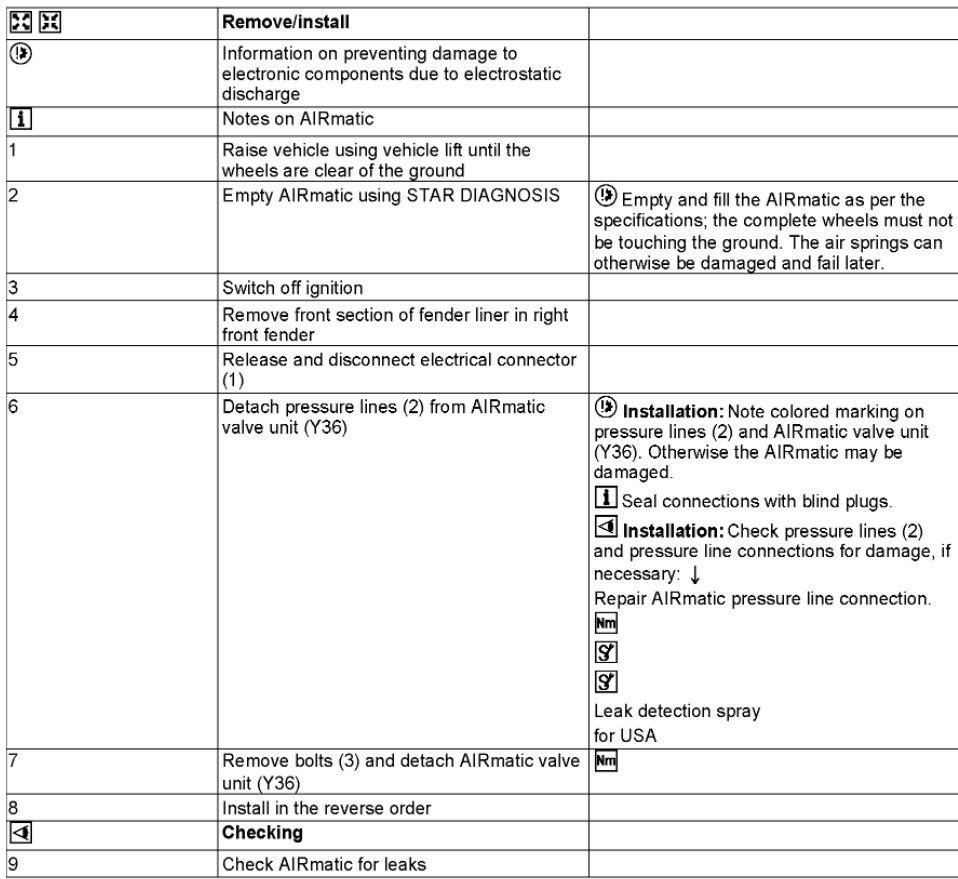

I would say the leak is in that corner and not the compressor as the other corners is staying up and they all use the same compressor. Most likely the issue is either a solenoid stuck or failed or an air leak. A stuck solenoid would act the same way as the air would be blocked and the computer would not see the height sensor going to the correct height and would keep running trying to move it. I would go check the control solenoid outputs first. Pop that line off that goes to that corner and see if air releases or not, you could use an air line and nozzle to put air into the system and see if it inflates or leaks. If it inflates the solenoid, is the issue. I believe you can have them rebuilt but with the current parts issues that could take a while. You might be able to make a line that at least lets you use a tire chuck to add air so you can drive it at least.

If the solenoid is stuck it could be that the pressure switch is shutting off the compressor. I would start with checking for leaks and work back from there, that way you don't replace the valves or compressor and then find that you need to replace the air springs as well.

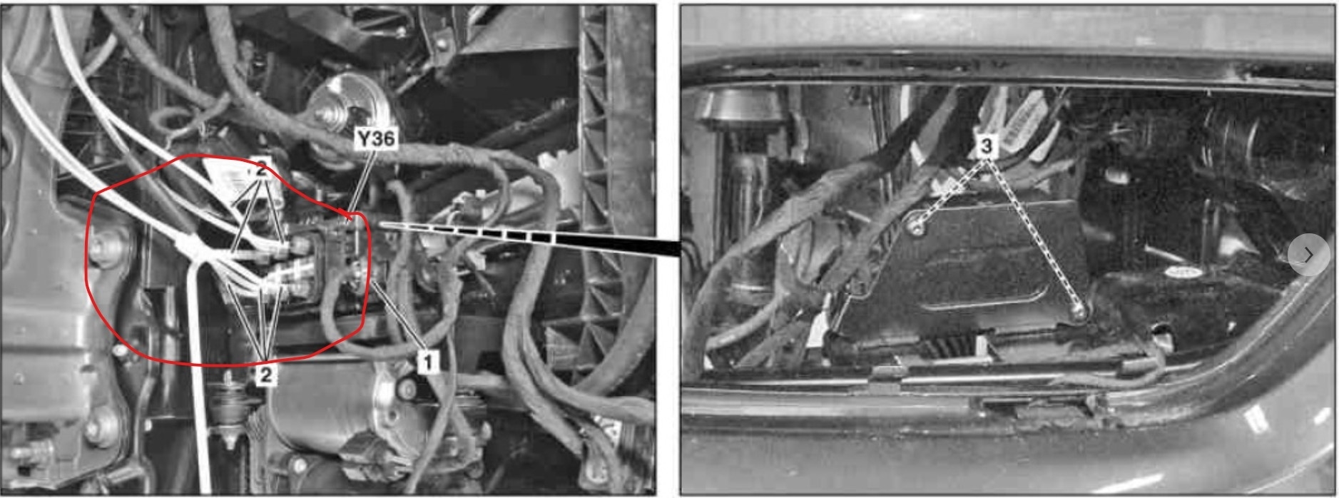

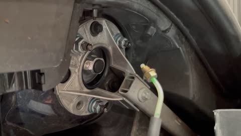

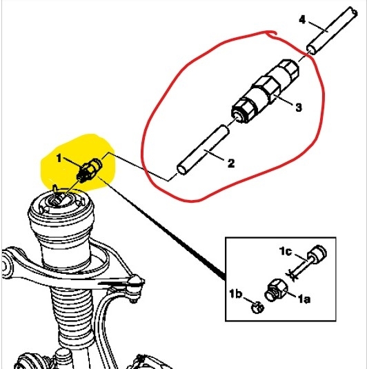

I raised it up, checked on the sunk side and the strut is new, line has no issues. Checked the compressor, disconnected both harnesses, no corrosions, put them back, wiggled them. Checked the relay again and swapped it with another, checked the 40amp fuse next to it which has ground for some reason instead of power, not sure if that is how it's supposed to be. Removed it and reinstalled it. Removed the airline from the top of the air strut as the beep is coming from it, noticed also that the boot on the strut is stuck all the way up, pushed it down. Turned the car on and as you can see there is air coming out of the hole in increments. Not sure if this is normal but then i started to hear the compressor. Turned it off, put the air line back and started the car and she rose all good. Who the heck knows what is the issue?

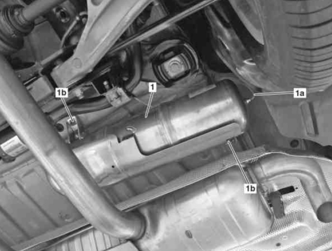

Stuck solenoid. With it open and no load it worked, being it's sticking you could try an old trick, jack it up so you can get to the lines at all four corners and remove them. Now go to the accumulator (air tank) and remove the line on it. Now for the trick, take a cup of rubbing alcohol, add about two tablespoons of marvel mystery oil to it, shake it well and use a fluid injector/syringe/whatever to put about 1/4 of the mix into the line. Reconnect it, Now go to the air line manifold and pull the other end of the line off and shoot some of the mix into the control manifold so it will get between the solenoids and the compressor, you want it to be blown through them as they cycle. Leave the lines off at the bags and start it up, the compressor should start pushing the mix through the system and it will clean out and lightly lube the moving parts, once you see it spraying out the lines let it run until most of it is gone, reconnect everything and see if it acts better. I've used that on older Cadillacs and Lincolns with air ride because the solenoids get corroded from the moisture in the air and then start sticking. Usually this will work for years after being treated and is a lot cheaper than replacing the control head solenoid assembly.
