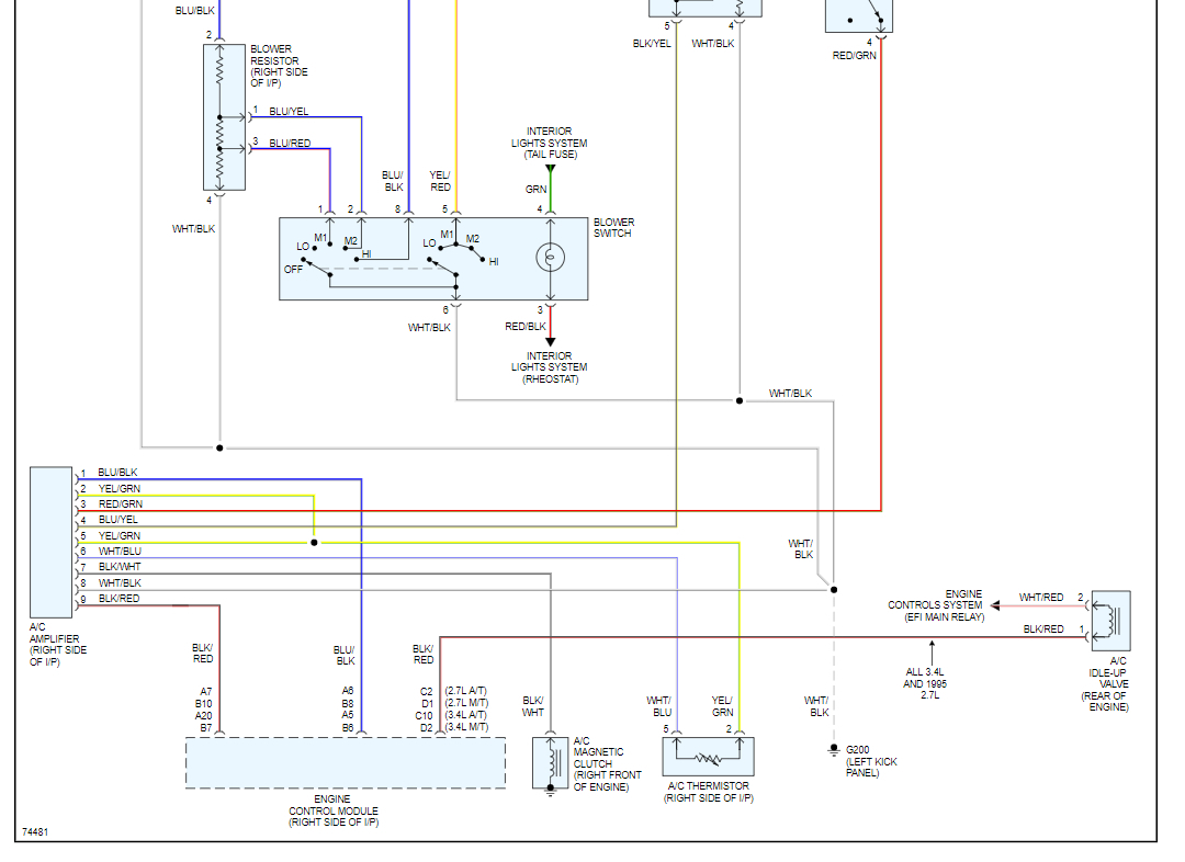

I have a circuit diagram of the electrical system for a RAV4 which seems identical except for in my system there is no 'conventional' magnetic clutch relay (the wires that enter and exit this on my car go straight in and out of the cabin fuse box so I presume it is controlled by a semiconductor fuse inside this).

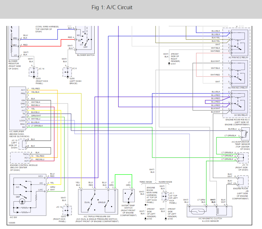

The wiring schematic I am using is from this thread: https://www.2carpros.com/questions/ac-amplifier-harness-wiring-colours (see bottom of reply)
However there are differences (wire colors and locations are different and most importantly there is no magnetic clutch relay (also A/C circuit is hot in on or start) so it's complicated for me.

Okay. So when you are testing pin 12 to pin 8 for voltage, you are doing what is called a voltage drop across whatever component is on this circuit.
So you are finding that the Evap pressure sensor actually uses .58 volts to operate but you are not finding out what the sensor is telling the AC amp. To find out what the sensor is telling the module you need to check pin 8 to ground.
The way that circuit works is the pin 12 is a signal circuit which should be 5 volts. Then this 5 volts passes through the evap sensor and returns to the AC amp where it tells it what the temp sensor is reading. This will be on a scale from .5 volts to 4.5 volts due to the sensor requiring a small amount of voltage to operate (which is the .58 volts that you are finding with the voltage drop test).
So we need to see what the volt is from the sensor using this test and we can go from there. The same pin 10. You are getting 0 volts because this signal circuit is not connected to the clutch so it is basically an open circuit.

The problem is, these wiring diagrams are not exact to your truck. We don't have one for this specific vehicle so this is going to continue to be confusing until we get one for your vehicle.
