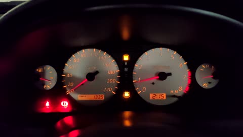

If you can, record it so I can see the tachometer and how the vehicle is reacting with the AC on.

I watched the tachometer and listened to the engine speed. The two didn't mirror each other. The tachometer is jumping but the engine speed doesn't change. Is that correct?
Please understand that I am listening to it through a small speaker on a computer. I realize I could be wrong, but the engine sounded very steady. I would think the tachometer itself or a connector to it may be the issue.
