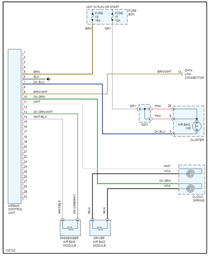

I don't see the image. We need the code number to help efficiently. Here is a guide to help check the wiring and the airbag wiring diagrams to help you with the testing:
Check out the images (below). Please let us know what you find.
May 30, 2023 at 12:45 PM
