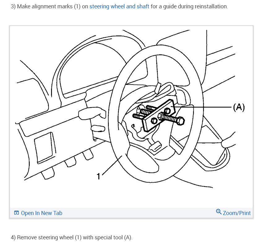

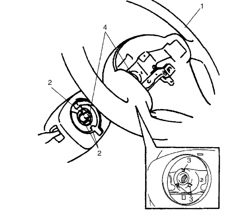

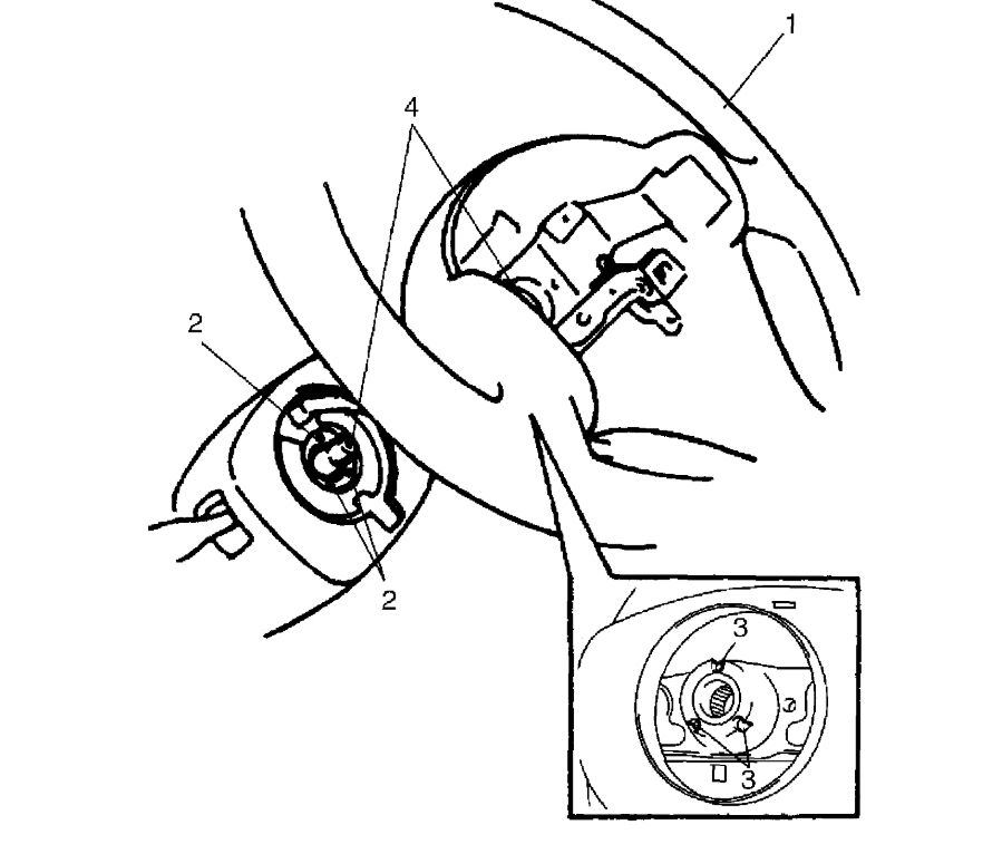

Yes you are right the mechanic allowed the steering wheel to turn to many times now the clock spring behind the steering wheel needs to be replaced. Here is a guide to show you what you are in for when doing the job:
https://www.2carpros.com/articles/steering-wheel-clock-spring-removal
And diagrams below to show you how on your car.
Check out the diagrams (below). Please let us know what you find. Cheers, Ken

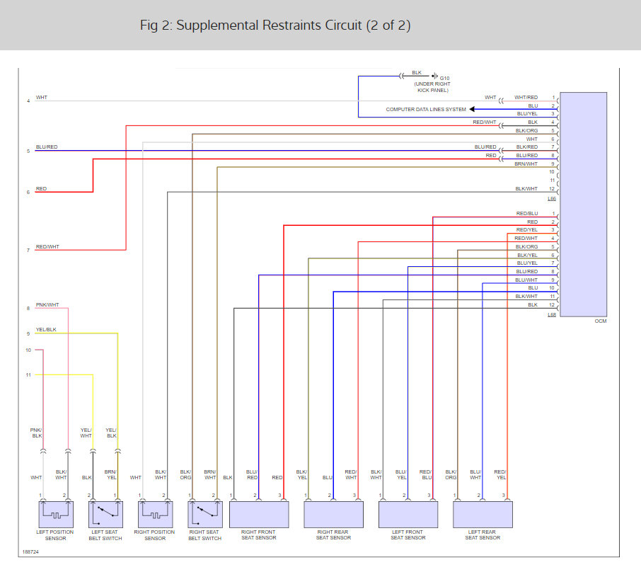

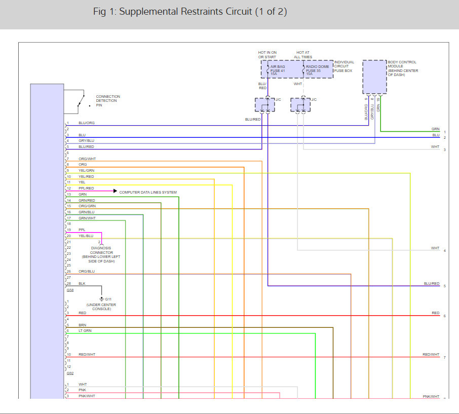

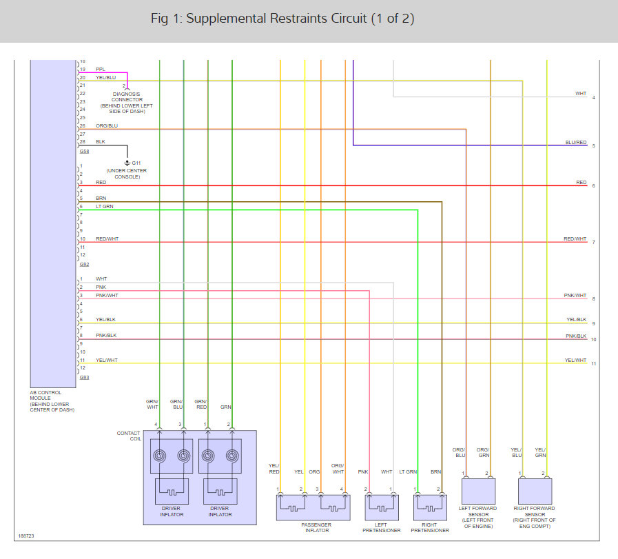

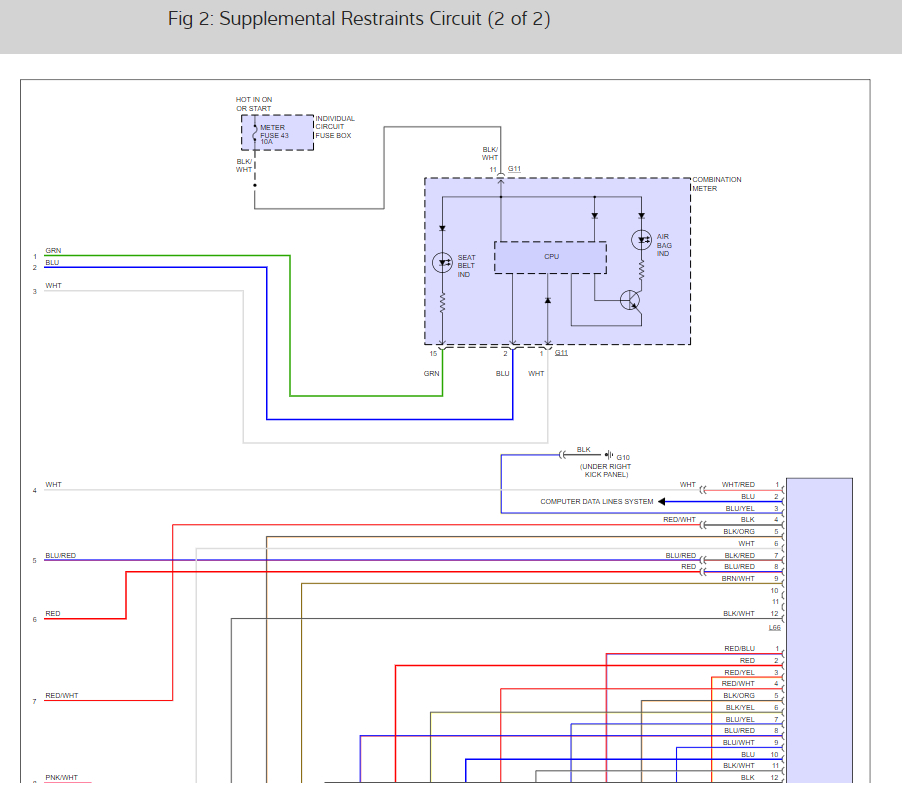

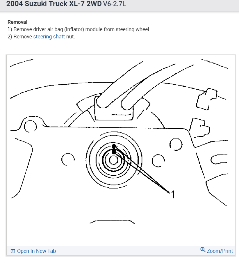

The only way to be 100% sure is to test the wiring through the clock-spring. Here is a guide and the wiring diagram to confirm the issue:
Oct 15, 2018 at 11:07 AM

That will be a dealer item I would say about $140.00 could be less though. You can rear the wiring diagrams like a road map. just test the wires through the clockspring see if they are connected.
Oct 16, 2018 at 10:06 AM
