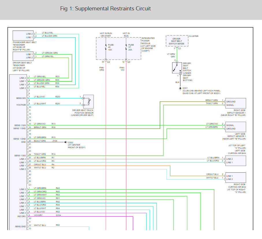

Hello! So my airbag light is on due to wire harness, under driver's seat, being ripped out during cleaning. Not totally being ripped out, let me be exact.
There is a sensor, on the left side of driver seat, that has two wires coming out of it. These two wires Connect into the big harness somehow.
Also, there is a 2-pin connector coming out of the main harness that has lost the other side of the connector. Not sure what that is supposed to connect to.
And, while taking things apart to see what I can do, I noticed a wire coming out of a 6-pin that doesn't look like it went to anything, and a wire coming out of the main harness that doesn't look like it went to anything.

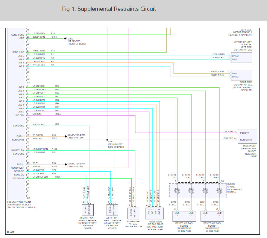

Both online manuals are great AllData and Mitchell 1. they allow us to post small pieces of information. so I found this for you. lets me know what you think. here is a guide to help you with the wiring:
