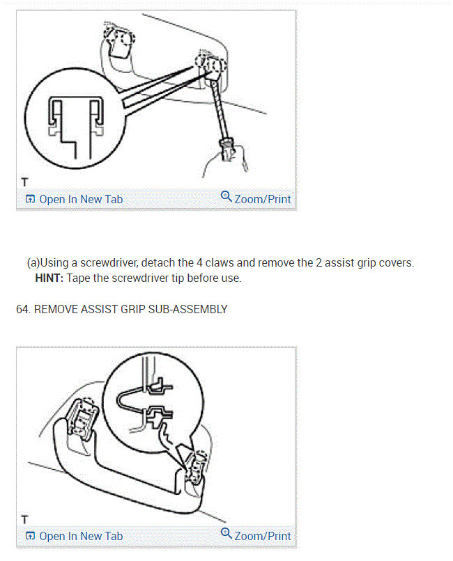

In short, the modules are normally the only thing that needs to be programmed to the vehicle and not the actual components that the modules control.
Please see below for the process on how to install the airbags. Just be careful getting used airbags. A lot of time they are deployed and rolled back up.
As for a scan tool that will clear the codes. you just need one that will read and erase ABS and SRS codes. Here are a couple links for videos that will help with this:
https://www.youtube.com/watch?v=rTtAnsOlZU4
https://www.youtube.com/watch?v=jr_Iv8T_Phk
Please see below for the process from the manual. Let us know if you have other questions. Thanks
Jul 2, 2021 at 8:02 PM

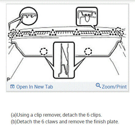

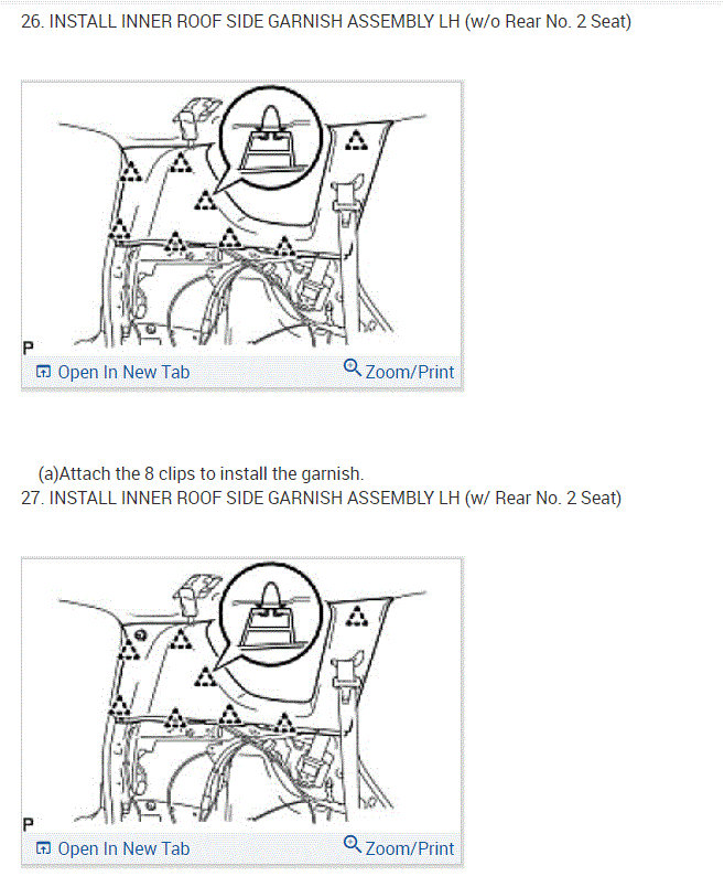

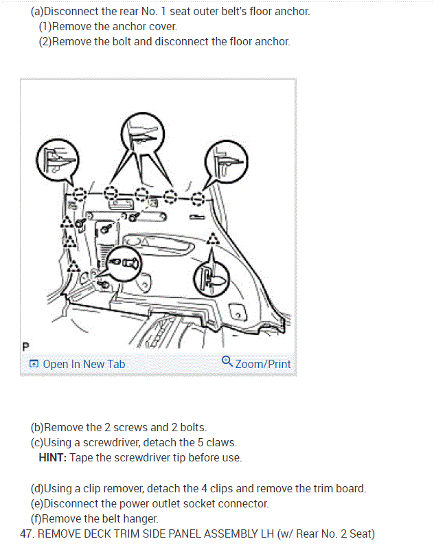

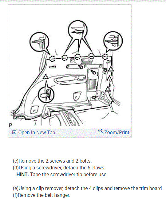

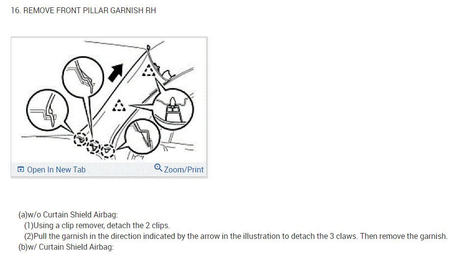

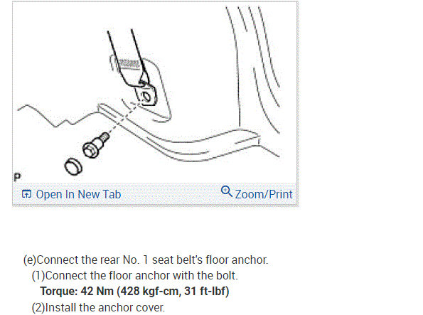

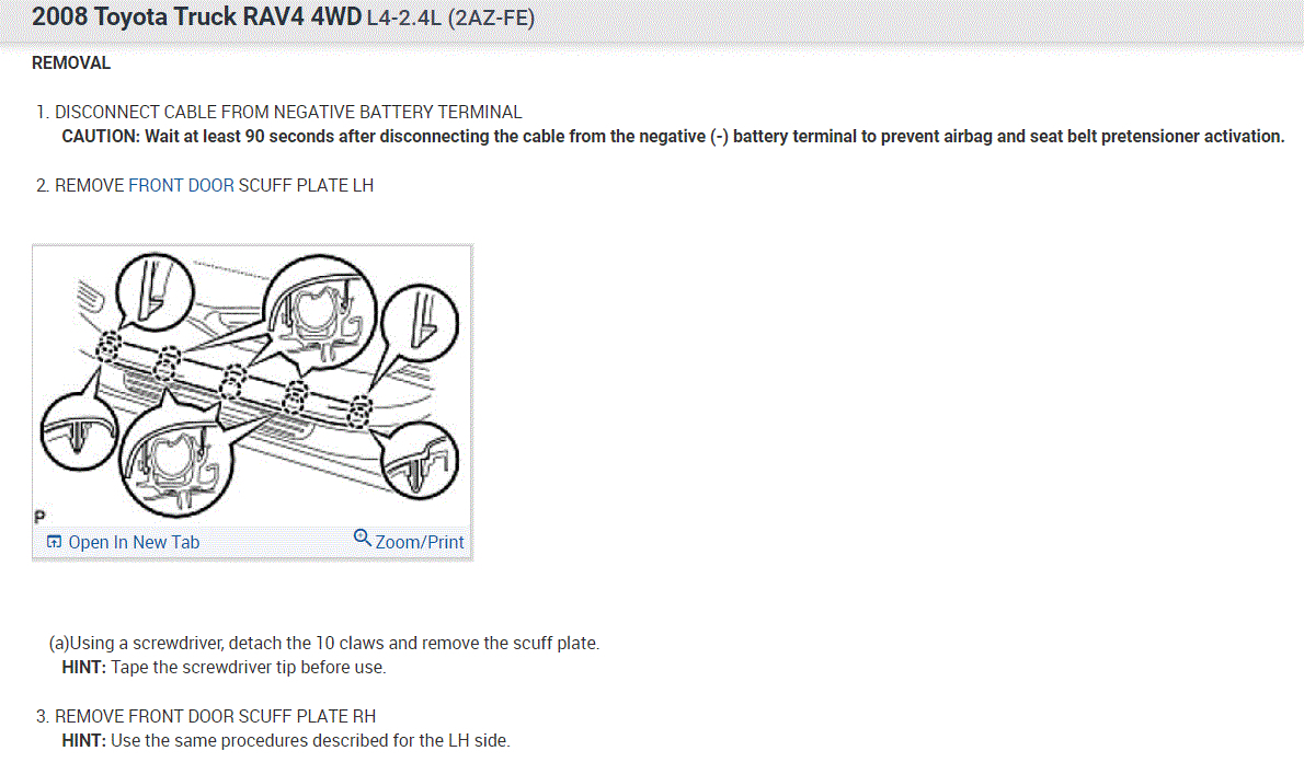

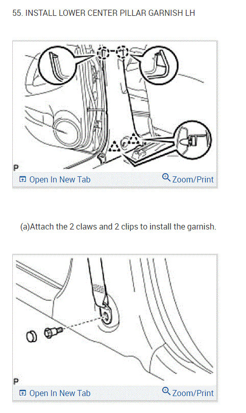

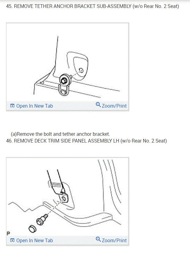

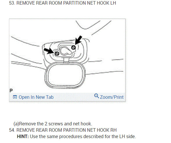

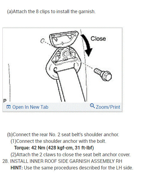

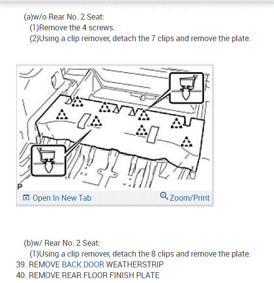

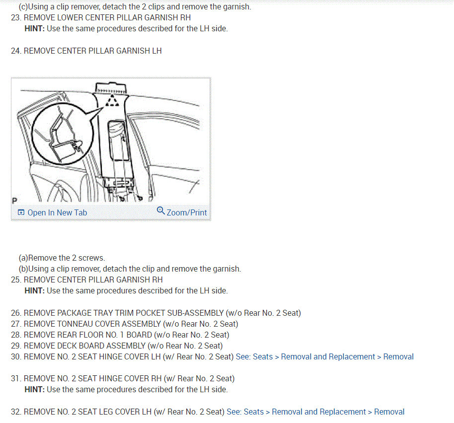

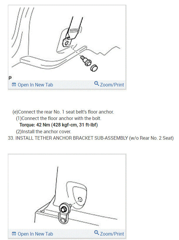

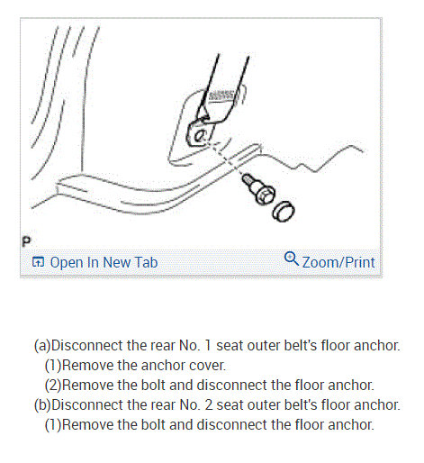

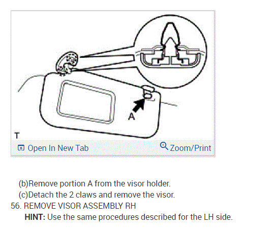

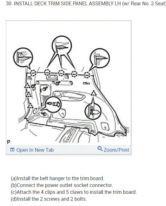

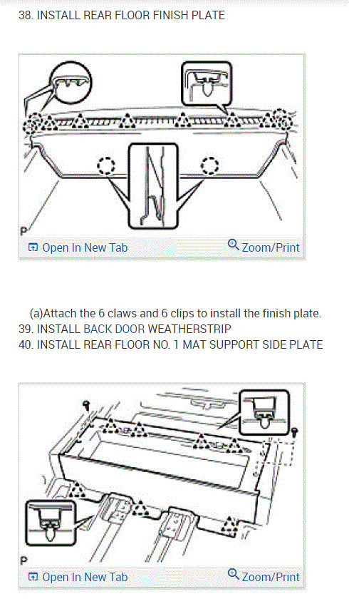

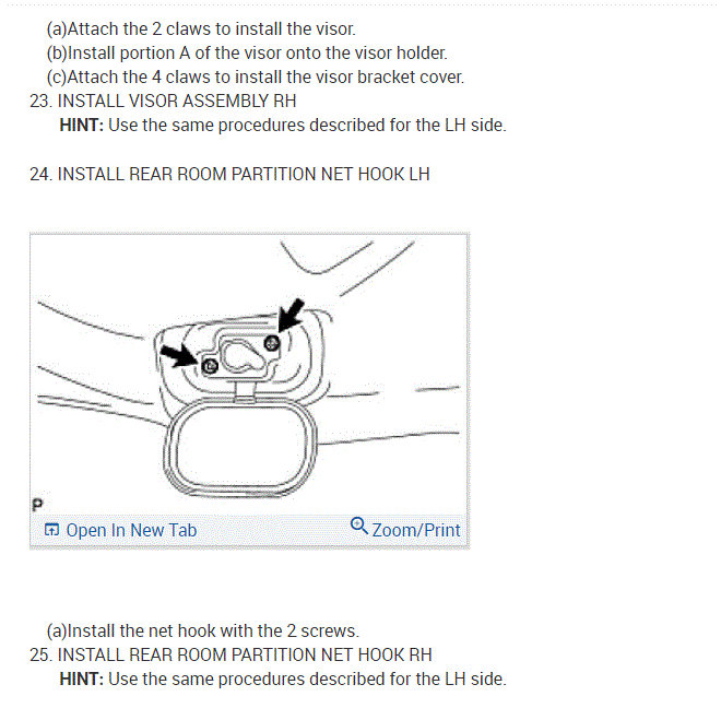

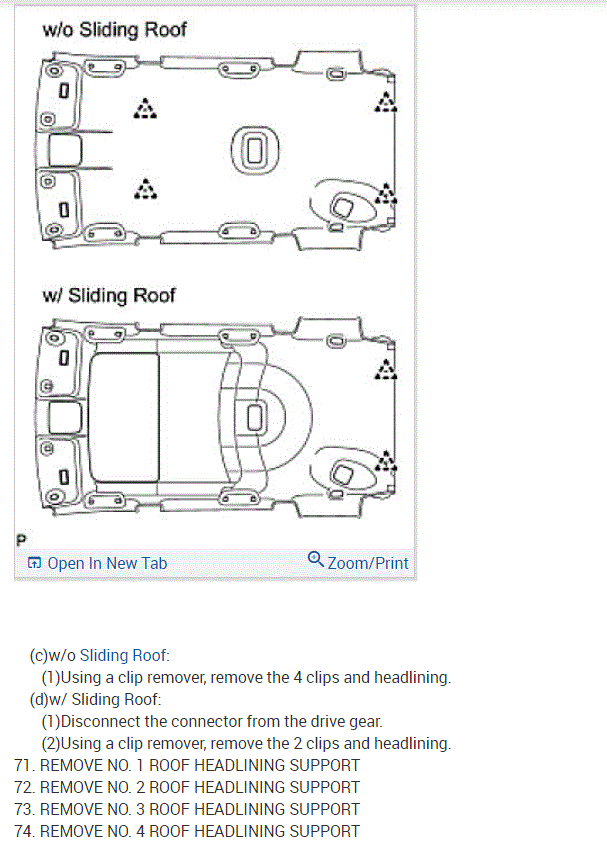

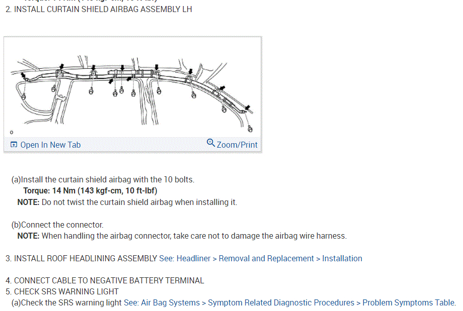

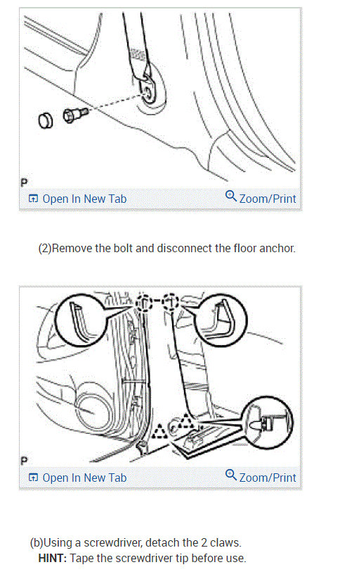

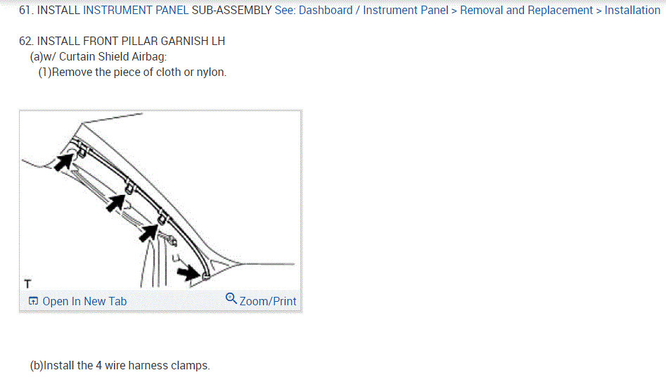

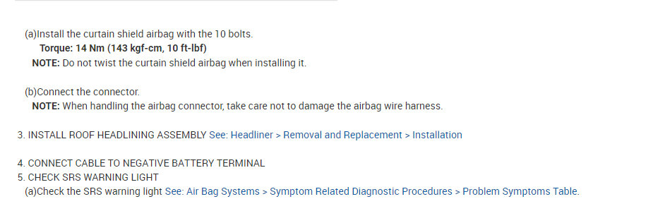

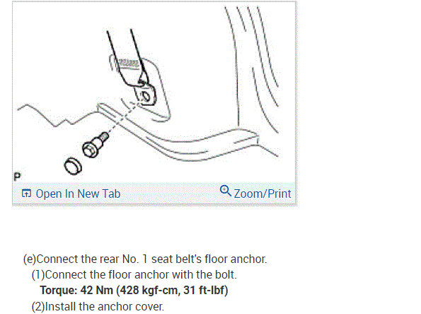

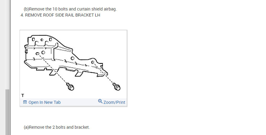

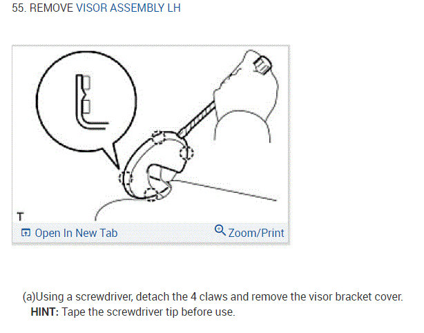

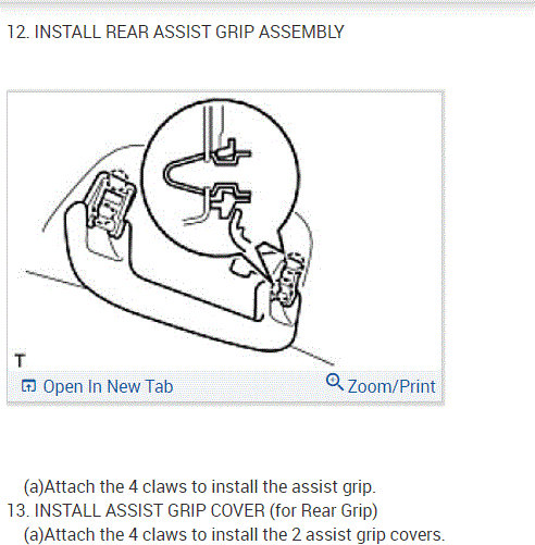

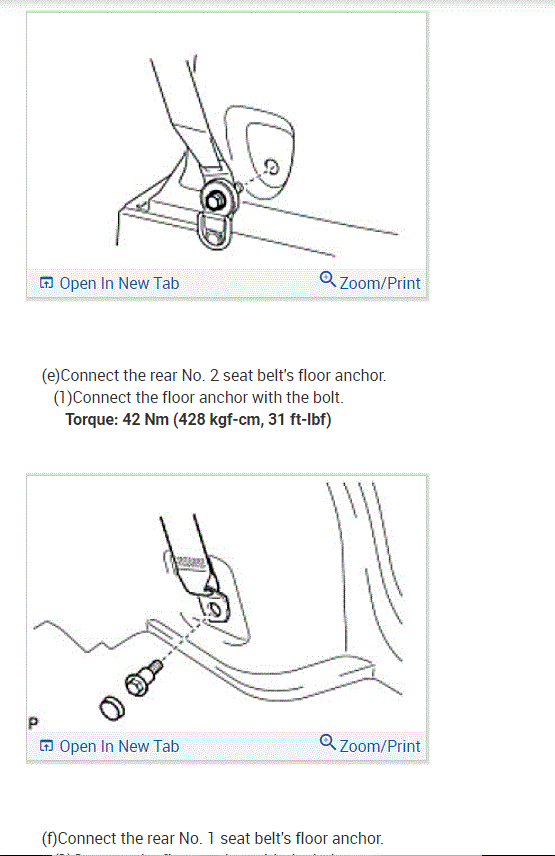

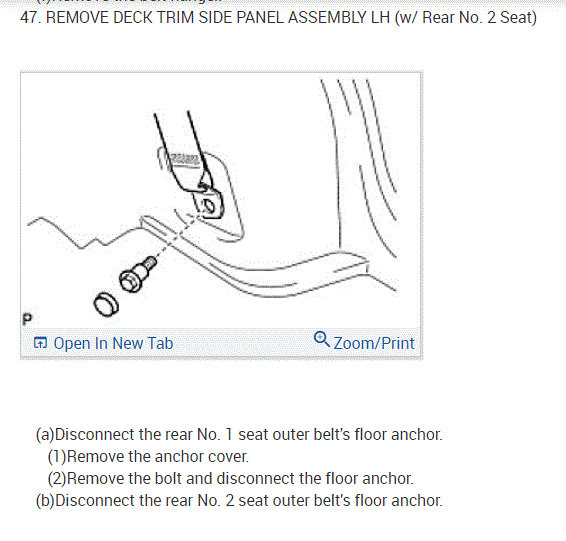

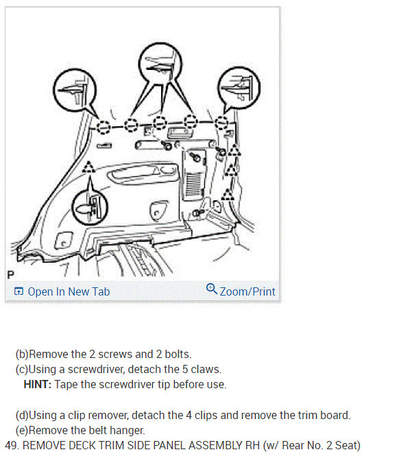

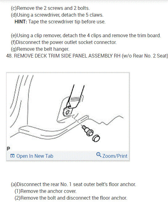

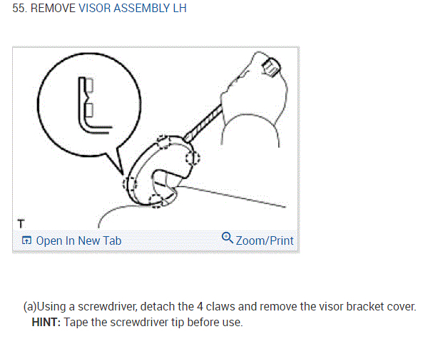

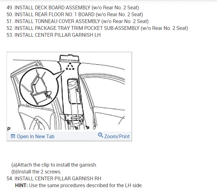

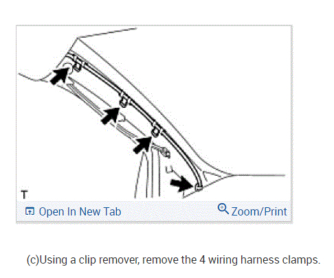

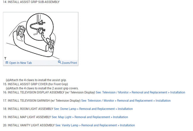

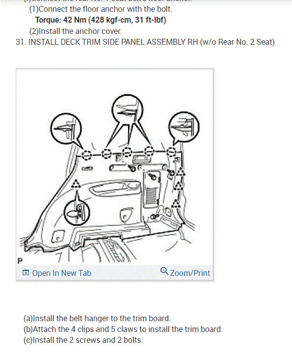

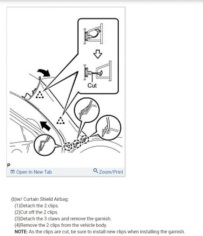

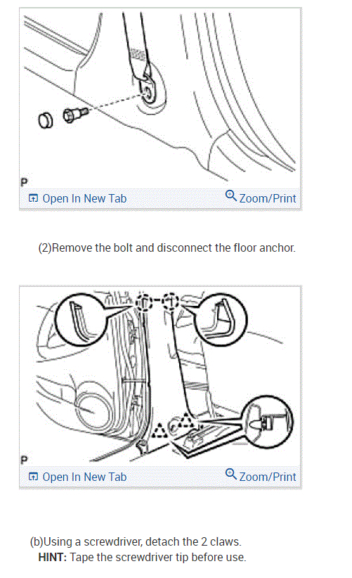

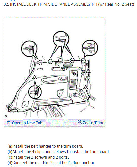

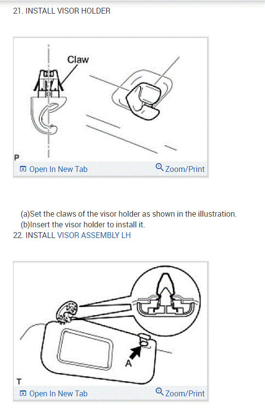

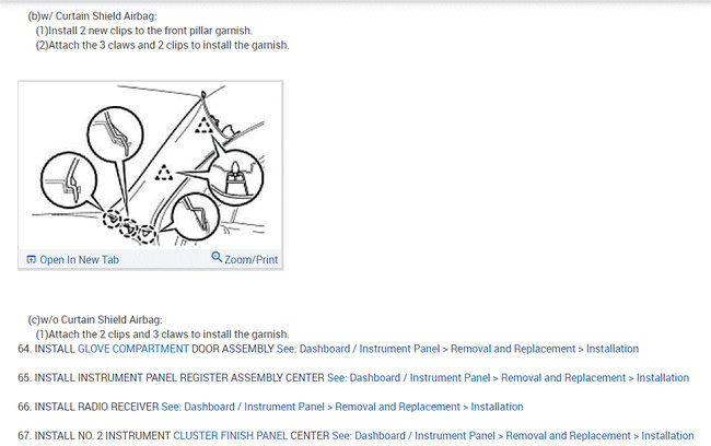

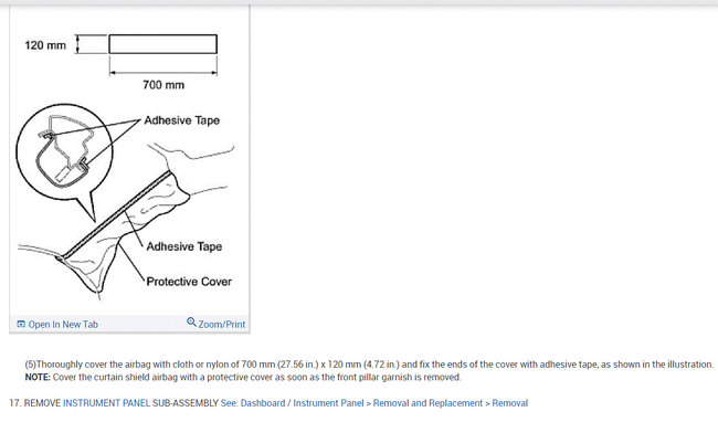

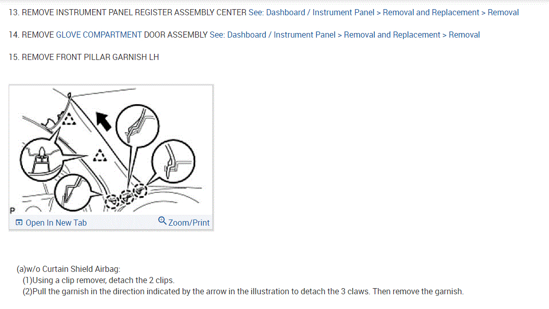

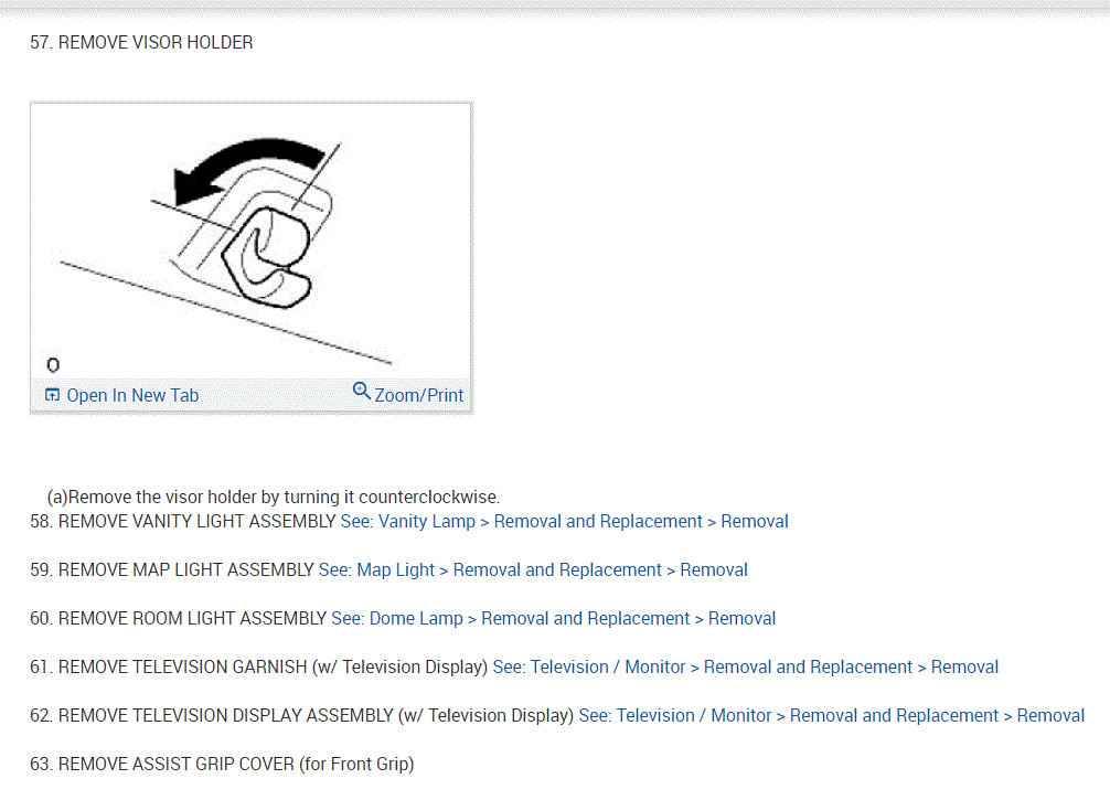

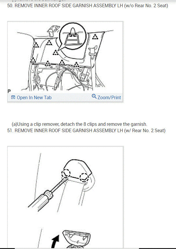

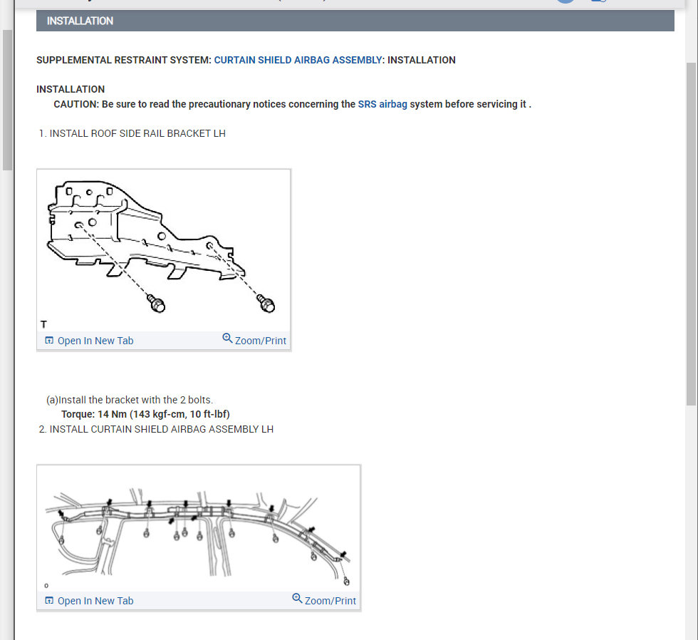

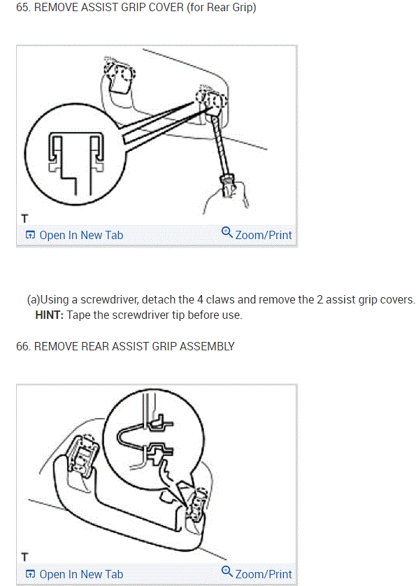

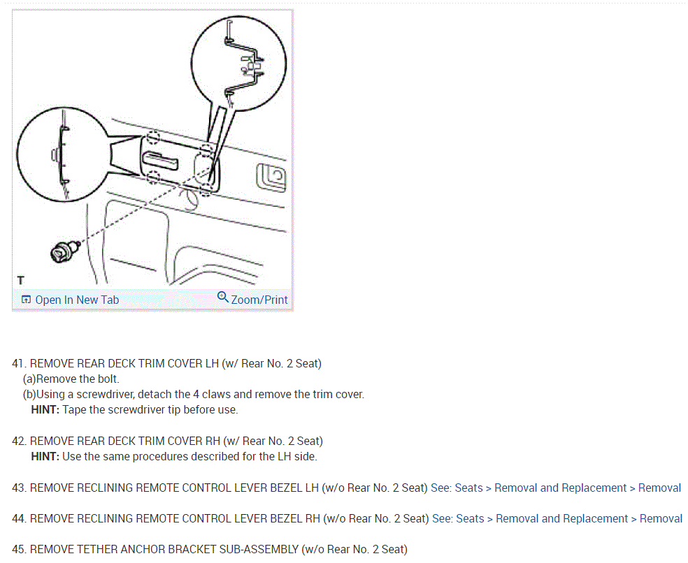

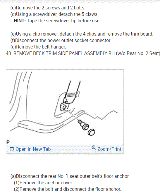

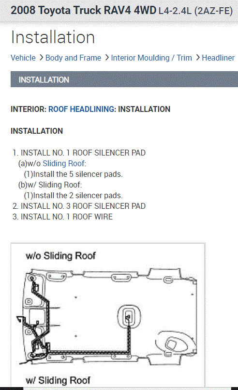

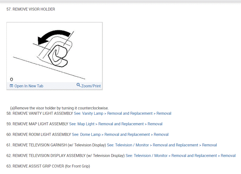

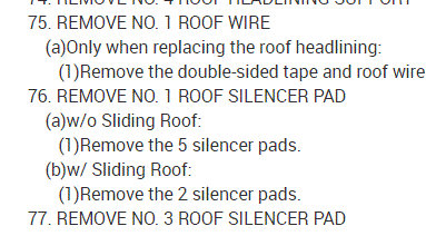

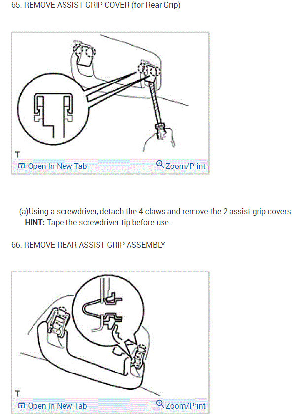

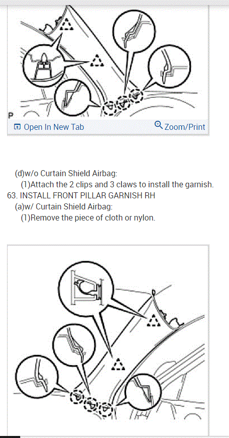

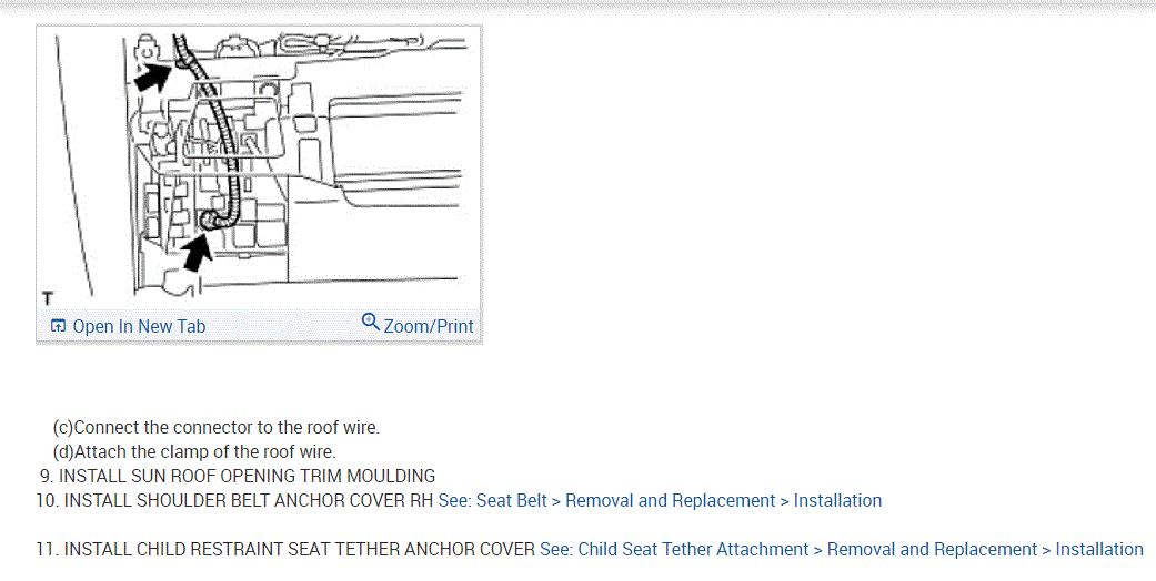

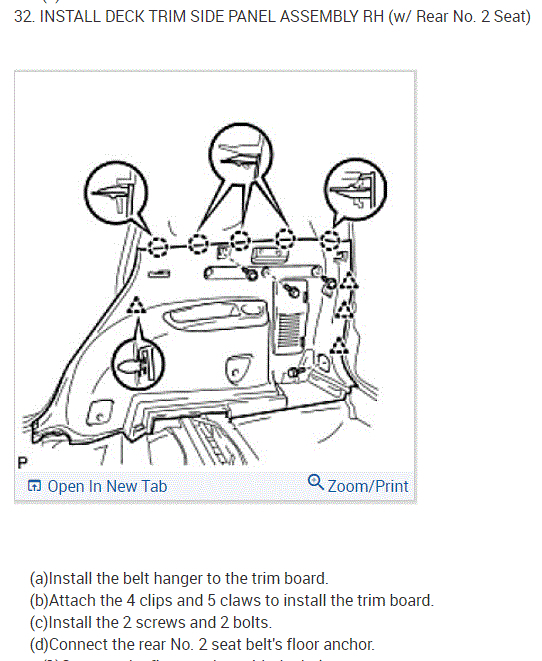

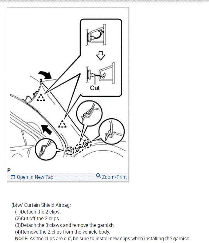

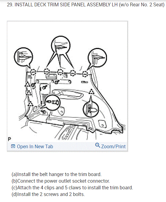

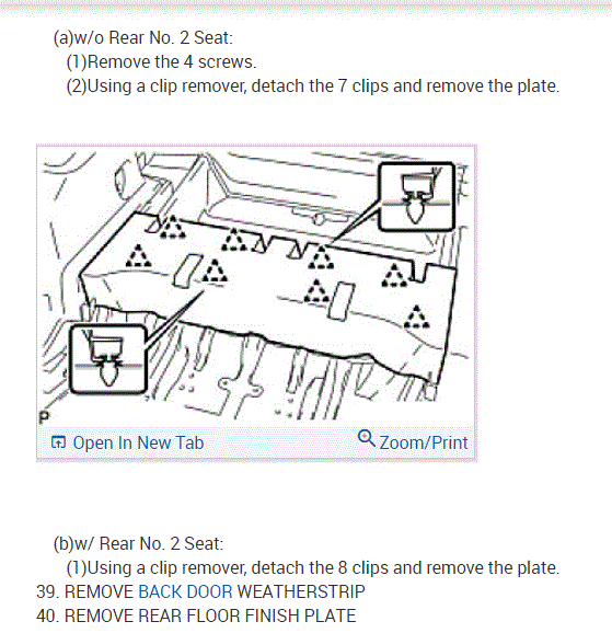

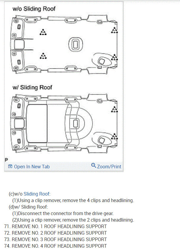

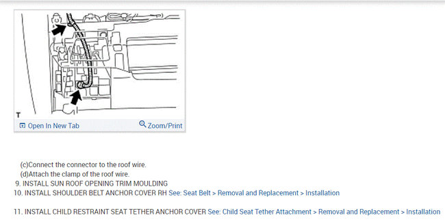

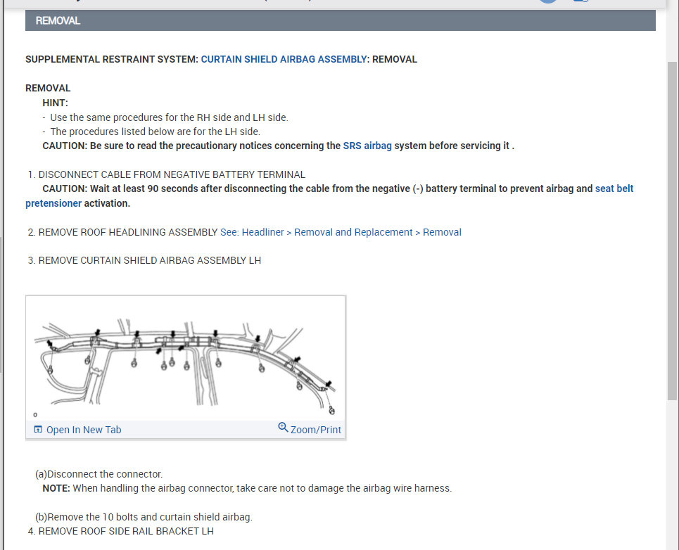

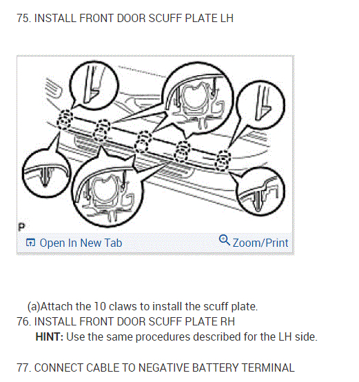

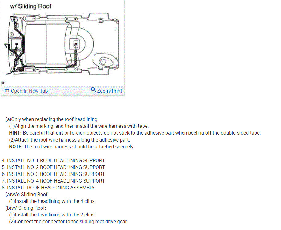

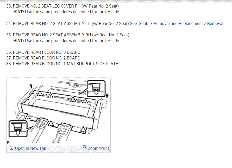

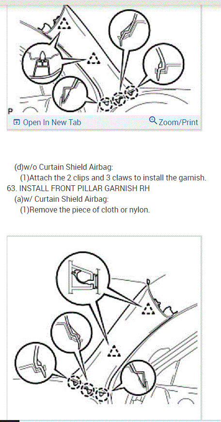

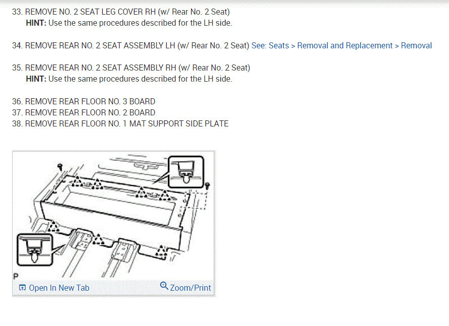

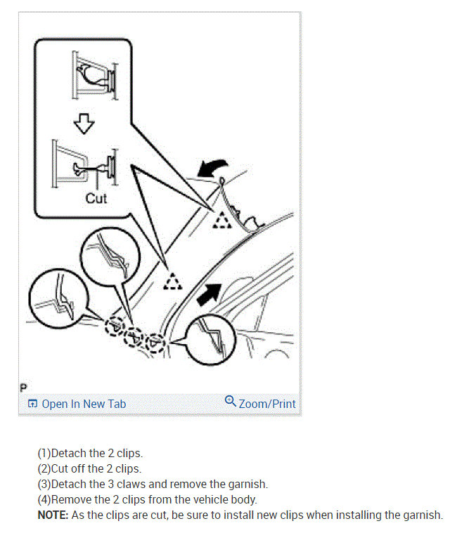

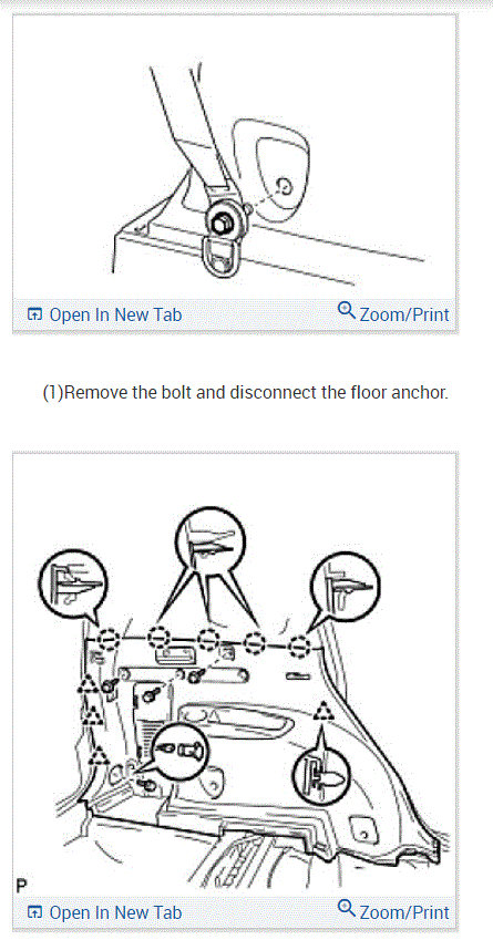

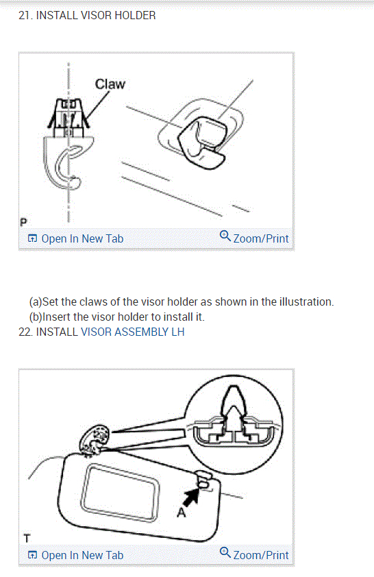

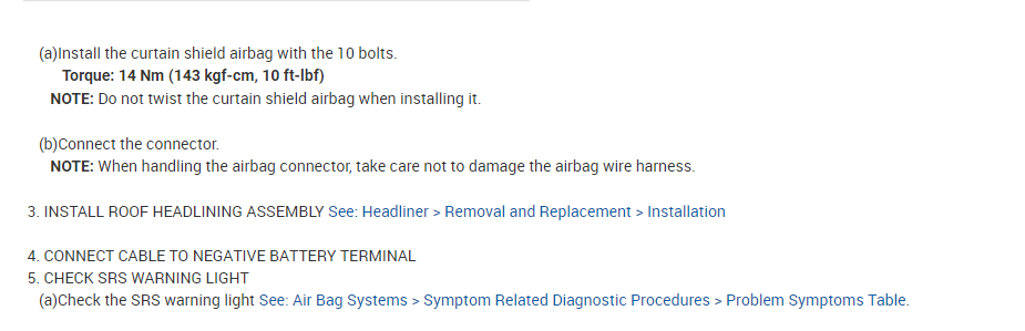

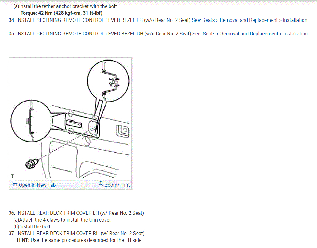

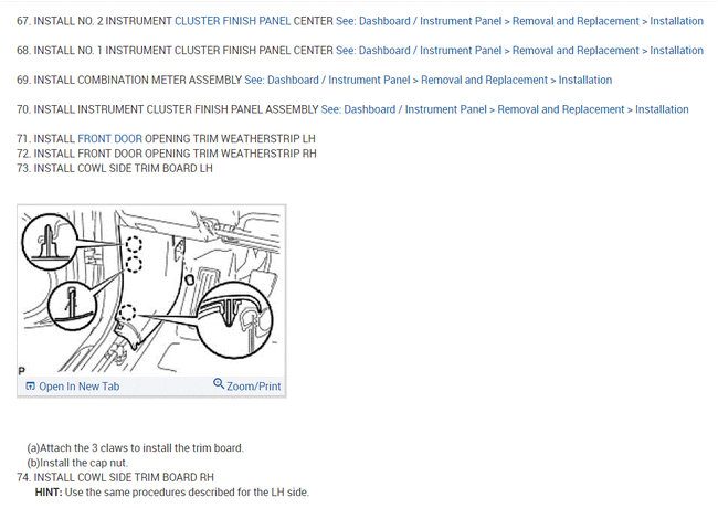

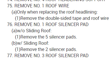

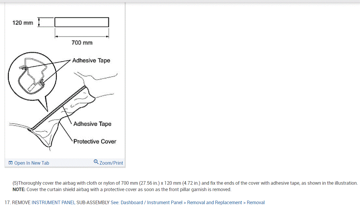

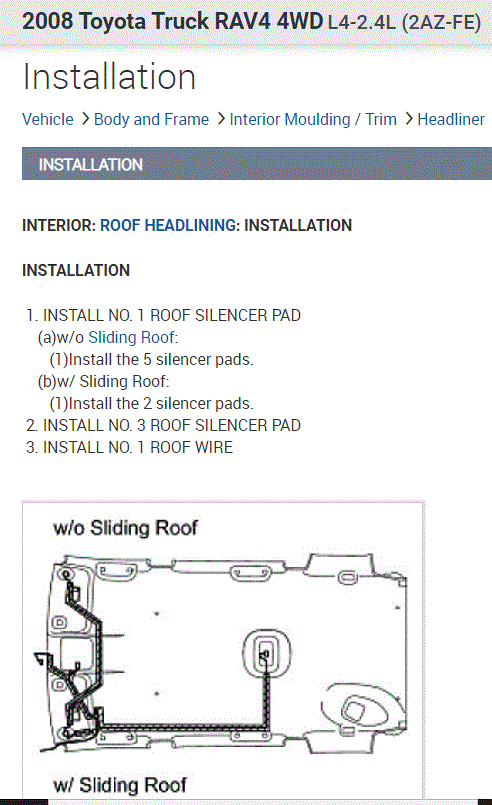

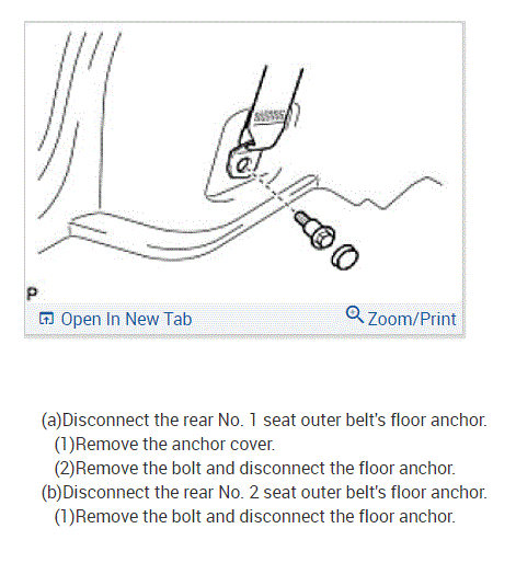

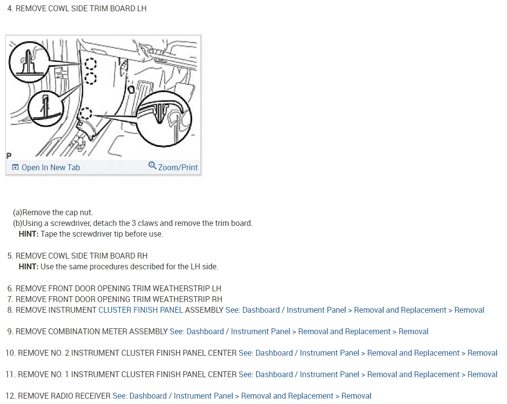

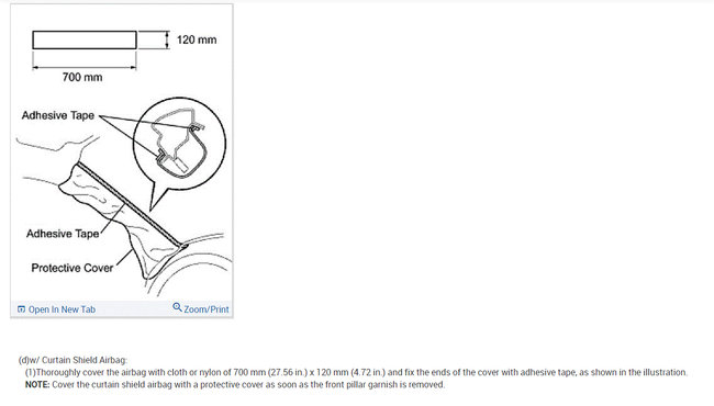

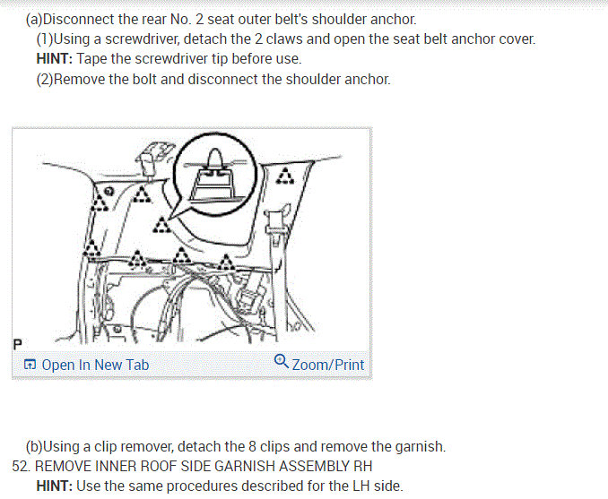

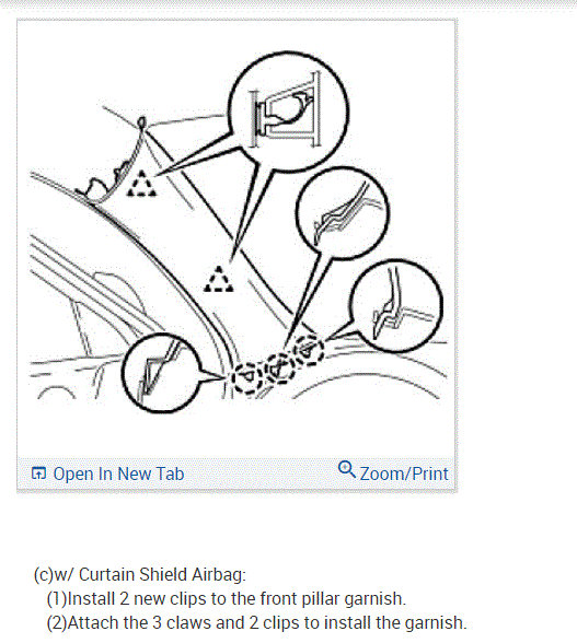

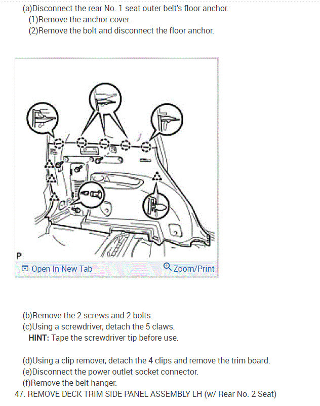

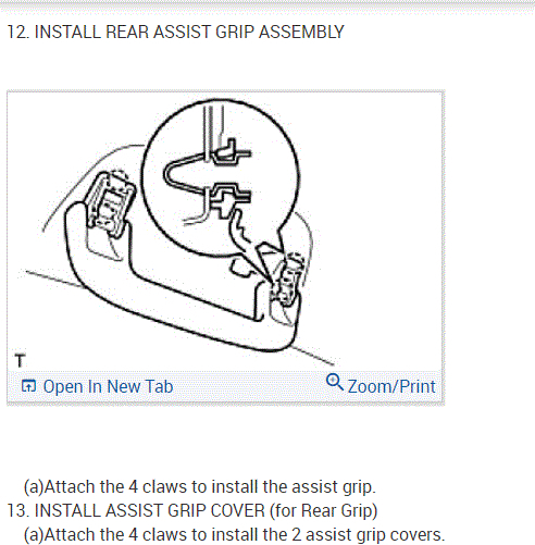

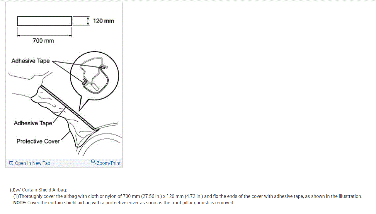

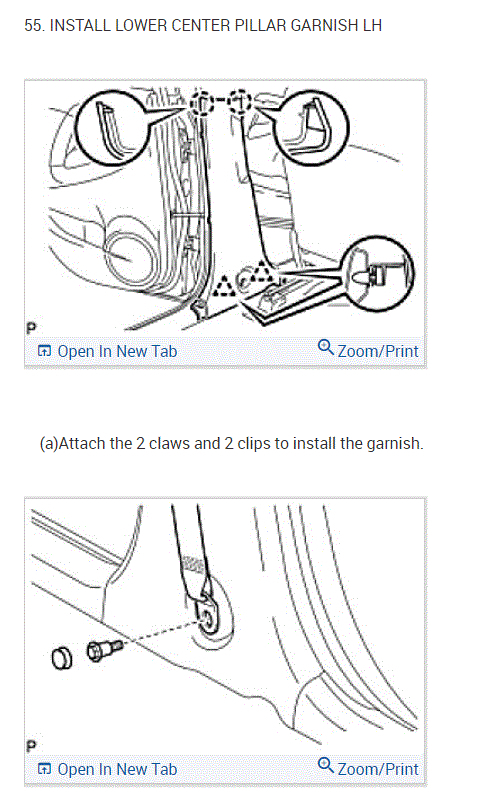

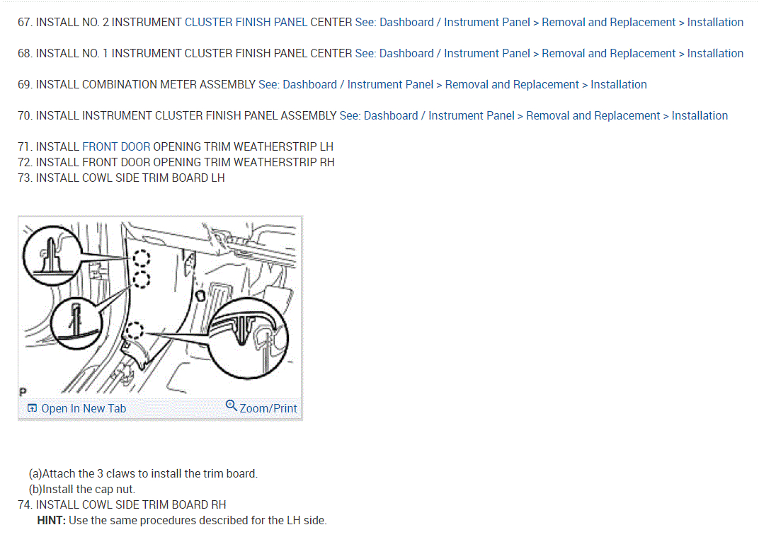

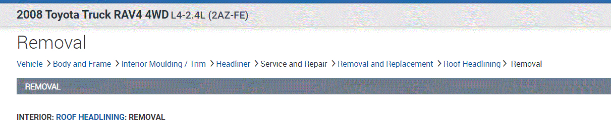

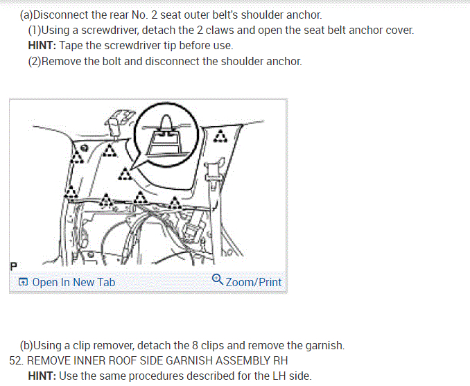

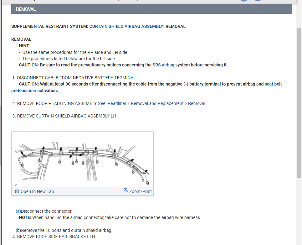

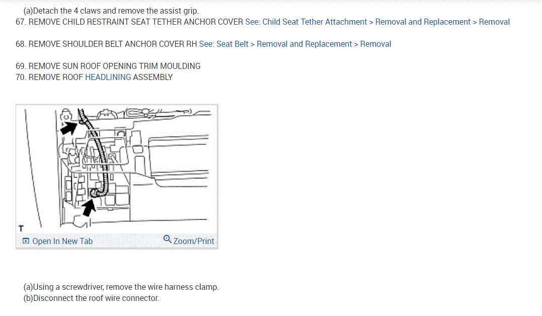

To replace the curtain airbags, you will need to first remove the headliner in the vehicle. Then it is a matter of simply removing and replacing the existing one. The headliner directions are very extensive, so take a look through them before starting.
If you get a used one, as long as it is from the same year, make, and model and has the same part number, you should be fine. The module shouldn't need to be replaced.
As far as the codes, it should reset itself once everything is replaced. If it doesn't, you should be able to reset the code with the proper scan tool.

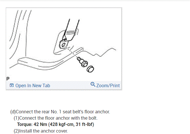

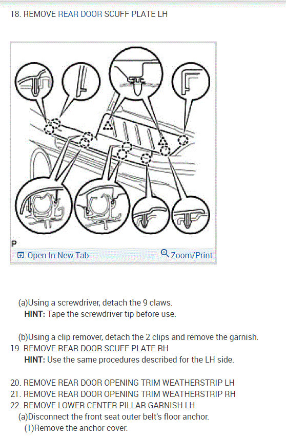

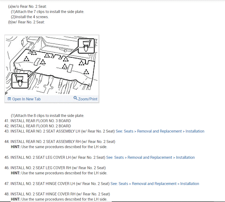

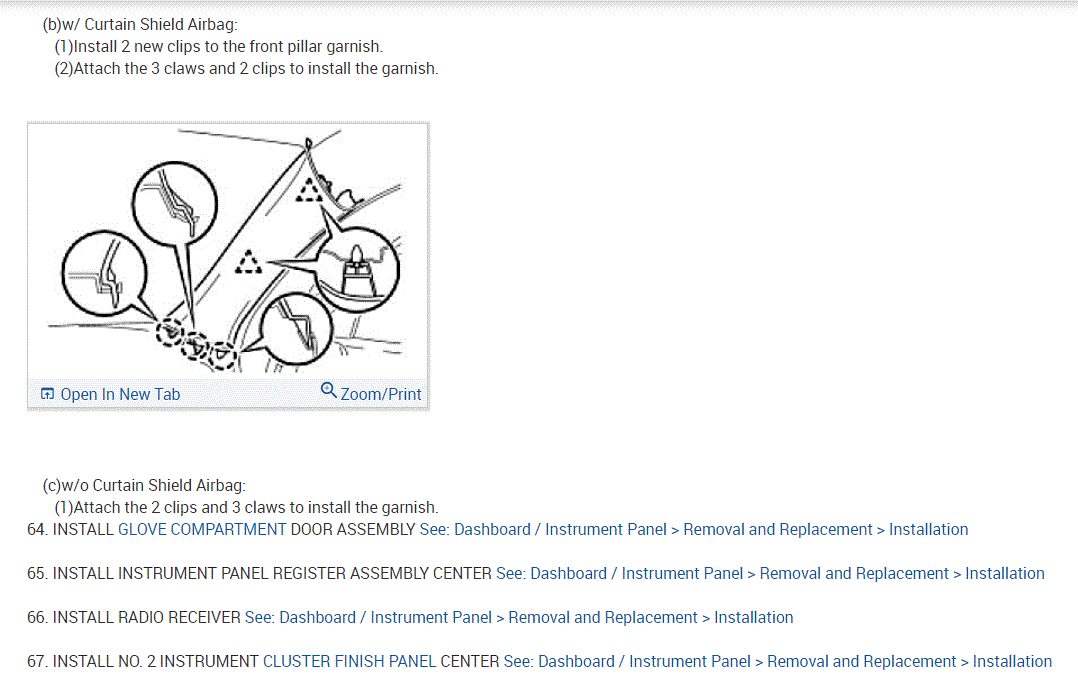

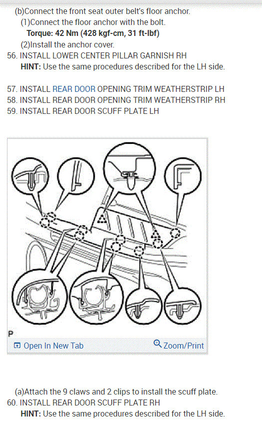

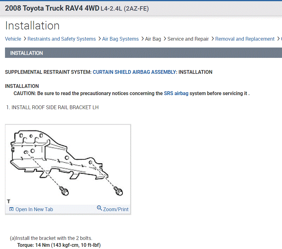

Below, I attached first the directions for the removal of the headliner. The second is the replacement of the curtain airbags, and the last is reinstalling the headliner. Based on the directions, it seems the entire inside of the vehicle needs to be removed. LOL
I know this will appear overwhelming but take your time. If you can find a shortcut that won't damage anything, do it.
See pics below.
Jul 2, 2021 at 8:05 PM
