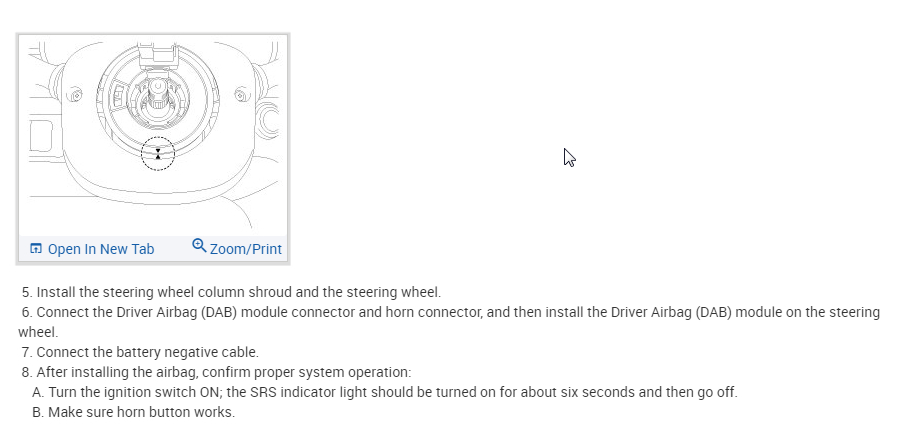

Replaced clock spring after dealer tried to hit me up with a hefty bill to replace. Airbag light was on. Also heard what sounded like something fell off in steering wheel rumbling around. Steering wheel volume was quirky at times.
Replaced clock spring successfully. Disconnected battery during.
Airbag light still on. It went off briefly then back on. Do I need to reset with code tool or is this possibly just cycling through 50 miles plus.
