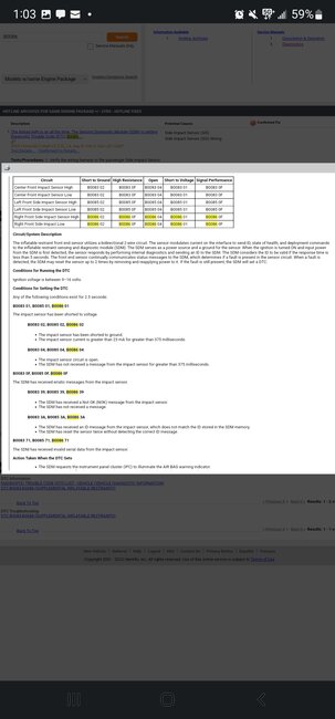

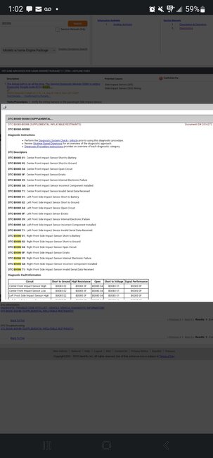

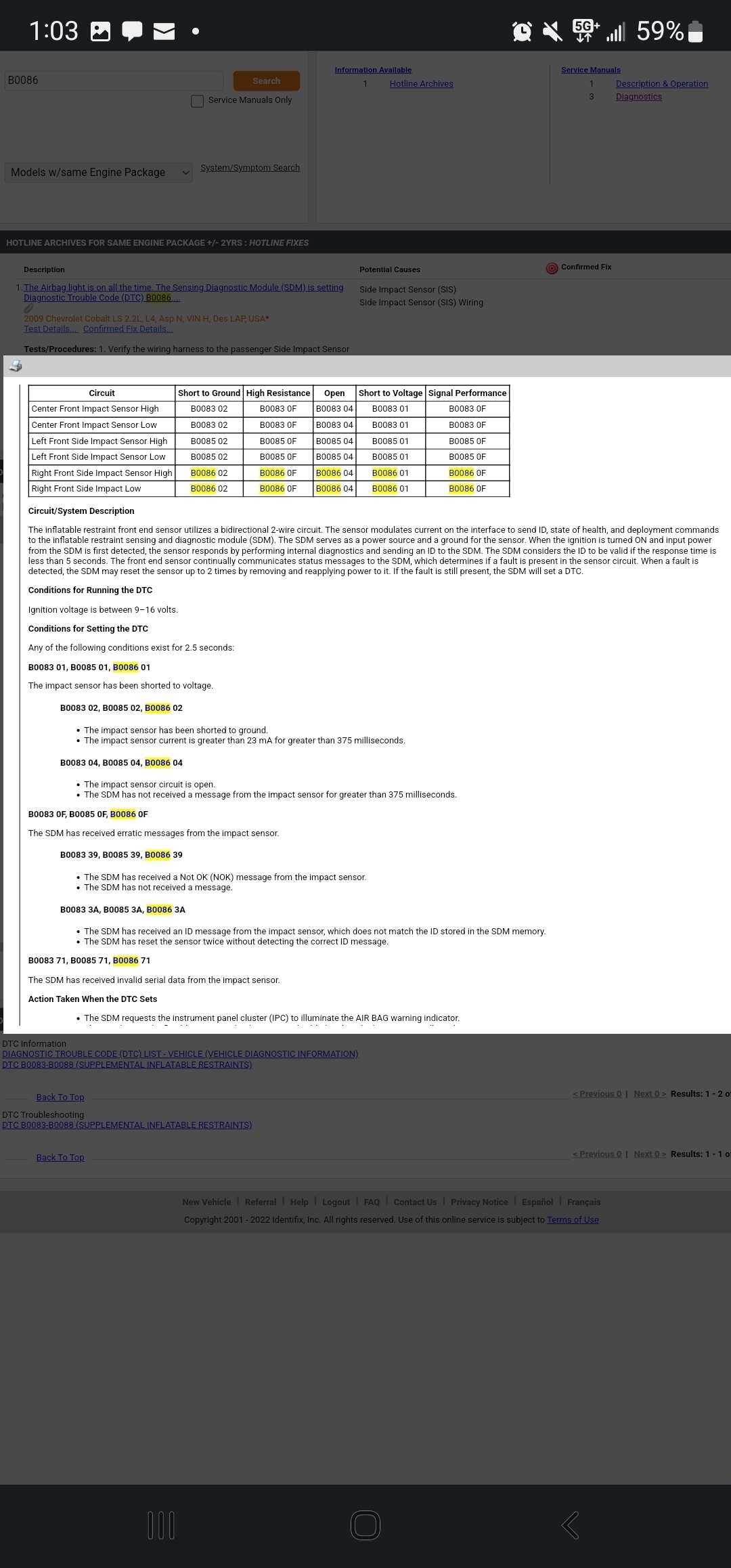

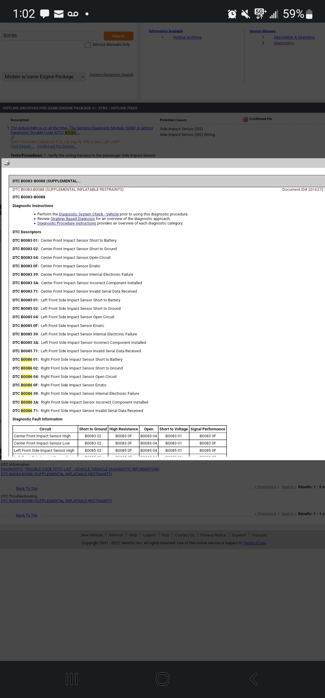

B0085_71 and b0086_71 I posted a pic of the codes, but I don’t see it on here. so here they are.

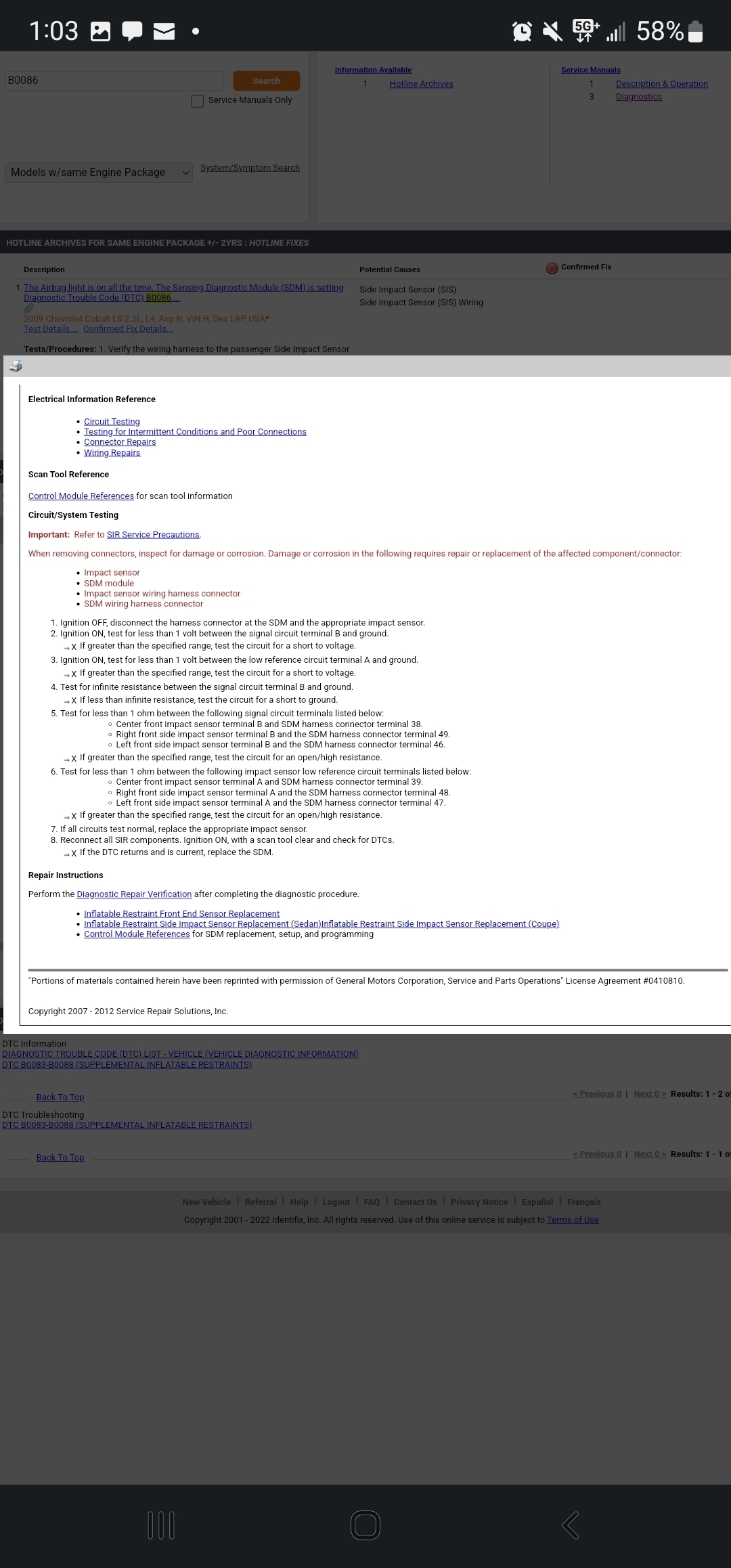

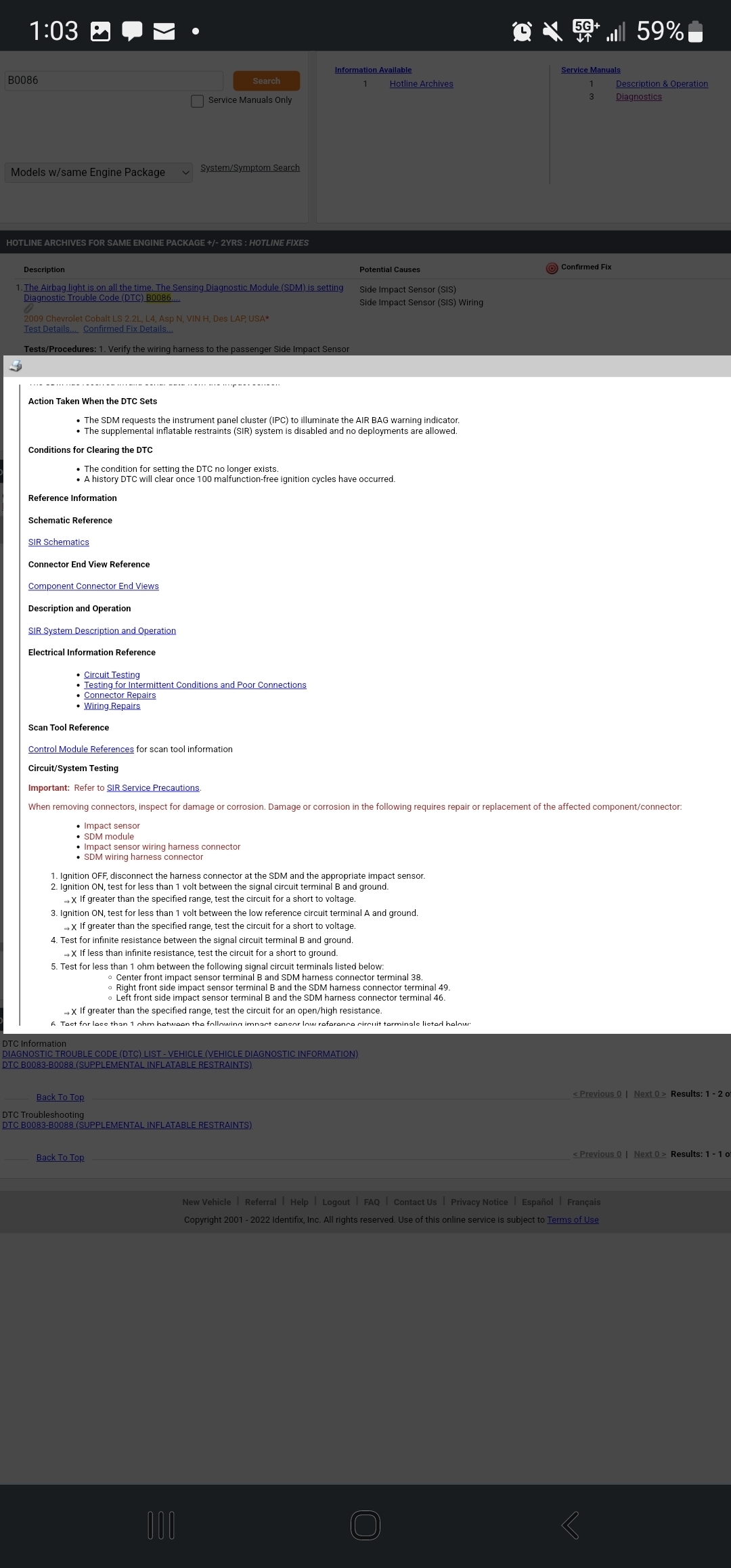

I posted the trouble tree for you but have you actually taken the inside door panel off and made sure those sensors are plugged in and wires/connectors are good to them? Thoses codes aren't for a programming error it's just saying the computer isn't seeing what it's supposed to see with the sensors plugged in.
Nov 29, 2022 at 1:12 PM

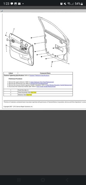

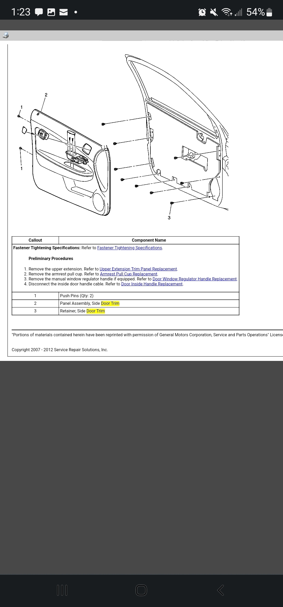

Here are the instructions for inner door panel removal.
Nov 29, 2022 at 1:24 PM

The sensors aren't like that the computer just expects to see a set value feedback from the sensor.I would say most likely the sensor isn't plugged in the wires are damaged or maybe it's the wrong sensor and or not plugged in.
